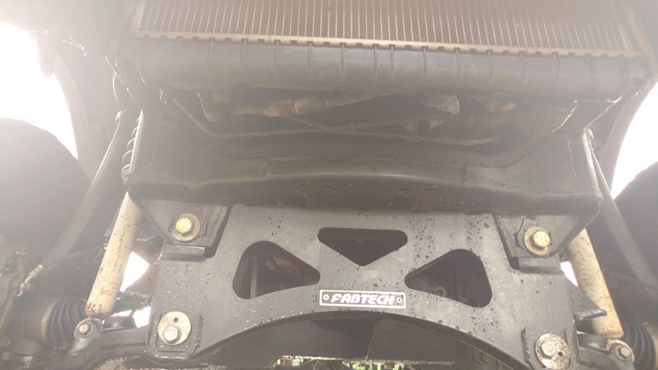

    Also a thought, he had to cut his cross-member to put in that lift, trashing it would imply straight axle conversion no?

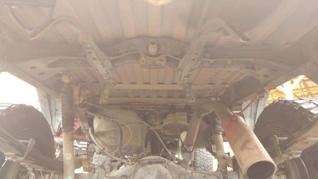

    Yeah it would be pretty difficult to revert back to the stock setup, that drop bracket replaced the stock crossmember. Bilsteins are known to ride pretty stiff, perhaps a different shock setup would give you a better ride. Those leaf packs look pretty beefy too, if you don't have any weight in the back of the truck I bet that would make it feel pretty stiff. You could try removing one leaf out of each pack and see how it feels.

    I'd been in some tacoma with drop bracket lift from FT to RC, some ride smooth while other ride like cr@p. How sure are you that setup have only 8k miles? From the look of your picture, the drop bracket and front lower shock seemed to have more mileage then what you're told. Maybe your shock are worn out, that's probably why your ride is rough.

    OP, if you like the look, ignore the haters. However, there are a lot more than 8k miles on those front shocks. I would start with getting some full length coilovers, keep
    The drop bracket and see how it works out from there. ($$$$$$).
    People don’t understand that a drop bracket lift alone doesn’t make it ride bad, it’s the shocks. So going to a 3” lift on stock components, will ruin the near stock geometry your lift has now and could have the same crappy ride depending on the direction you went. Start with the shocks, because it has pretty much nothing to do with the fact it’s a drop bracket lift.

    With all the spacers, brackets, extensions, etc... bracket lifts most certainly do effect the ride because they do a pretty good job of effing up the geometry of the entire suspension and drivetrain. Throw Kings on there and it will still ride like shit.

    See, this is some serious misinformation right here. Drop brackets maintain factory geometry....
