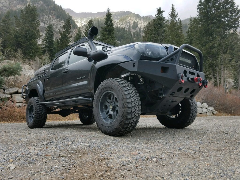

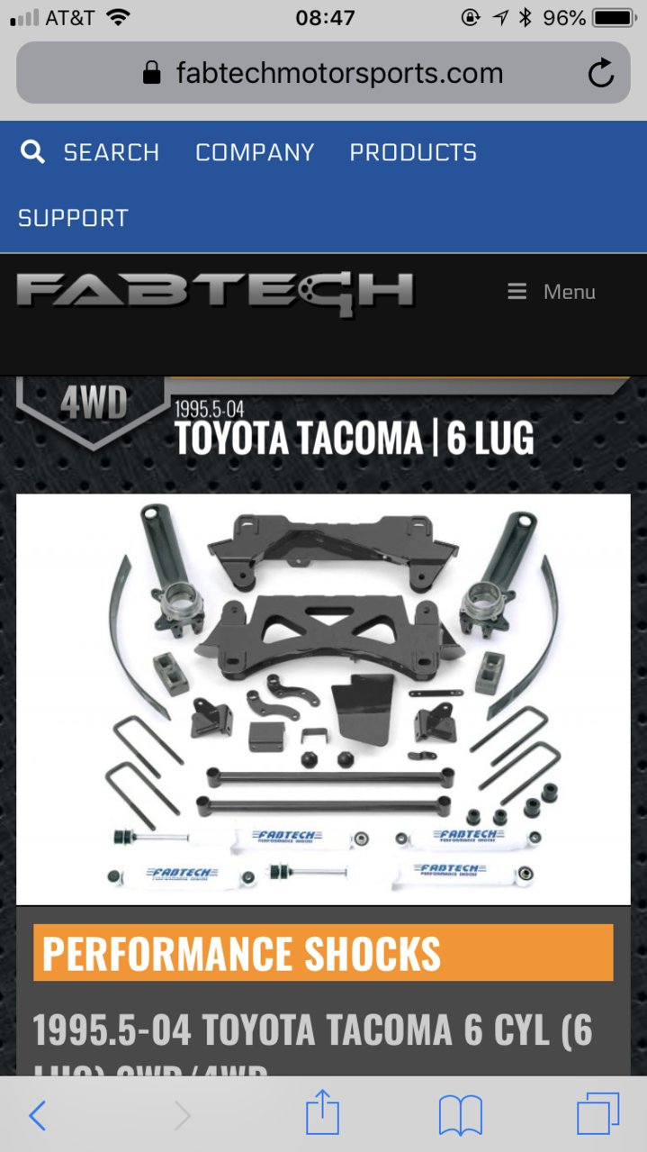

    Im pretty sure the fabtech kit comes with ext shocks so that it works with the oem coils and should keep the cv angles like oem. Your CV angles are bad, and the fact you have bilstiens and not the fabtech shocks that ce with the kit says that the old owner wss doing something he should have maybe, or he found ext shocks. But the fact that he said 8” lift might himt he was stacking lifts to achieve more.
    Op can you get better pics of the front suspension, preferably with the tire off?
    In the rear it looks like you have some kind of after market pack because fabtech gets their lift from blocks and a AAL

    they are usually accompanied with a new spindle as well. Fabtech is not a low quality company by any means, and I dont see any ball joint spacers in this application.

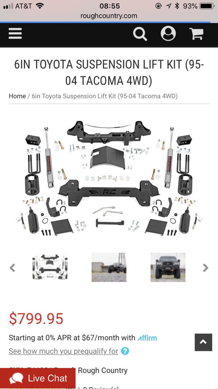

    Oh yeah forgot to add this in my other post
    Vs

    I didn't say Fabtech had spacers, only the ones that do have BJ spacers also claim to be "high performance." In other words, you can't always trust what the manufacturer tells you when they're trying to sell you something.
    But even those new longer spindles put a LOT of stress on the suspension in completely different orientations than what the factory was designed for.
    Fabtech probably is one of the better kits out there, if you absolutely have to get a 6" lift. But IMO, that's not saying much. For that cost, however, you might as well go long travel and get something you can actually beat on. But very few people get bracket lifts for the performance, anyway...

    First off, there is no "throwing that lift in the trash". The front crossmember has already been cut for the lift... short of a full up SAS or welding on an OEM crossmember, you are stuck with the lift that is on it. MAYBE you could get a 4" pro comp lift (not sure if they still make em) to replace the 6" fabtech lift, but no telling if it'll bolt up... I would venture to say, no.
    The whole point of a drop bracket is just that, it's a DROP... BRACKET. It DROPS your suspension, LCAs, diff, CVs, etc, so that you can stuff larger tires in there. Does it affect your suspension geometry? Yes and no. Your diff and CV angles will be at "stock", you will retain "stock" suspension travel, so you don't have to deal with additional diff drops and blown CV boots that come with standard 3" lifts. But your driveshafts will be at different angles and your upper control arms will be spaced further from your lower control arms.
    Is a drop bracket all that bad? It depends... you may need a coilover lift to gain you extra clearance of your suspension from rocks n stuff. But you won't be able to to stuff giant tires under there with "stock geometry" (generally speaking) like you could with a drop bracket. Some will say your center of gravity gets all wonky... again it depends on the wheeling you do. If you hate dealing with wonky IFS geometry of a simple coilover lift (which btw makes you lose downtravel) then drop bracket lifts aren't all that bad, plus you retain the factory up/downtravel.
    OP, the best you could really do is as suggested previously... either get full length coilover setup (this will remove the spacer between your upper control arm and your factory coilovers, it may also be a custom application so $$$) or just simply try to replace the worn out stock coilovers with new ones. The second choice will obviously be cheaper but there is no telling whether or not it will ride any better. If you go the first route, I would contact either Fabtech directly and see if they already have a solution created, or perhaps someone who can make you a custom set of Bilstein/Fox/King/Etc coilovers. You likely will need to provide them with measurements and weight of the vehicle if you have some custom made. Be prepared to spend a lot of money.
    Now if it rides like crap in the rear of the truck, you can do as others suggested and try removing the bottom or second from the bottom leaf from each leaf pack. This will reduce payload capacity but your ride will be improved (again how much... there's no telling).
    Generally if you aren't experiencing a "wavy" sensation when going over bumps then your shocks should be okay. If you hit a bump and your truck goes up and down, up and down, a few times then your shocks are toast. They should extend/retract and go right back to where the were after passing the bump. There should be no boat-like rocking sensation occurring. Now if your truck gets squirrely in that it sort of walks around going over washboards and stuff, then your shocks may simply be too stiff and you'll need to get some shocks that have a lower valving ratio.
    Good luck OP!

    Nice looking rig. You don't have to worry about blown CV boots and you retain stock IFS up/downtravel. I have always been on the fence about DB lifts; they have significant strengths that overcome their pitfalls. No sense in bashing something that is essentially an apples/oranges comparison!
    PS your light bar in the first pic is a tiddlybit off center :p
