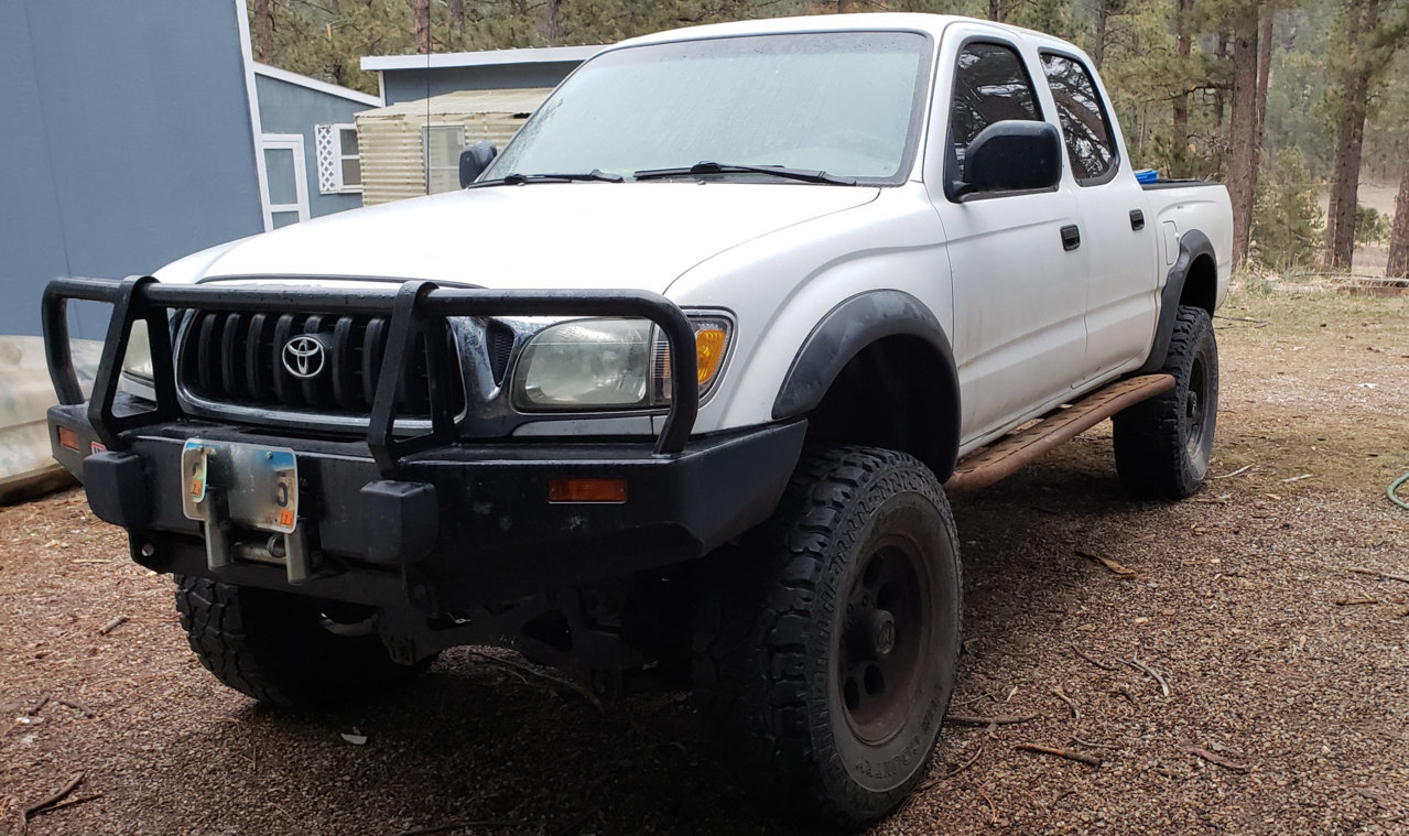

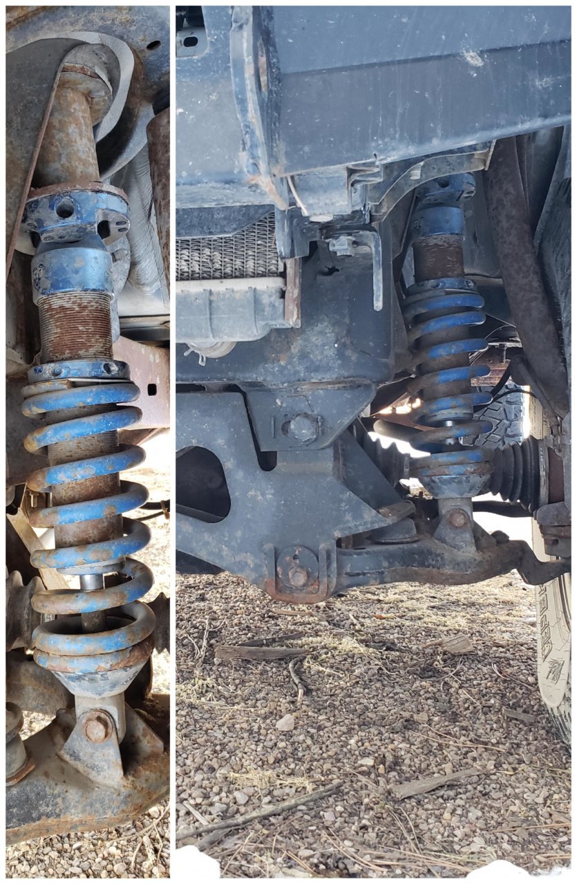

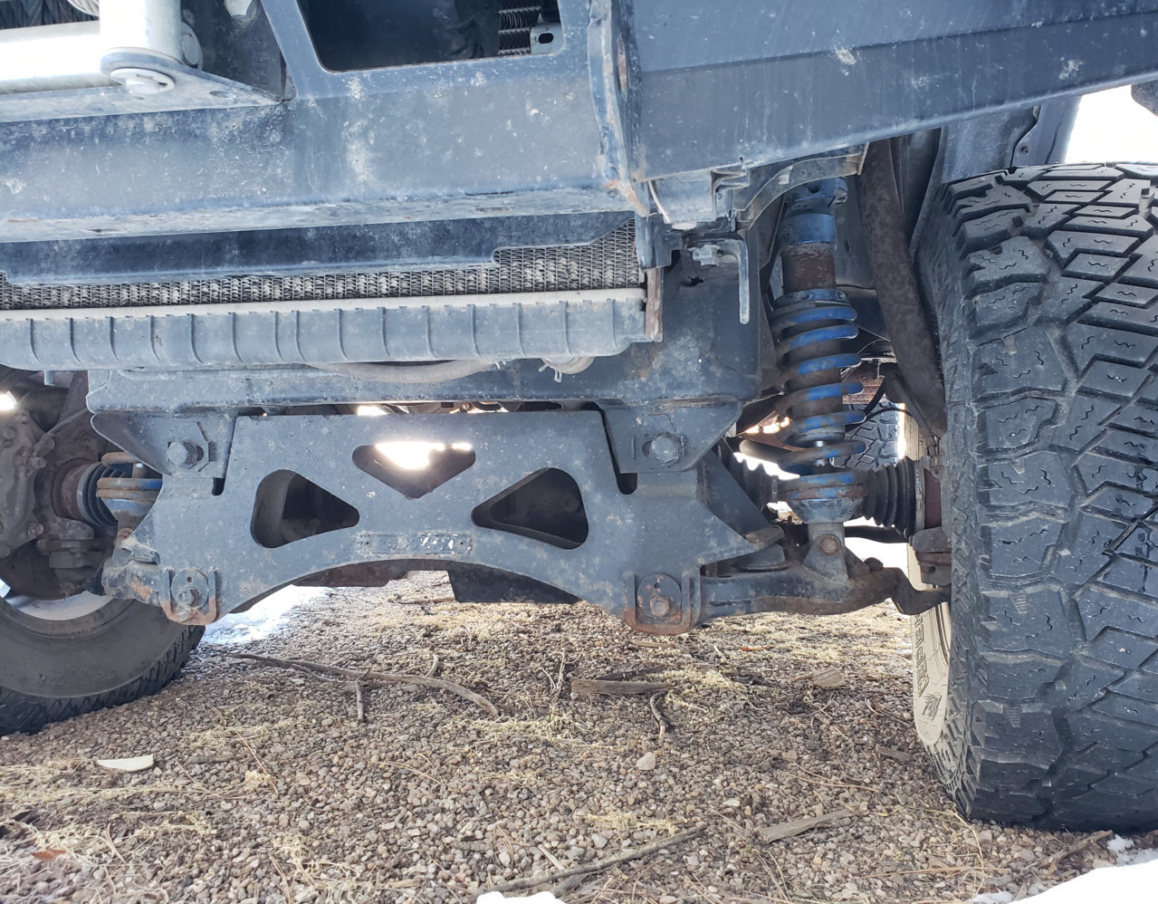

    Here are pictures of my truck.
    The current lift, and suspension was this way when I purchased the truck a few years back.
    It rides like absolute crap on rough, gravel. Especially washboard. I have to slow way down. It feels excellent on highway but that's not the purpose of this truck, at all.
    I cant afford to tear the lift out and replace. I am hoping I can replace shock setup for the front and maybe redo leafs in rear and improve the off-road ride.
    Thoughts?PSX_20190311_132627.jpg PSX_20190311_133703.jpg PSX_20190311_132648.jpg

    Id remove the drop bracket lift/spacers. and get new coilovers. keep the lift around 2.5"

    Are those King coilovers?
    If they are, I'd get those rebuilt if possible. Those are pretty nice shocks, or at least they were before the rust got to them...
    If they're too rusty to be rebuilt, you can very likely just replace them with some lower end coilovers. You could piece together a set of 5100s, but you'll need the top hat piece and a few other odds and ends as well.
    Yes, 5100s are a very definite step down from Kings, but if the Kings are shot and can't be rebuilt, anything is better than that, lol...
