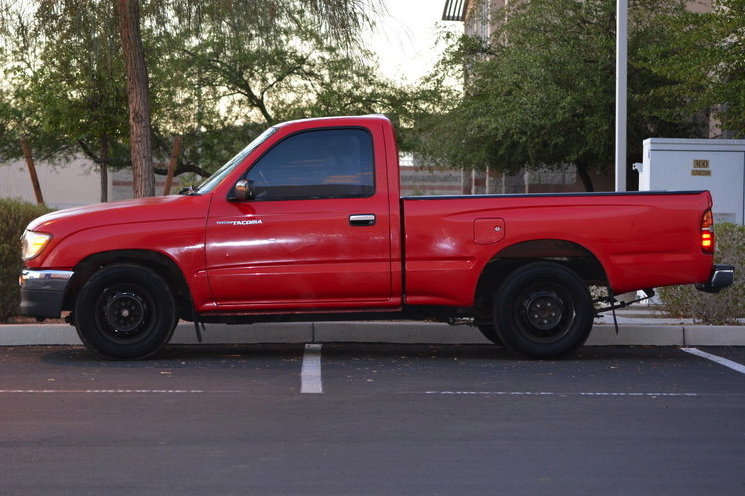

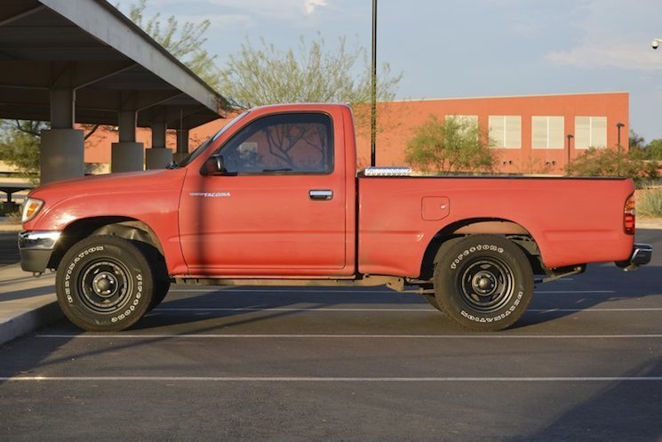

    I got you man. 1st pic is a bone stock 97 on 195/75r14s, 2nd has the doetsch spindles with 225/70r15s.

    You’ll notice the difference especially when you first get in the driver seat. But compared to everything else spindles are going to give you the most bang for your buck.
    Rims are U.S. Wheel - 15x7 - 3.75" BS. These are the only other pics I have from when it had spindles only.

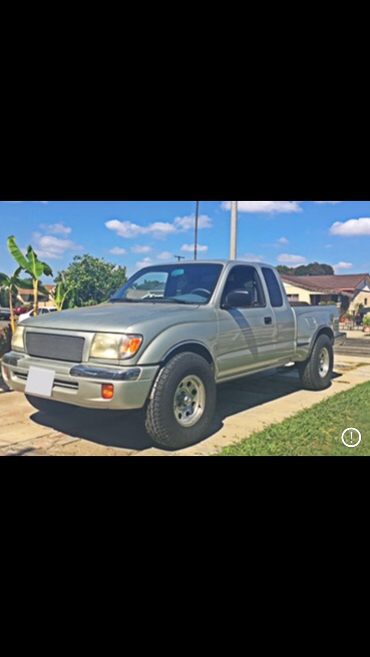

    Here’s a picture of my 2000 Tacoma 5 Lug with the 3inch Fabtech Lift, Some Advice I wish I would of known before getting it is to make sure it’s 100% what u want, After I got it I saw the Long Travel Kit that Total Chaos has for the 1st gen 5 Lug and wish I would of looked at some other options, Not that many when it comes to 5 Lugs like ours, Right now I’m in search of a Coil Over Kit for the Front!
