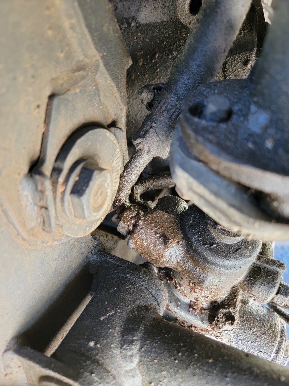

    I have a 98 taco with a 6 inch fabtech lift, and the power steering return line fitting that goes into the rack is leaking and I need to replace it. Can anyone help me find it? It's at a 90⁰ angle unlined the stock one.

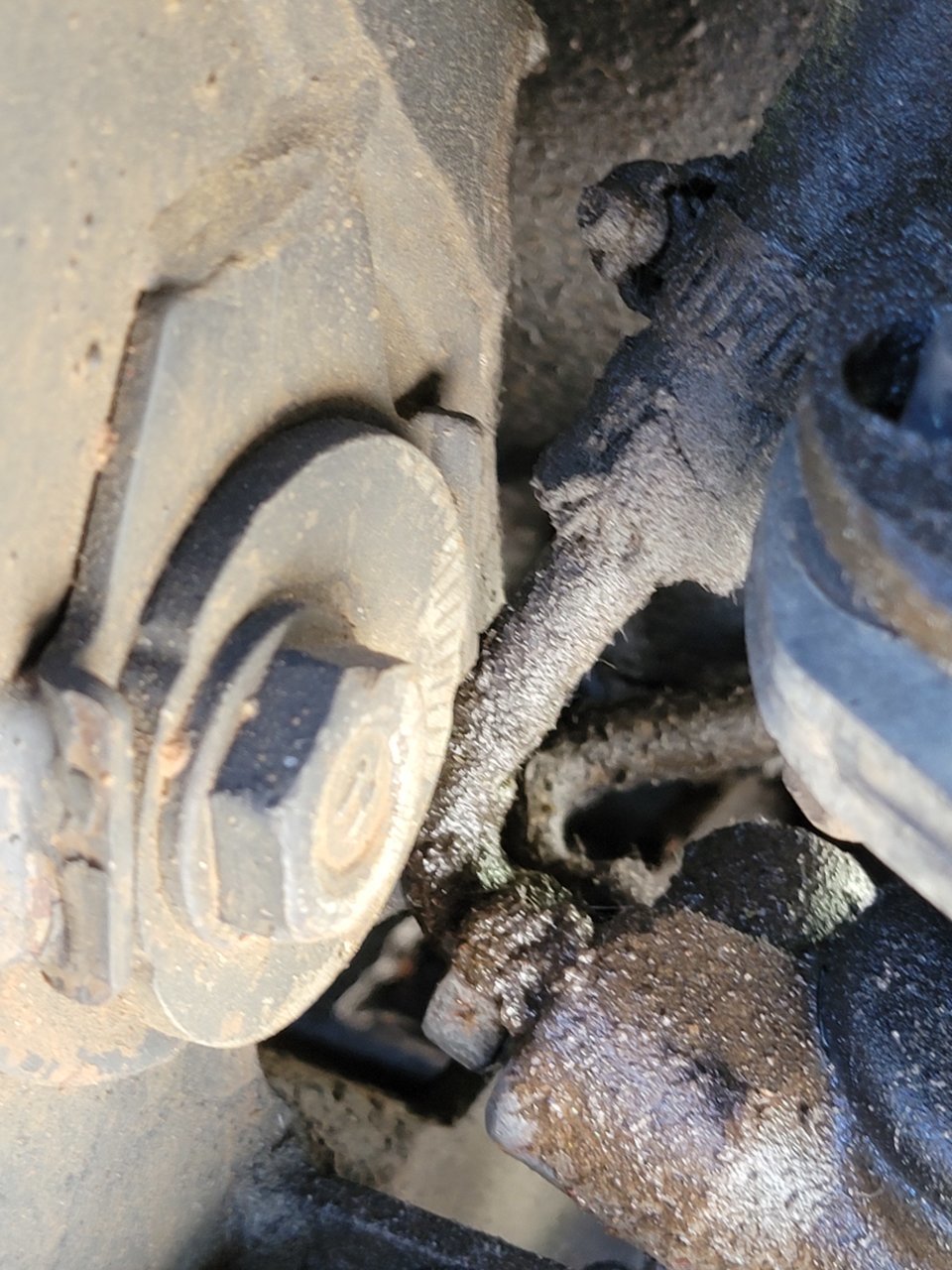

  5. Jul 6, 2021 at 11:20 AM
    Jc.lepape
    Jc.lepape [OP] Well-Known Member
    Jun 17, 2020
    #331767
    49
    jacob
    1998 toyota tacoma
    20210706_111633.jpg 20210706_111633.jpg 20210706_111628.jpg 20210706_111633.jpg 20210706_111628.jpg 20210706_111633.jpg 20210706_111628.jpg
  6. Jul 6, 2021 at 11:21 AM
    Jc.lepape
    Jun 17, 2020
    #331767
    49
    jacob
    1998 toyota tacoma
    Idk why it posted so many of the pictures but that's the fitting

    Have you try tightening the fitting? What about buying a straight and bending the 90 degree yourself? The return line looks too short imo and the clamp isn't really clamp to the tube but on the hose itself? It look like the clamp is in front of the barbed?

    I know the leak is coming from the fitting and not the hose although it wouldn't be a bad idea to replace that hose, it is pretty crusty. And I wouldn't be able to bend it myself at such a tight angle without it collapsing it.

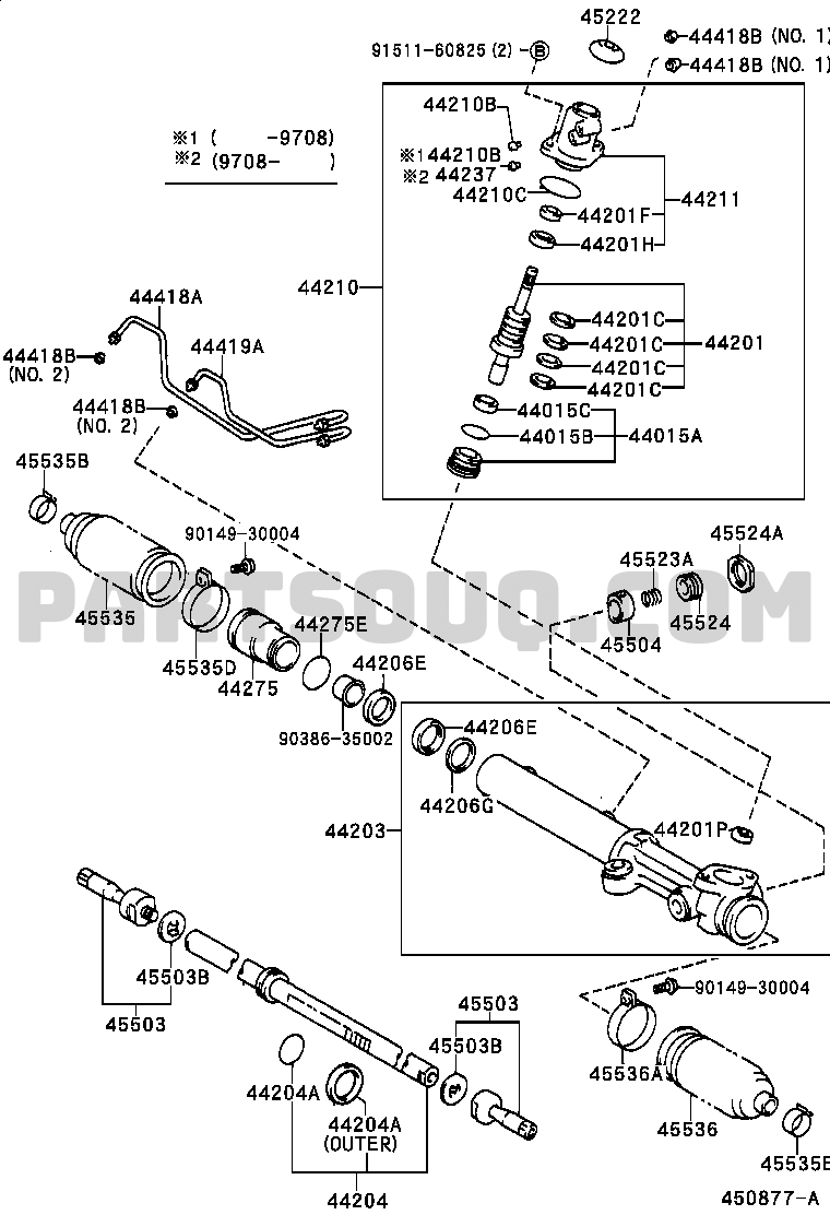

    My rack has corroded right turn and left turn pressure tubes that are leaking they are 44418A and 44419A in this drawing, the dealer says they are N/A obsolete so I thought I would bend and flare my own If I could find the fittings. I've done my own brake/fuel lines so It shouldn't be too tough if I can find the fittings.Anyone know?

    I figured they couldn't be that weird so I cut the line/tube and got a fitting off.
    They are just regular old 45° double flares with a 12 mm inverted flare nut, thread is 1.00
    The only thing out of the ordinary is a brass insert to mate with the flared tubing,
    Toyota calls these a 'seat,union' and the PN is 9041004002. Looks like I could reuse these but nothing else.
    Edited to add; It appears the lines and fitting used were unique to the 1995 Tacoma.
    In 96 they went to different fittings.
    For any '95 owners that need to make their own left/right turn tubes the fittings can be bought from FMSI the P/N is 3496-P. The tubing is 1/4".
    I got mine from NAPA.
    The new lines are back on and those old brass fittings I re-used don't leak.
