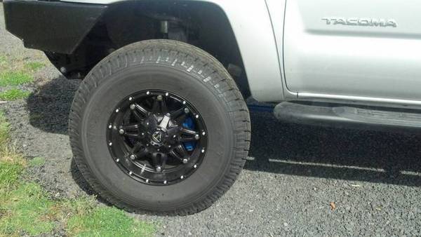

    [​IMG] I still had to do the cab mount chop and still have some rubbing when wheeling out in the woods. the size i run is 285/70/17" wheel is Fuel Hostages expect to cut more if you run 35" tires, also less side wall on the 20" rim and at least $120.00 more per tire for 18" and 20" tires depending on manufacture. good luck

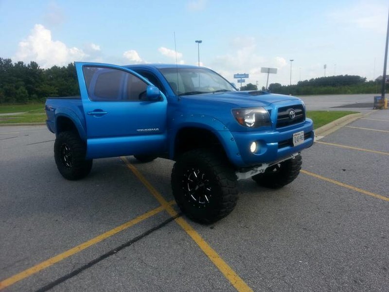

    What about the Ford behind you :eek:? How does one get in and out of that??

    Backspacing or offset should be 4.50" for most 6" lifts

    Damn!! Gas stations love you! :D Did you install the BL yourself?

    Yeah to go from driving a scion xb which I could drive for a month with one tank to this beast which takes 70 a week.I didn't install any of the lift.I had a local off road place do it since I wanted it done properly.Rides like a Cadillac though

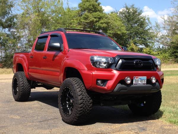

    :headbang::headbang:

    Wow... That's well done. I like the look of that truck a lot!

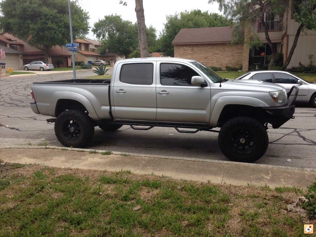

    ProComp lift Borla exhaust Borla air filter Nfab bars

    Looks good. What front bumper is that?
