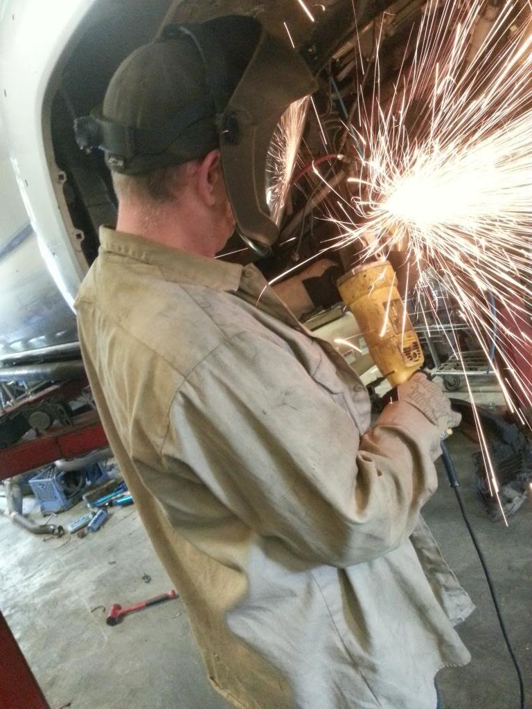

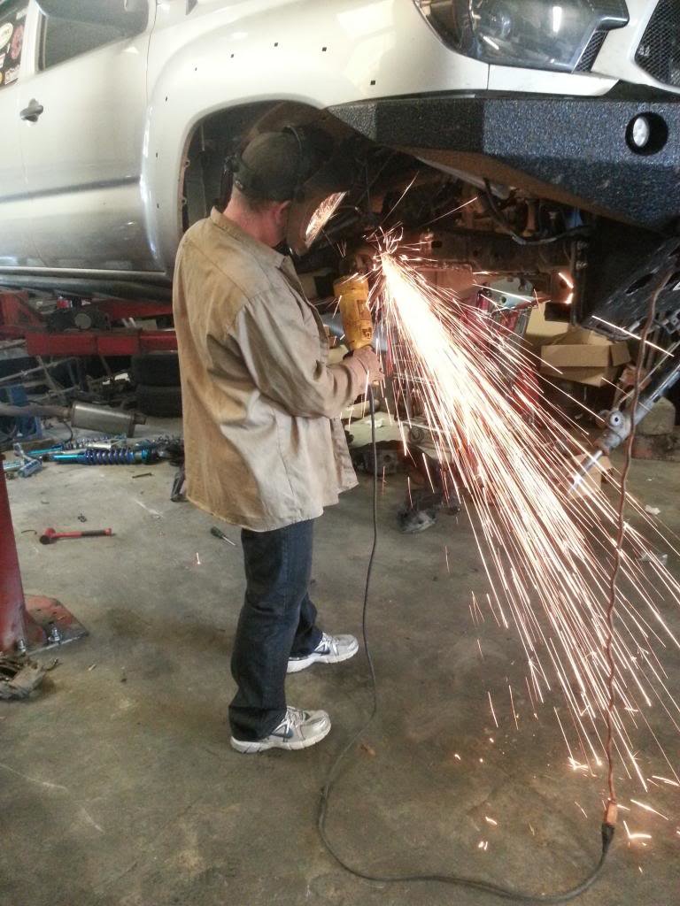

    #68587
    1,658
    mark
    TX
    85 extra cab on propane
    1985 ex cab, 92 toyota pickup, 95 4runner
    john with plasma in hand
    me "getting" to help grind, no fun!
