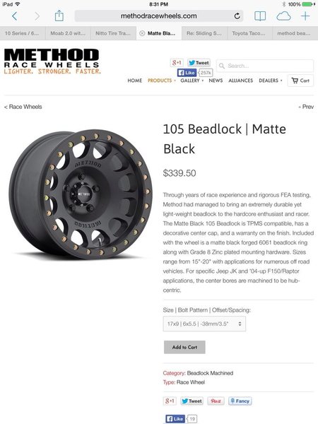

    Thinking about these wheels now, they are available in a 17x9 with a 3.5" back spacing which I like because it is a bit more room for articulation behind the tire and a 1" wider stance per side / 2" wider stance to offset the tall lift... It seems that you have to step up to a true headlock to get back spacing less than 4.5".

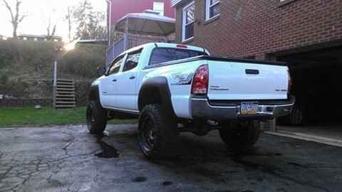

    trd off road
    6 inch pro comp
    All cleaned up!

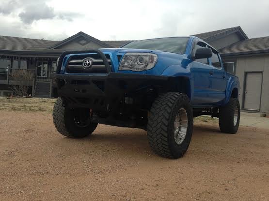

    TRD supercharger, 4.88 Nitro gears, Doug Thorley long tube headers, aFe stage II intake, Pro Comp 6" DB lift (Icon Coilovers, Alcan 6" Springs, Bilstein RCD rears), NST lightweight pulleys, Morimoto mini projector retrofit for Spyder headlights, Cobra CB, 4' Fire stick, Pioneer AVIC-U310BT head unit, 2 10" alpine S, CBI Moab 2.0 front bumper, Smittybilt XRC8 winch, NFAB tire carrier, custom Colorado pinstripes
    Had this for a while, but just discovered this thread.
    '08 DCSB
    most specs are in the little description on the left. Just got the CBI bumper on last week. Winch has since been installed, just havent taken a pic yet...
    After reading through this thread, I have decided on Alcan 6" springs and Icon coilovers for the front. What would be a good option for rear shocks? Will The Procomp ones work? I think they would be stretched out too far with the new leaf pack...
    Also, I'm afraid I would get the sag in the back that some members have seen from the Alcan packs. Any recommendations on specs to give to Alcan when ordering?
