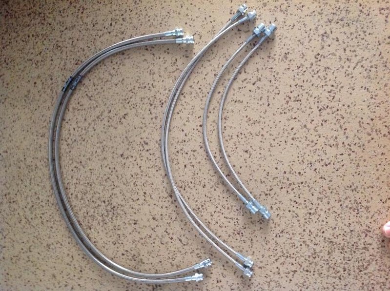

    I have some brand new unused extended lines for a 6"+ lifted taco or long travel taco for sale :
    1 pair front OE style ends 16" long regular stainless from group buy
    1 pair rear OE style ends 26" long regular stainless from group buy
    1 pair 36" OE style ends 36" long DOT stainless/Kevlar Crown performance ( this is the stuff race trucks use they are larger and have zero flex under pressure ) My current rear lines are 11ft long and my pedal is stiffer than it was stock.
    The front and rear set of regular ones are from the group buy guy here on TW and I will sell them to you for $50 + shipping
    The rear Kevlar ones for $50 + shipping
    A good trick to see what length is right for you is to use string cut to those lengths. Don't forget to measure the front at full droop with the wheel turned to lock and in the rear try to fully flex/droop too.

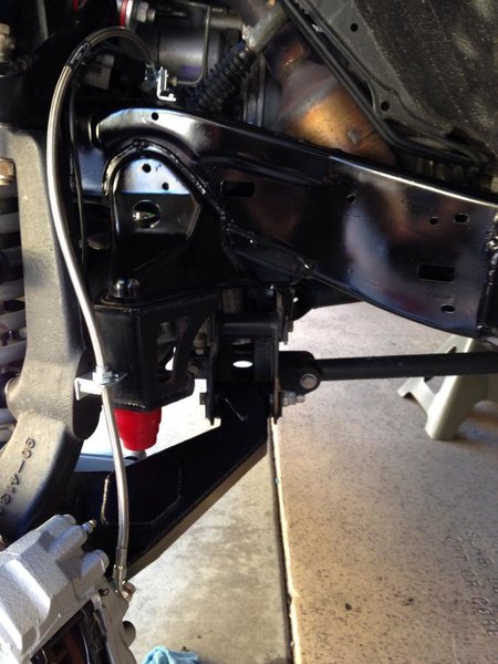

    If you want a pre made kit to eliminate every OE bracket, hose and line in the front contact Crown Performance, ask for John out in the shop and tell him you are looking to do the same thing as Jason with the silver Tacoma. He wrote down all of the spec's and brackets to do what is shown in the photo :
