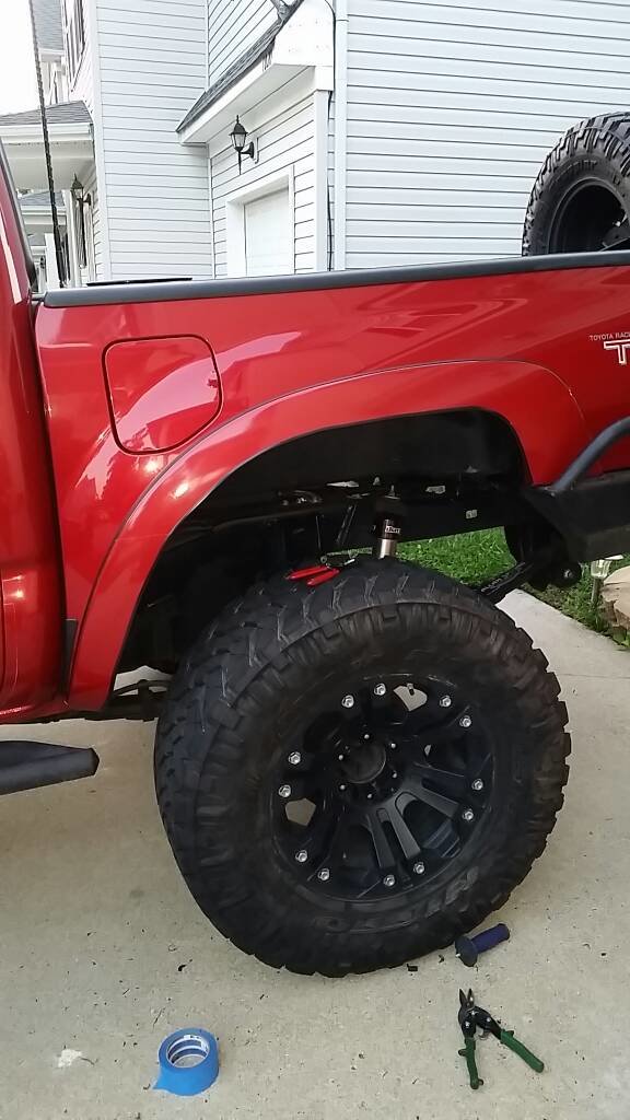

  20. Aug 5, 2014 at 5:19 PM
    #9460
    AaronArf
    AaronArf Well-Known Member
    Nov 12, 2011
    #66926
    4,218
    Aaron
    VA Beach
    2023 LR OR DCSB
    Decided to keep the DB.
    GONNA PUT 40s on er! Just finished cutting the rear.
    All jokes aside I'm leaving this pic here to show you guys 37s are easily do able with a db!
