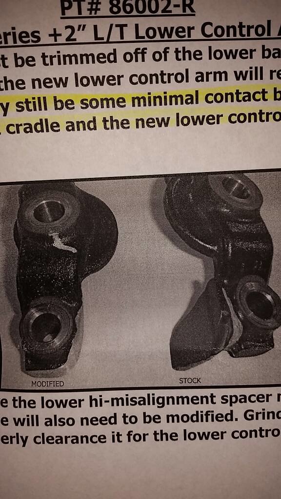

    No, you DB. :anonymous: she goes under the knife this weekend. Almost all prep is done. One more fender to cut. Need to cut my steering stops and then she's ready.

    why you taking the steering stops off?

    Have to cut them off for TC race series lowers or they'll eat the LCA

    You don't cut them all the way off, leave some bit there. I spoke with TC on this one to be sure.

    They include a picture with the kit, I'll post it up in here... do you have the stock length race lowers? Not much info anywhere on the web about the race series. I called TC to talk about wheel BS requirements for these LCA today-great knowledgeable guys! I've always heard good things, so far its true!

    I have the stock length race series lowers and I had to cut and shave down that stop. I did mine as far as I felt good about doing it. They still touch, but you can see that TC engineered them with an extra plate there. I did notice a little less turning radius cause of the width of these LCAs.
