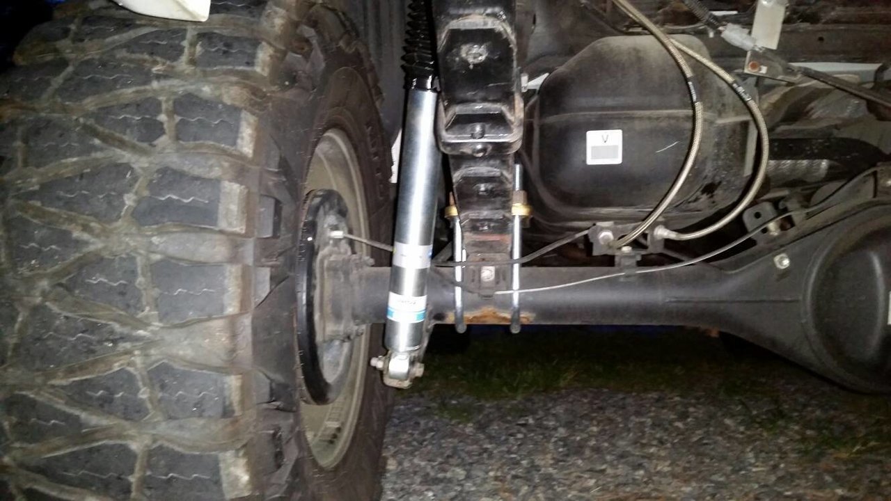

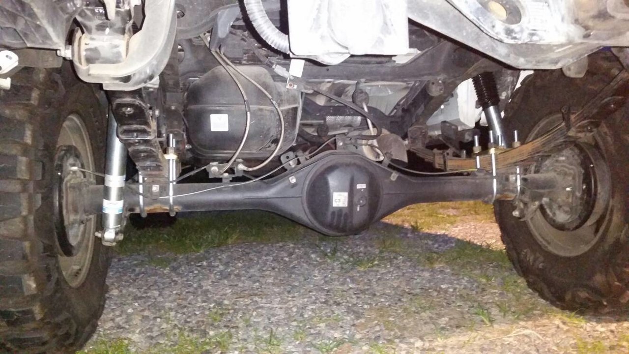

  10. Aug 22, 2014 at 5:36 PM
    #9590
    YotaMatt
    YotaMatt Livin Low, Ridin High
    Mar 8, 2012
    #74448
    5,185
    West Point VA
    12 PreRunner DC TRD Sport
    Spidertraxx 1.25" spacers in front and rear, 4" Maxtrac Spindles,Billy 5100s at 0", OME 885 Springs, 1/4" top spacer on both sides, 1.5" AAL, 3" Block, 1.5" 4crawler driveshaft spacer, 17x9 XD Spys with 35x12.50 Nitto Mud Grapplers, Magnaflow offroad Stainless Exhaust, Volant Intake with scoop,Camo emblems, BHLM, Tinted tailights, Anytime fog mod,Alpine Type R 12, Kicker 1000 watt amp,600 watt 4 channel memphis and all memphis components, 35%tint front all the rest at 5%, Hella 500s with sylvania zxe bulbs, sylvania zxe headlights, sylvania zxe fogs, Weathertech digi fits, flyzeye blue/white, LED map dome license plate lights, Redline hood struts, Tailgate EZ Down, Custom TRD Camo Browning Edition Bedsides, Camo wet okoles, Ridgid Dually bed lights, SOS Concepts Tire Carrier
    Bilsteins :cool:b0f5627629363fe2b6e6c4e9fa4fe8c1_daee78aa9b861993ea4ea739c84575b0a27f8a93.jpgd66c26fbb7258b108ed68fcc9f4dff20_1873d731e9f597f4040f6629ca2c93a08a7c4bd9.jpg

  12. Aug 22, 2014 at 5:50 PM
    #9592
    YotaMatt
    Mar 8, 2012
    #74448
    5,185
    West Point VA
    I haven't driven it...but my pro comps are shot...I compressed by hand and they stayed....bilsteins are a bitch to compress

  14. Aug 23, 2014 at 7:14 AM
    #9594
    YotaMatt
    Mar 8, 2012
    #74448
    5,185
    West Point VA
    Nope that's how they go according to the diagram that comes with them

  16. Aug 23, 2014 at 8:00 AM
    #9596
    PLC721
    PLC721 Well-Known Member
    Dec 27, 2009
    #28268
    18,957
    Patrick
    Chandler, Az
    2017 Toyota Tundra Crewmax ProKiller
    Kings, Toyos, Baja Designs, TC, SDHQ
    Those Billies are installed correctly. Some fox shocks come that way as well
