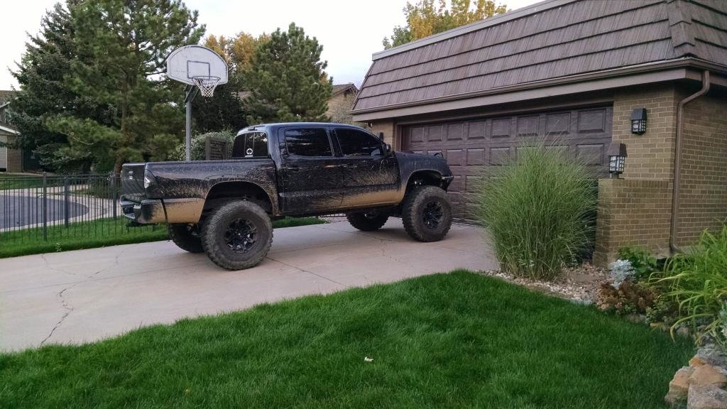

    Bump! hope everyone is still enjoying their rigs! :broccoli:

    Did you run into a puddle at bed bath & beyond? Truck is dirty and no tire shine :confused:

    Mine is still clean :laughing: Still enjoying all the fresh new parts!

    :brianr: tire shine!
    Leftover from 2 camping trips. Hope to was her today
