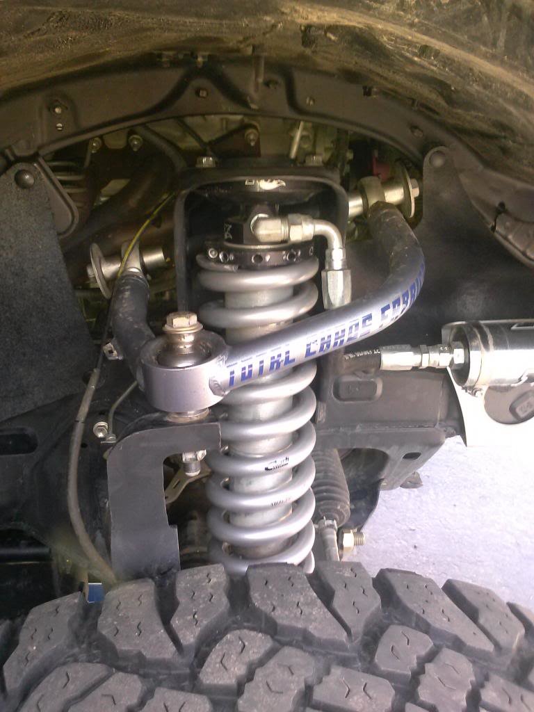

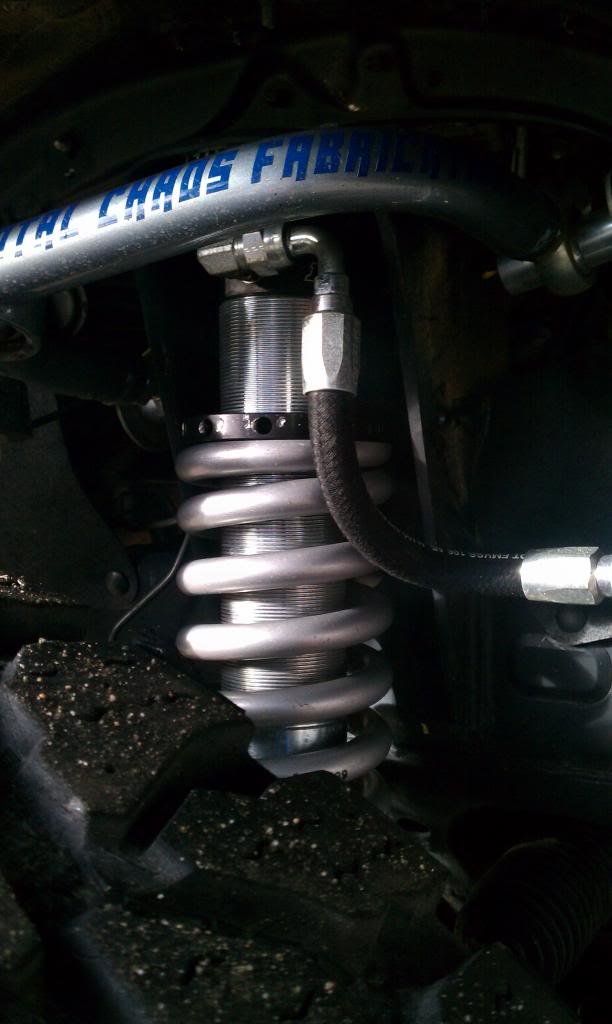

    Looks like what I used to have .
    Fox put 16" springs that came preloaded at least 2". That's y I swapped to a 18" heavier spring.
    The rear shocks are too long b/c I only have expos not Alcans ect..
    Old
    New new
    Still :jellydance: of evenflows kings

    Nice no preload.

    Not trying to argue but look at his LCA's they are flat = No preload, preload and exposed threads are not the same thing. If he had 2" of pre load his LCA angles would show it. Lots of shocks do not have a coil all the way to the top.

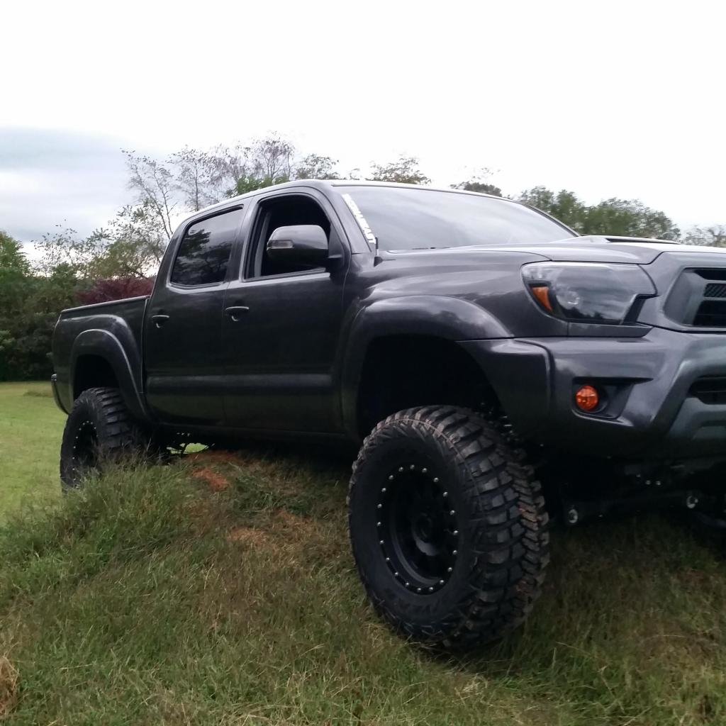

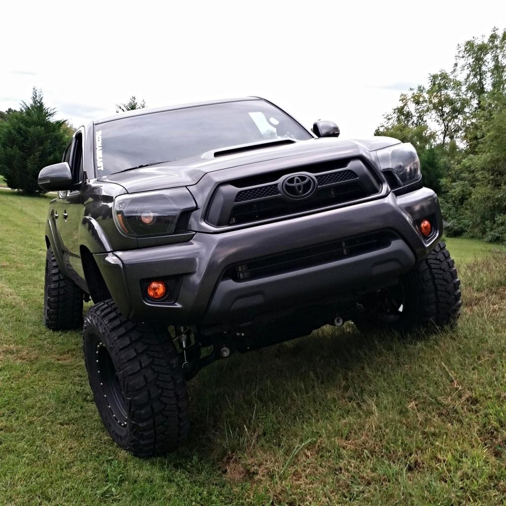

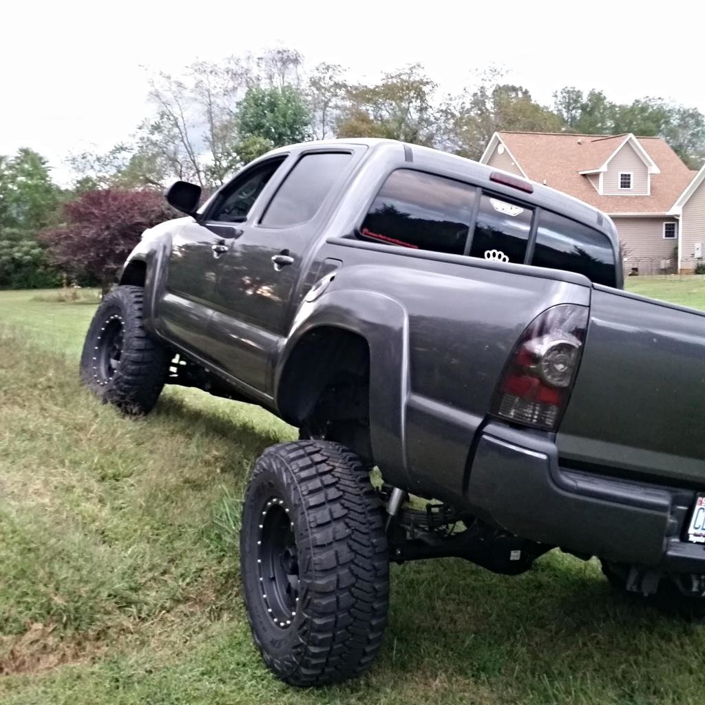

    No bed bath and beyond around here, so did some yard crawling to test everything out finally :D

    ^ That's what this thread is about!! Looks dope :thumbsup:

    Truck turned out awesome:thumbsup:

    Looks good! You need sliders!! Almost looks like you were about to high center on this last one!!

    Lots of thanks to you also! Shocks worked out great for me. Went with the toytec springs though and top hat spacers. Would like a little bit more arch for clearance but, the cv angles are perfect..Trade off I guess lol
    Hahaha yeah next on the list to do. Really just want sliders so I can use a high lift and the gf bitches about getting in the truck again :p I dont think i'll be rubbing on rocks..The clearance is insane from the rear and center of the truck. That mound was an landing when me and some buddies use to jump pit bikes :cool: So it all soft mountain clay lol No way in hell my 3'' lift would make it over! Then it would have high centered for sure!
