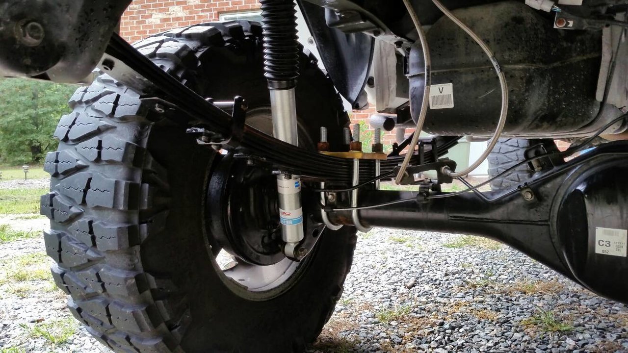

  17. Nov 3, 2014 at 5:20 AM
    #9957
    YotaMatt
    YotaMatt Livin Low, Ridin High
    Mar 8, 2012
    #74448
    5,185
    West Point VA
    12 PreRunner DC TRD Sport
    Spidertraxx 1.25" spacers in front and rear, 4" Maxtrac Spindles,Billy 5100s at 0", OME 885 Springs, 1/4" top spacer on both sides, 1.5" AAL, 3" Block, 1.5" 4crawler driveshaft spacer, 17x9 XD Spys with 35x12.50 Nitto Mud Grapplers, Magnaflow offroad Stainless Exhaust, Volant Intake with scoop,Camo emblems, BHLM, Tinted tailights, Anytime fog mod,Alpine Type R 12, Kicker 1000 watt amp,600 watt 4 channel memphis and all memphis components, 35%tint front all the rest at 5%, Hella 500s with sylvania zxe bulbs, sylvania zxe headlights, sylvania zxe fogs, Weathertech digi fits, flyzeye blue/white, LED map dome license plate lights, Redline hood struts, Tailgate EZ Down, Custom TRD Camo Browning Edition Bedsides, Camo wet okoles, Ridgid Dually bed lights, SOS Concepts Tire Carrier
    Alcans ftw!!!! 8e25db1edc56ad5f8a32395c26810868_5b947d94fbb5598969b82ea6b3ed22485abb9342.jpg

    Hey Matt,I know you picked up the Alcans from Aaron. Were those the 6" (8 leaf pack)? I am going with the BDS 6" coilover kit and I want to be sure I get the right leaf pack for the rear to get me level. Seems like the 4" would be the route for me to go since like I mentioned before that I currently sit 2 inches high in the back at stock. Just baffles me that most everyone I see with Alcans say they went with the 6" pack but then their trucks appear to sit level with that?
  19. Nov 3, 2014 at 9:25 AM
    #9959
    YotaMatt
    Mar 8, 2012
    #74448
    5,185
    West Point VA
    Mine is the 6" pack 8 leaf and center hub to bottom of fender flare measurement is 28"
