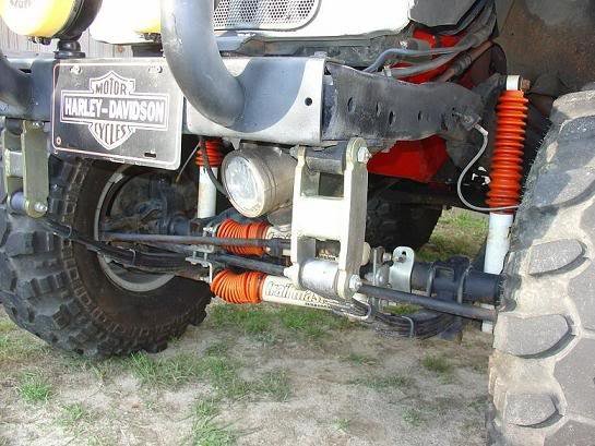

    With my lift, the only shocks I can find with the length I need are really expensive. I have the All Pro U-bolt flip kit with some custom Atlas springs. I was thinking of welding a shock mounting tab to the top of the U-bolt plate, and using the existing top shock mount so that the shock length is much shorter.
    Do you guys think that'd work okay? My truck is a mall crawler now, so I'm not concerned with travel numbers.

    I don't thing welding a tab to a U bolt plate would be structurally sound.

    It is not a bad idea and in fact there is a big benefit because you can cut the ridiculously low hanging OE shock mounts off of the axle and gain more ground clearance. Search Jeep u bolt plates on the web and you will find a ton of u bolt plates with shock mounts on them. A lot of trucks and Jeeps use that set up, see photo for an example.

    Yup, my 79 CJ had that set up ......
