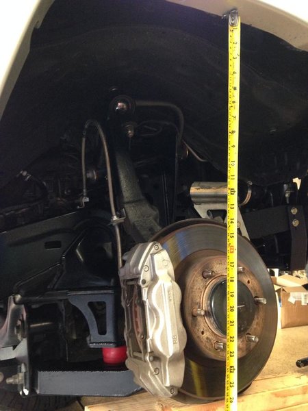

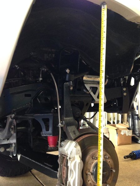

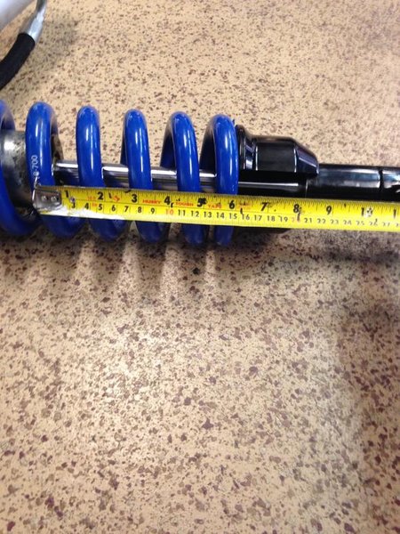

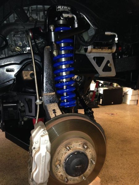

    I had my CO's off for a few days getting them re valved and 700lb 18" coils so I finally had a chance to cycle my suspension and take some photos. Looks like I am getting right at 10" with the bump in place. I made a mark on the center of my hub with a silver paint pen so there would be a mark that would show up in the photos and held the tape at the bottom of the fender flare. It cycled from 20" to 30" from the bottom of the flare. I included a pic of my CO showing the stroke length. I believe paying the extra bit for a custom CO is what gains you that extra 1 or 2" because most over the counter CO's for our trucks are a 5-6" stroke length however these are an 8" stroke.
