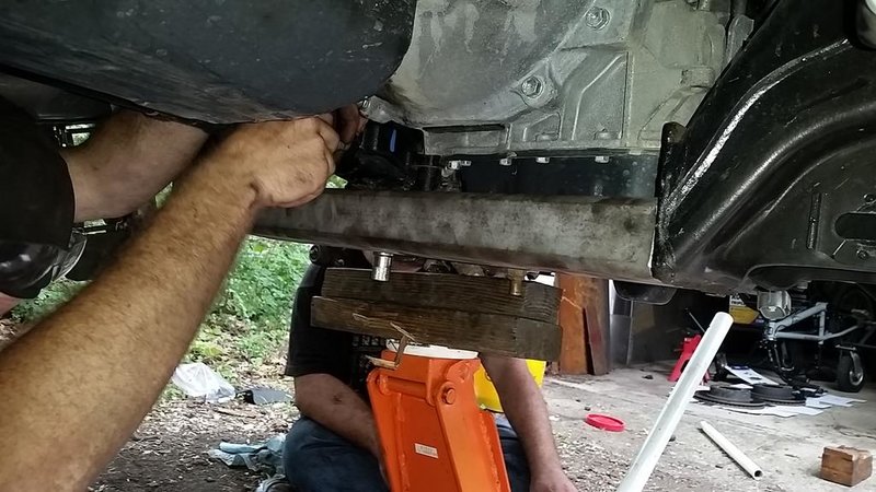

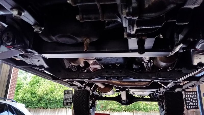

    Fabtech requires you to remove the entire crossmember....Pro comp/BDS/Rough Country have you cut a much smaller section for the drive shaft to move lower because the diff being dropped. Hence no need to cut Xmember for prerunners!
    Check out the attached pictures - its how we re-built my cross member. That is how much Fabtech has you cut out!!
    In case any one ever searches this is what you'll need to go back from a DB:
    Stock Spindles
    LBJ Brackets + 19mm Bolts x4 ( IF your truck has a Fabtech kit)
    Front Diff Mounts & Bolts X 2
    Rear Diff Mount
    Materials to build Cross-member or weld in stock
    I don't think I'm missing anything else.
