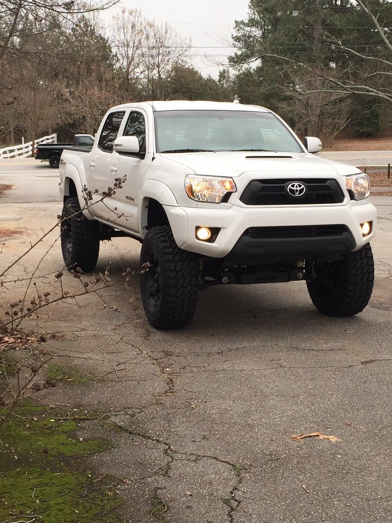

    6in Pro Comp Suspension 35/12.50 Pro Comp Extreme Mud 18 American Rock star 2's
  14. Mar 30, 2015 at 12:55 AM
    TRDkyle24
    TRDkyle24 Active Member
    Nov 24, 2013
    #117179
    32
    Kyle
    Las Vegas
    14 Silver DCSB 4x4
    TRD cat back exhaust, 6" Pro Comp DB lift, King Coilovers
    Looks clean man! 6" is the way to go! although I'm sure a select few of the guys on this thread would like to disagree haha its all preference, but as a daily driver and the occasional off roader 6" is perfect for me.
