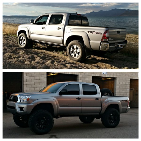

    Photo_2015-12-27_10-44-28_PM.jpg Just install a rough country 6 inch lift with 35 inch tires and the back is sitting much lower than the front!? Can anyone help me out with this problem, i want my truck to ait even. Thanks

    That lift should have 4in Blocks for the rear. Are you sure they sent you the right size?

    Super bro lean! Shouldnt it be blocks and an AAL?

    I installed a RC kit for my buddy and his had 4" blocks,combined with the weak ass oem 3 leafs his had the bro lean sag. But this is a newer truck,it should have the 4 leaf pack and shouldn't sag like that. In that picture he has his old wheels and tires in the bed which isn't helping either.

    Even when i take the tires out of the bed it still leans like that, what is AAL? I didnt change the leaf springs but it did come with 4 inch blocks. Any suggesttions on how to get it even?

    Aal is a add a leaf to your leaf spring. Maybe a 1 inch aal would help? The gurus will get you straightened out soon bro

    Add a leaf, it will add height up to 1.5" I believe.

    Yea a leaf pack is the obvious answer but considering he just put on a lift I doubt he wants to go and drop another 5-800 on a new leaf pack. He can do a different block or AAL much cheaper.
    Even though I stand against blocks, pretty sure this is a street truck for now.

    He can always add the 3 leaf icon or wheelers which would be a better option that running a single leaf. Of course a new leaf pack is what should be done.

    I'm just saying an AAL or bigger block is the cheap fix and can be done on the garage floor.

    Google it. You'll need new center pins but the AAL may come with them. Please post a picture of the leafs/your rear setup. I want to see what is going on.
