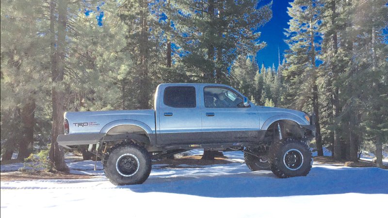

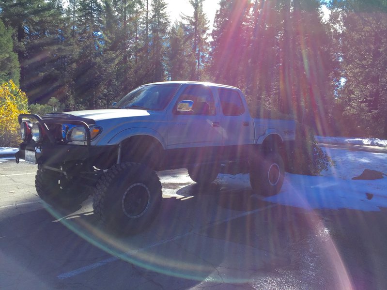

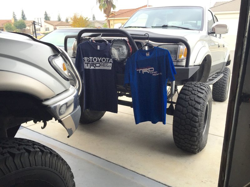

    image.jpg image.jpg image.jpgHere ya go!!!

    So awesome! You want to trade a stock 08 DCSB 4x4 for it? lol.

    Will trade for newer one this sas only has 97k+ miles original owner

    How so much ground clearance under the front diff!? I have s 6" and yours looks way bigger! At least she told me it was 6 inches...

    If I remember correctly, the guy you're talking to had 9" of lift. A drop bracket kit with a 3" leveling kit.

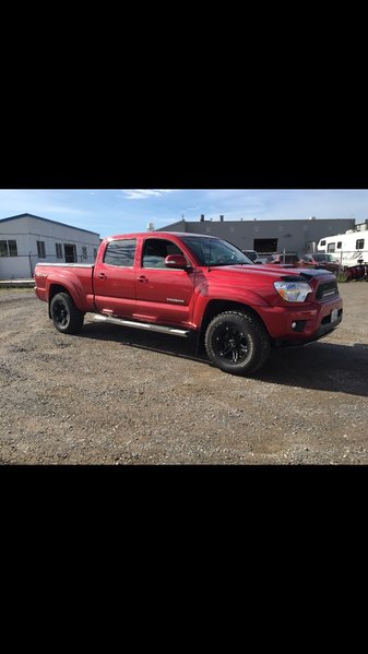

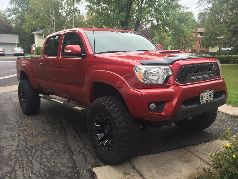

    Before and after (from this summer) mine looks more like a 4.5... Anyone agree, starting to question this

    Look at those cv's. / \ :eek:

    Is it any worse than a guy with a regular full 3" lift? :notsure:

    Good point...I guess not but the big problem with that and stock shocks is that you are riding topped out with about 1" of droop travel...probably makes a neat clunk sound when it rebounds off of speed bumps etc

    Rear - Measure your rear blocks. The 4" BDS comes with 3" blocks and the 6" comes with 4" blocks.
    Front - the 4" uses a only a top strut spacer. The 6" uses a preload spacer and a top strut spacer... IF you didn't get the 6" coilover kit...
    http://bds-suspension.com/product?ma=12&mo=45&ty=1&yr=2005-2015
    Edit: that's the only differences I see personally, @Blacktacoma23 may be able to tell you more.
