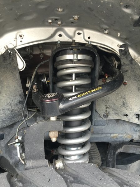

    Here is what my front end looks like

    If you look at the pick I just posted above. I had a stage 1 lift and added the extended length bilsteins and longer eibach coils and a 2 inch spacer to give me 9 inches. Also a aal in the rear. It was way cheaper then buyin coilovers.

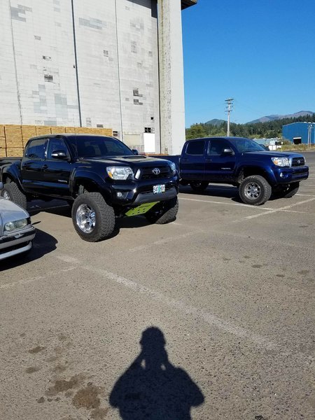

    Thanks guys for the responses I will be buying coilovers to lift the front up higher. Or maybe the bilsteins wit eibach springs like mentioned above seems cheaper. Heres a pic of my '06 its the blue one. Black one is a coworkers.

    All together I spent around $600 shipped for my shocks and coils plus the spacers from eBay. I will warn you now that you have to buy uniball uca at the same time if not your stock ucas will hit the coils and will not have any down travel whatsoever. But uniballs will fix that. So add the cost of those and your almost to the cost of coilovers. I bought icon ucas used for $400 shipped with new bushings and bearings. So I spent around 1k for the lift upgrade. I would do it all again before I spent $1500+ on coilovers which you still would need ucas anyway.
