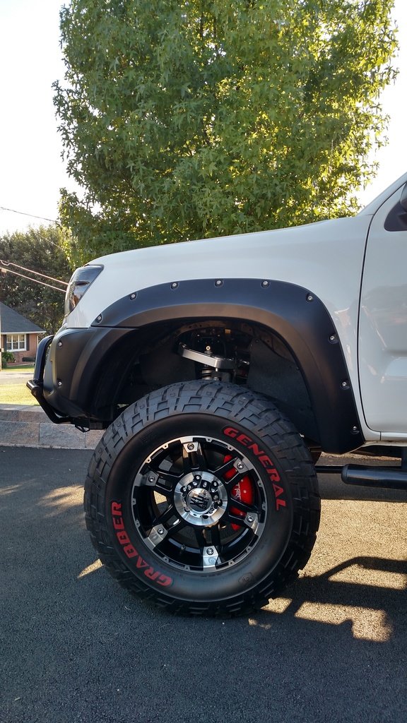

    IMG_20160830_180110723_HDR_zps1nxubsrx_0778bd3afffc2c6bc875672b55051bfe99ce4bea.jpg [​IMG] replaced spacer on pro comp to icon full length with billet uniball ucas. Big difference in ride quality.

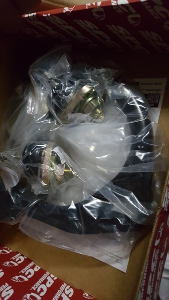

    Got some new parts in today. :yay:
    Hope to have them on this weekend.
    Also picked these up. Now to find some wheels to put them on....:rolleyes:
