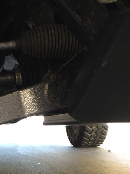

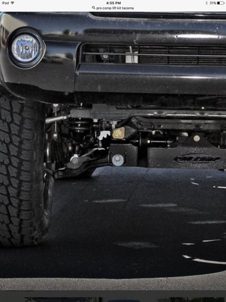

    Oh alright... I'm about to dazzle you with some serious math and science...you can completely take suspension adjustment and tire size out of the equation - because that does not change the relationship of the lowest point of the truck hanging down from the frame. You have to remember that all a drop bracket does is move the LCA down. It also moves the diff down on a 4x but again equal relationship.
    Take a look at these photos and look at the relationship of the LCA mount to the skid plate, the bottom of that skid plate sits well below the bottom of the LCA. From the bottom of the cam tab to the bottom of the skid plate is over an inch. That is the lowest point and your point of ground clearance.
    Now look at the second photo of the drop bracket truck - what's that...oh shit ...the drop bracket tucks up higher and tighter than the non drop bracket truck with a skid plate ! The cam tab is even with the bottom of the drop bracket...what !? The drop bracket actually has an inch more ground clearance...holy fawk !
    The only variable in ground clearance is then tire size and pre load BUT equal tire size and equal pre load on both trucks - the drop bracket truck still has more front ground clearance AND better approach angle and better crown clearance in the center of the truck !
    So, in closing ( and I've been saying this for years ) to all the drop bracket haters that always default to the " ...and it has less ground clearance " arguement - tell em' all to shut the fook up, case closed, thank you ladies and gentlemen, the next show will be at 7pm...mic drop...
