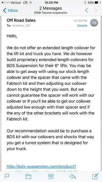

    Yeah exactly on my thinking. I was almost positive fox made the dirt logic but I'm probably gonna give icon a call and see what they can offer then check with fabtech. So I'll have something figured out soon. Just thought that was nice of customer service to think I was going to go a 3400$ route and redo the whole kit instead of just changing out my COs

    FOX makes longer coilovers for the other brands (RCD, ReadyLift, BDS, etc.), that's why they don't know/won't tell everything about these.
    Part numbers for the FOX coilovers which would fit to your Tacoma are: 883-02-044, 883-02-555, BDS 88302048

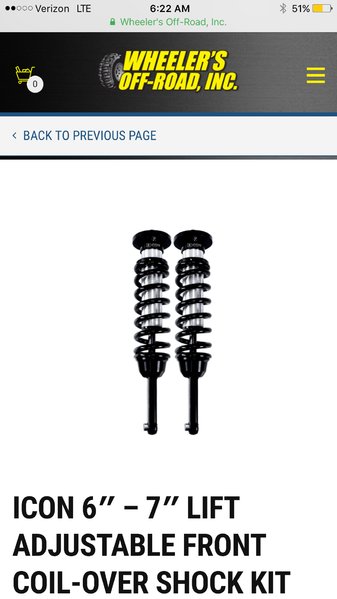

    I found what I was looking for and went with Icon thanks for the help though guysIMG_0955.jpg

    How'd you like them? I do some moderate off-roading. Nothing extraordinary anymore. Just wanted a cleaner look and more functional than those ugly spacers. Redid the rear too and ordered new upgraded shocks and leafs

    They will be much better over spacers. I think the 650s they come with are too stiff unless you have a bumper/ winch.
