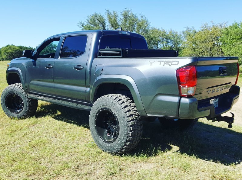

    I'm at around 6.5" lift (4 in the back). Running B110's.

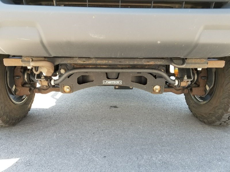

    Alright guys, I have searched on the forum to see if anyone else has had similar problems, but I cannot seem to find anything.
    Does anyone else have a Fabtech lift that it pretty rusted?

    Salt Lake life will do that.....

    Man it sucks! Do you think it is fine, or will I have to sand it down and coat it?

    Well if its just surface rust, some rustoleum should be fine. But it wont hurt to hit it with a wire wheel and then paint them

    Really good to know! do you have any recommendations on a paint to use?

    Rustoleum or U-POR products

    I'd wire wheel the rust off the places you can get to and spray everything with POR-15 top coat.

    Good idea. Thanks for the help!
