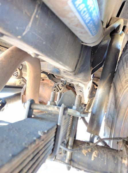

    I ordered the alcan 4" leaf pack. Just received the u bolt flip kit from all pro. The u bolts almost don't look long enough. Anyone else running the alcan 4" with all pro flip kit?

    My all pro flip handles my Deaver pack just fine

    Your tire seems to be handling the shit out of your shock too :boink:
    BAMFTACO and 2ndGenJonny[QUOTED] like this.

    I was thinking the same thing. And the bump isn't even close yet.

    It's an old inside joke with Jon and I, a glorious " told ya' so " :) but he wheels the shit out of it and enjoys the free high gloss polish on the tube :) I don't blame him for not wanting to run wheel spacers I wouldn't either if I didn't have too. I think he is still hunting for some cool wheels with backspacing to resolve it.

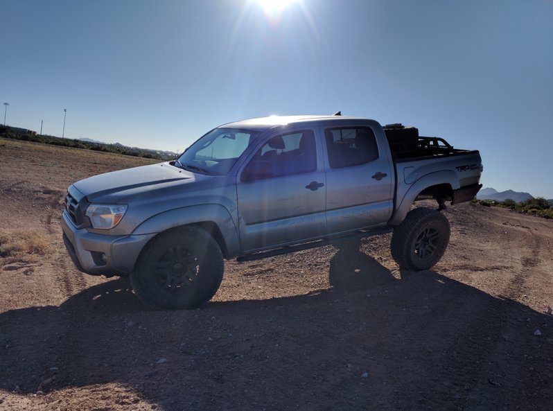

    Yea, i should drop that bump down about 2" at some point. It really just polishes the body, no damage. If I had MTs, it would be a problem for sure and would require bumping it lower.
    Everything tucks in so nicely without spacers and just performs so well tho... Srsly.. this setup is perfect for me.
    I cant give up the Sequoia wheels either. I just love them so much. Also super cheap to replace.

    Is that a 4" leaf pack?

    4" is just the lift that the arch in the pack gives. These started life as a 5" pack that I had de-arched to about 3.25"

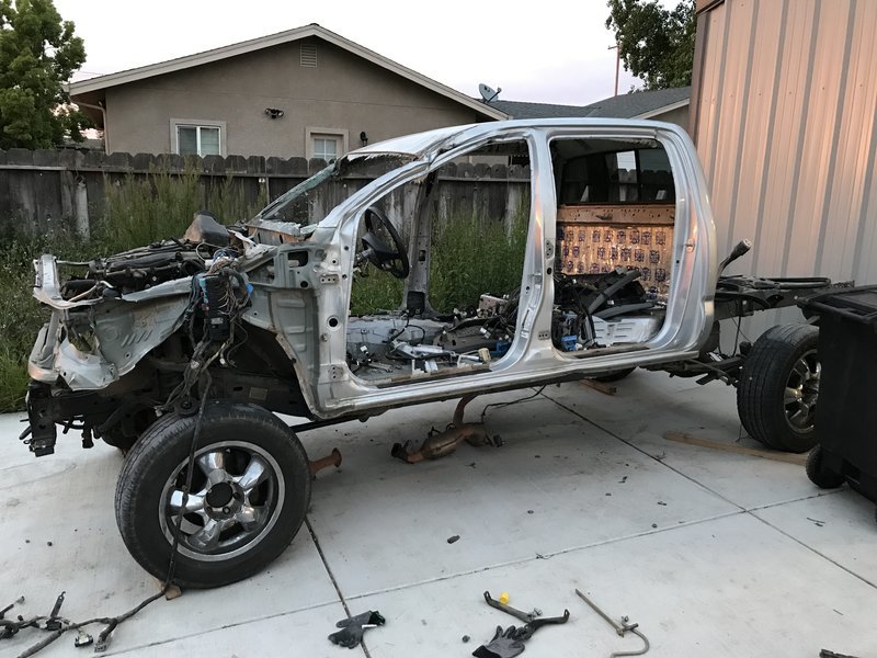

    What's left of my 6" procomp lifted taco
    Anyone want some procomp spindles
