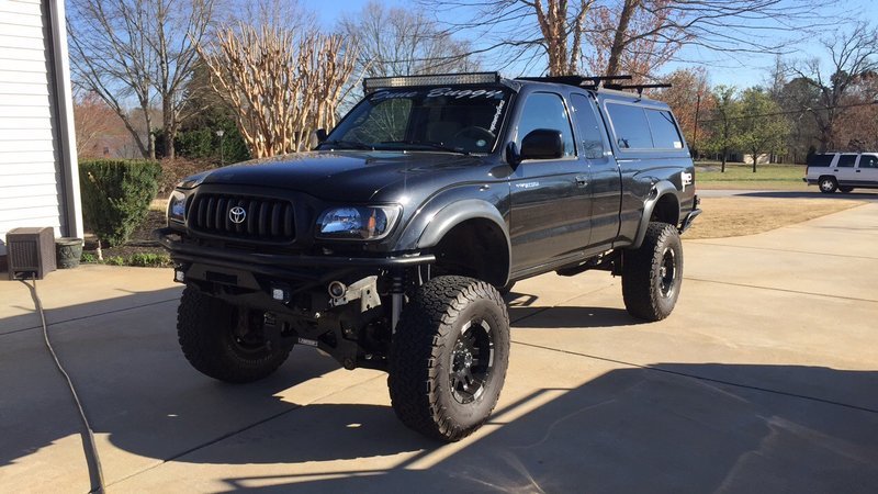

    I'm not sure if I fit in here with all the newer trucks but this is my 6in Fabtech
    chinorx3, Npizano, ChadsPride and 4 others like this.

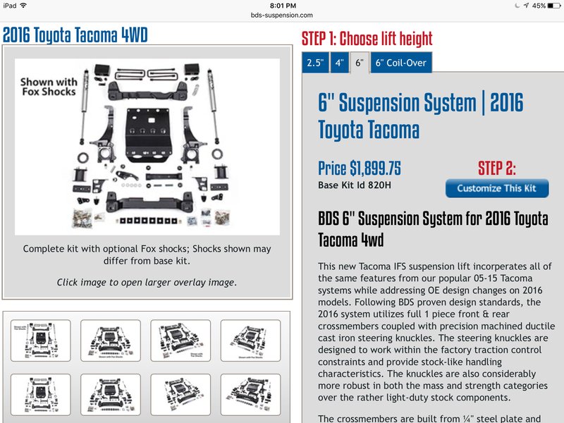

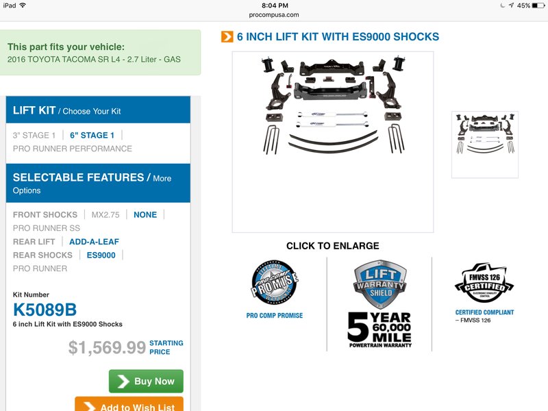

    I'm getting ready to purchase a 6 inch kit for my 2017 Tacoma and I was wondering what the consensus is basically who has the best kit I am considering the Procomp or the BDS. The BDS I like the crossmembers but I don't like the 4 inch rear block. The Procomp comes with a smaller block and add a leaf . Which kit drops the lower a arm the most? Which one keeps the CVs the straightest. Or does somebody recommend a different six-inch kit
    Thanks
