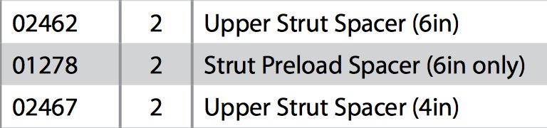

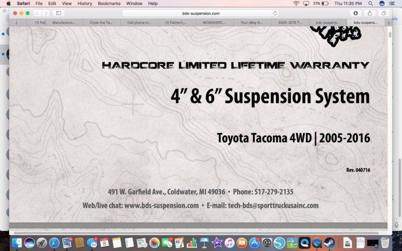

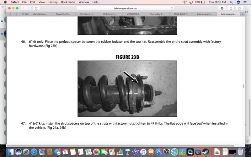

    Im not saying I don't believe you. I'm just saying from reading the instructions I'm not convinced. The instructions say for 4" and 6" kits
    Also in the parts list it says that 4" and 6" kits use different strut spacers so not all the additional lift comes from the small pre load spacer
    the only difference I see is in this section here where it says "6 inch only"Screen Shot 2017-06-08 at 11.35.31 PM.jpg
