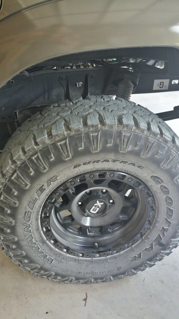

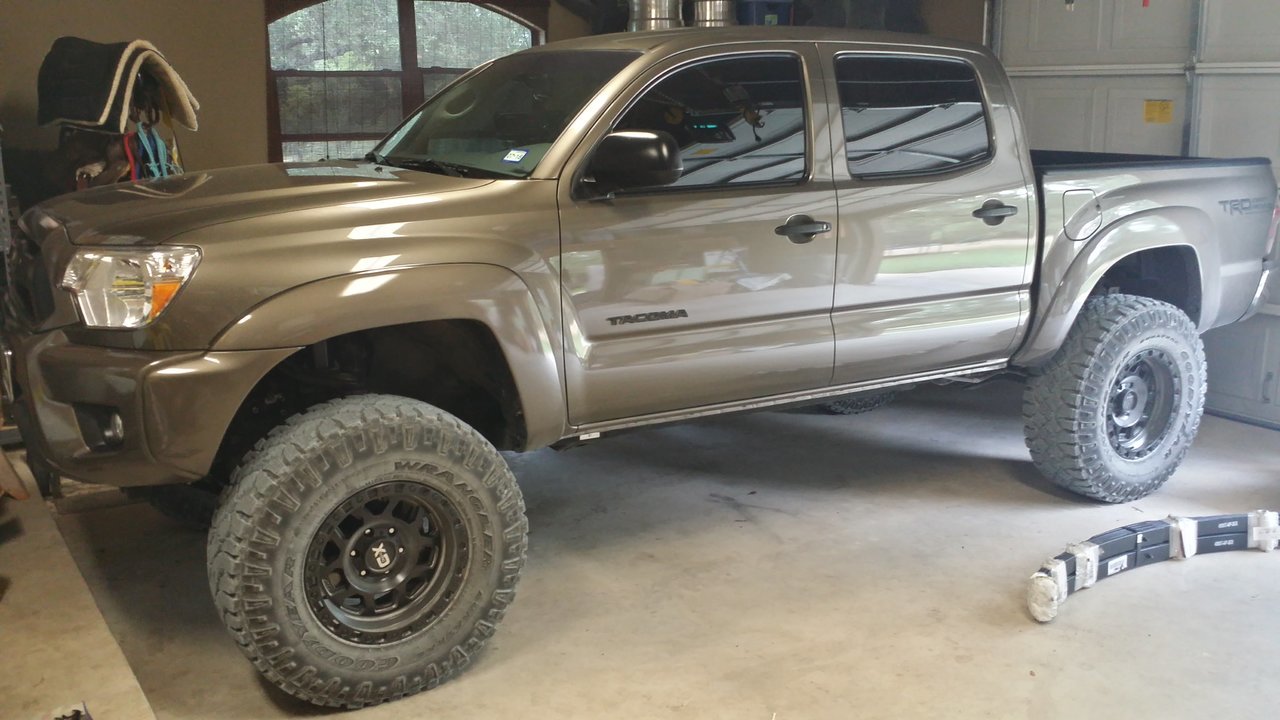

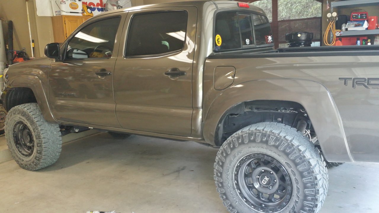

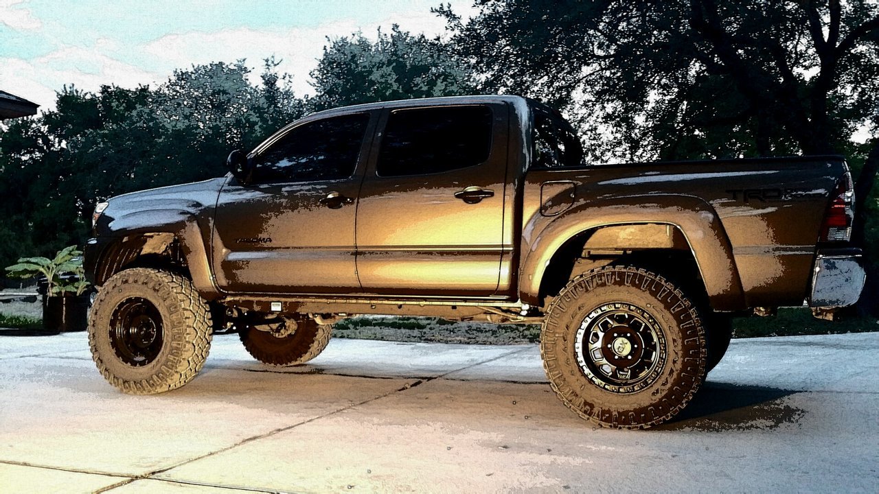

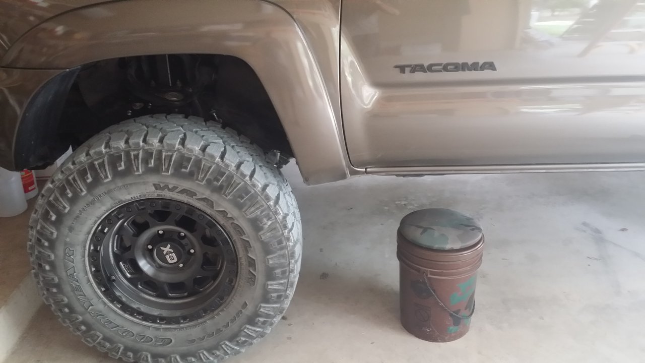

    I just pulled the trigger a very short while back. Went with the RC 6" kit, 5100's on all 4 corners, threw in the blocks in for now (coming off tomorrow) because my springs weren't here in time. I got the all pro expos around july 4 since the shipping was free, they arrived the day after the lift was done. Will throw a 1 inch block under them, and see how it is, and adjust as needed (don't know how much lift to expect from them for sure). Longer stainless braided lines all around. I still haven't taken many pics of it, since I've been super busy. Which is one reason I had to do the lift without the rears here yet. So far I've been happy with it. No strange vibes or noises anywhere and seems to ride very good. Went with 315/70/17, wheels are KMC Robby Gordon II's. I had 13.5" of clearance at the front skid, and 10.5 at the rear diff, but I've let a little air out of the tires since they were a little overfilled for my taste. Lost a 1/4 inch of clearance at the front skid and maybe the same at the rear, but didn't check it yet to confirm. CV's aren't flat, but not at a crazy angle either, so I think I can live with that. Trade off for the clearance I guess. With a daughter in college there is only so much cash I can throw at it at once. But, I will eventually try to upgrade things in the future. Still rocking the stock UCA for now etc. I have not had to do any trimming yet, but haven't really had a chance to get out and see if it's going to rub anywhere. I thought I heard either a very slight rub or a creak in the suspension on a hard turn that stuffed the tire on the outside front, but it was so faint I didn't get a chance to figure it out, and it was only once. Looking around I can't see any evidence it has rubbed anywhere. But when I get some time I'll get out and try to find any rubs and trim if need be. Over all I'm happy with it, and the ride. And personally, I really like the stance with the 315's. I've been through the Texas hill country with it and I barely noticed a difference on the hills with them, other than the speedo being off of course. But I haven't been fully loaded with gear etc in some mountains, so we'll see if a re-gear is in my future. I expected it would be, but so far I was pleasantly surprised with the stock gearing. I should note that I'm not building it for hardcore rock crawling (wouldn't have started with an IFS rig if I was) or a desert racer, but I do plan to wheel it too. At least to the best of it's ability. Anywho.. I'll add a couple of the few pics I have taken so far.
