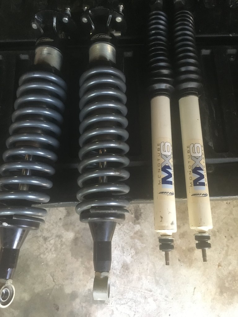

    Cant remember if I took that second pic at full droop, tires off the ground

    Lift, wheels, tires
    Glad to see the deal worked out. He's shipping my stuff tomorrow

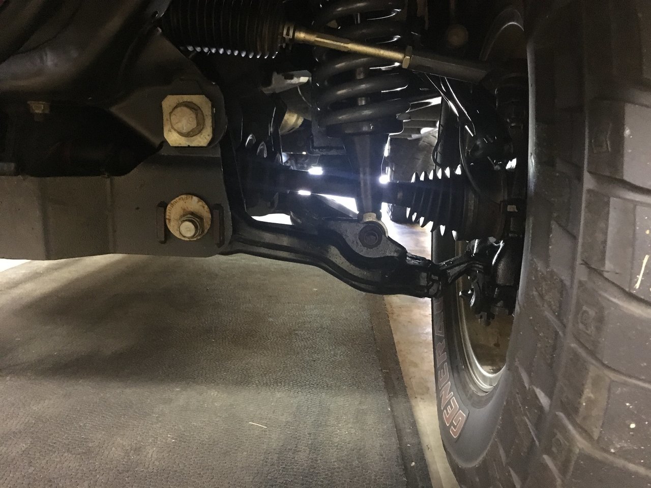

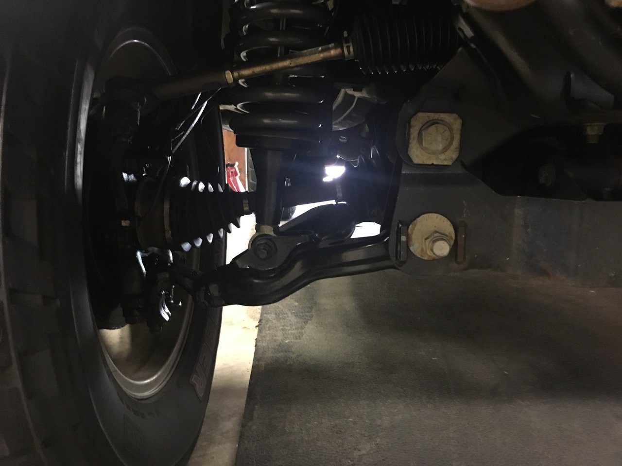

    The ride seems fun I took some measurements this morning. CV angle looks like the passenger side has more of an angle to it. Might just be me. Measurements are from the ground to the wheel well.
    LF
    42 7/8
    RF
    43 5/8
    LR
    41 7/8
    RR
    42 5/8

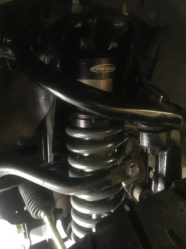

    Also measured the amount of threads showing on the coil overs
    LF
    2 5/16
    RF
    2 3/8IMG_1192.jpgIMG_1193.jpg

    I know normally you don't use a top plate spacer with coilovers, but procomp includes a 1/4" spacer for the drivers side to correct lean. That should give a 1/2" more lift on the drivers side.Or make it level side to side.

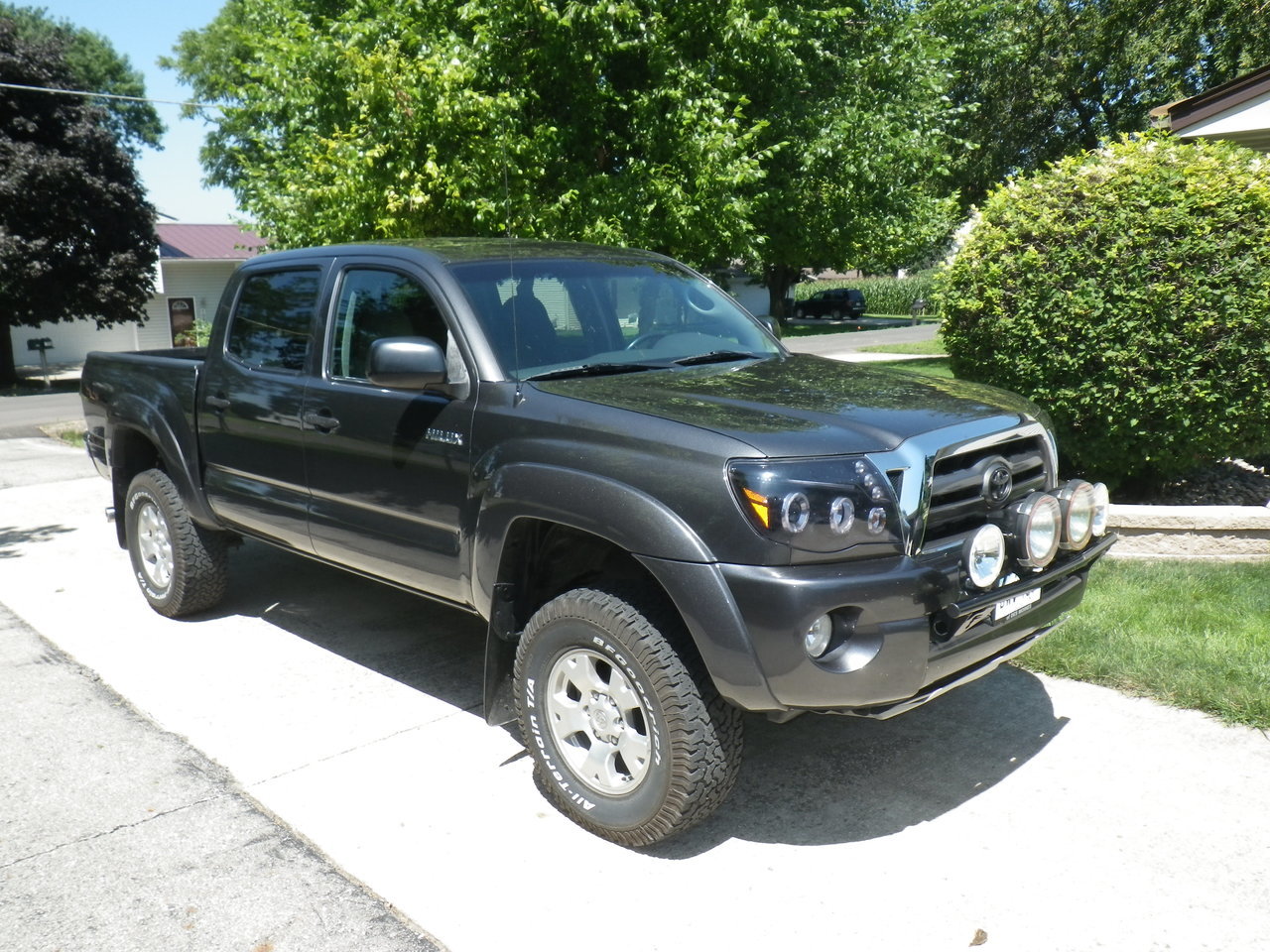

    RIMG0363.jpg I measure 19 1/2 inches between the drive and the bottom of the rocker just behind the front wheel on my Pre-Runner with a Pro Comp 3 inch lift, thinking about changing it out for a 6 inch tho

    You should not need the spacer since you have adjustable coilovers. The driver side should have roughly 1/4" +/- more thread showing on top than passenger side which would net you 1/2" +/- more lift on driver side taking care of "taco lean". So you can adjust the spring retainer nut if you have the wrench to level it out.

    What is that bolt on the sway bar?

    I'm assuming you are referring to the bolt that holds the sway bar to the bracket that attaches to the end link?

    DBs relocate the swaybar, at least my PC did before i cut it off.

    Yeah mine doesn't have that. Was wondering if it was a quick disconnect

    maybe it was cut off/removed at some point
