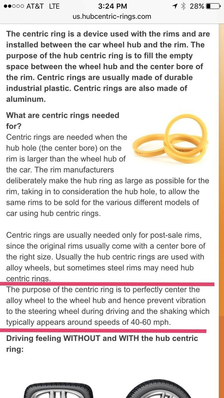

    I got a 4" zone off road (DBS) lift, and had 33" nitto ridge grapplers and 18" fuel wheels put on all at the same time. It was done through Toyota dealership. When I drive 45-55 MPH I am experiencing a shake in the steering wheel. I have brought my truck to Toyota 3 times and they road force balanced wheels, did an alignment 2 times and I am still experiencing vibrations. I posted videos of it in my thread. Any help would be so greatly appreciated. And if you. An check out my thread I will forever be grateful. I absolutely love my truck, but am currently looking to resolve this shake.

    First thing is what is the hub bore size on your wheels. Could be a simple fix such as hubcentric rings
    EDIT: I went and looked up your wheels and they are 106.4 which is good but I would check to see what kind of lug nuts were used. If the incorrect lug nuts were used it could be causing the wheel not be seating against the hub properly.

    I am not gonna lie, I definitely didn't know what size it was before looking it up just now. Bore size is 106.40 according to the fuel website for a -12 18X9 6x135 fuel asssault wheel.

    When I went and looked up "what are hubcentric rings?" This is what I read, which seems eerily familiar (it even says 40-60 MPH felt in steering wheel). Could this be it?

    This could very well be your issue. It is a simple an inexpensive fix. If you still find issues after this, I would check to see if your carrier bearing needs to be dropped. This will also cause vibrations.
