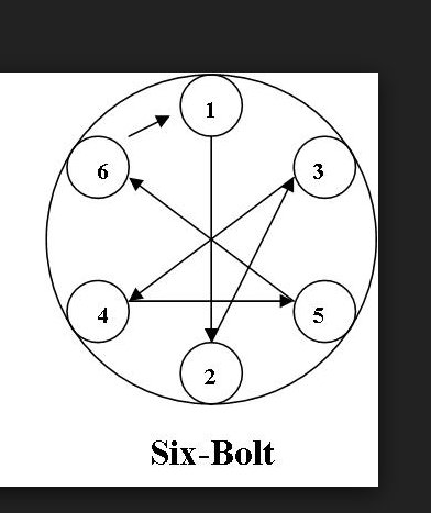

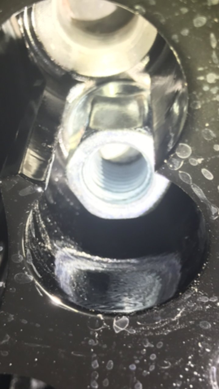

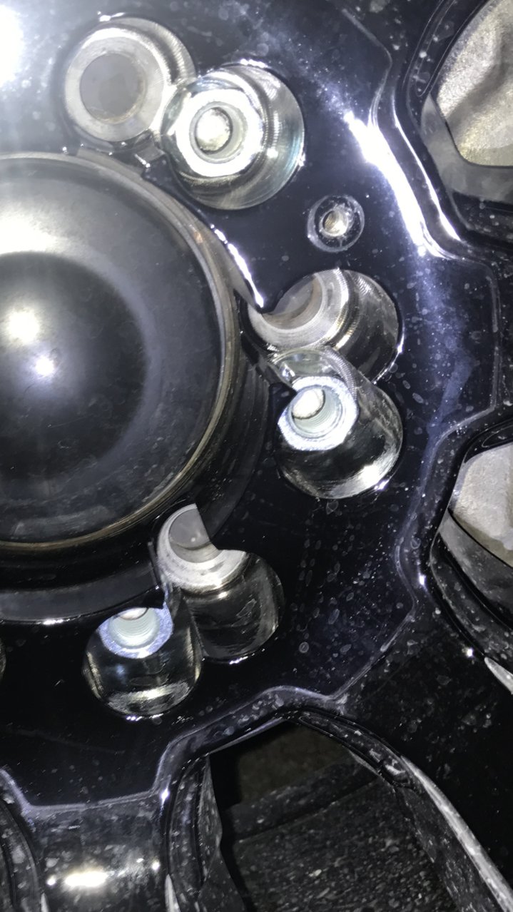

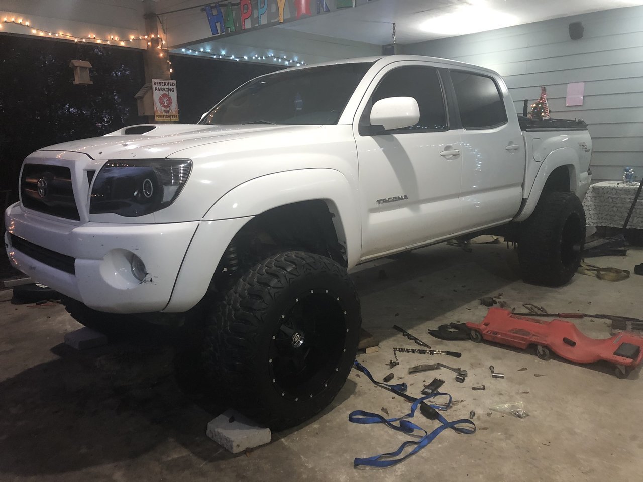

    You may also want to look at some extended acorn style nuts as the ones in your picture do not look like they are grabbing very many threads. Make sure that you tighten them up in the correct pattern. This will also help you center your wheel on the hub.

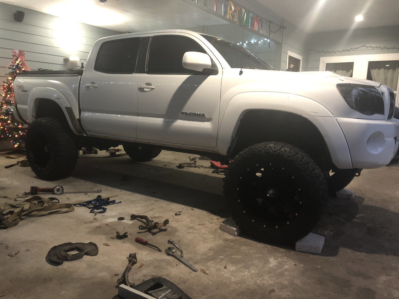

    What do you mean by carrier bearing may need to be "dropped"?

    The first thing I would do is get ET lug nuts. And, I would make sure my alignment numbers showed +3 caster. If they can't get +3, tell them to get it as high as they can.

    That does look like a hell of a lot of threads not catching. However I'm not an expert at all when it comes to this.

    Thank you soo much for your suggestions, seriously, this is all stuff I would not have came up with. In def going to look into lug nuts, and then the hubcentric rings. I'm not sure how much the hubcentric rings would cost, or even how to order the correct ones. Any advice? Or should I just ask dealership?

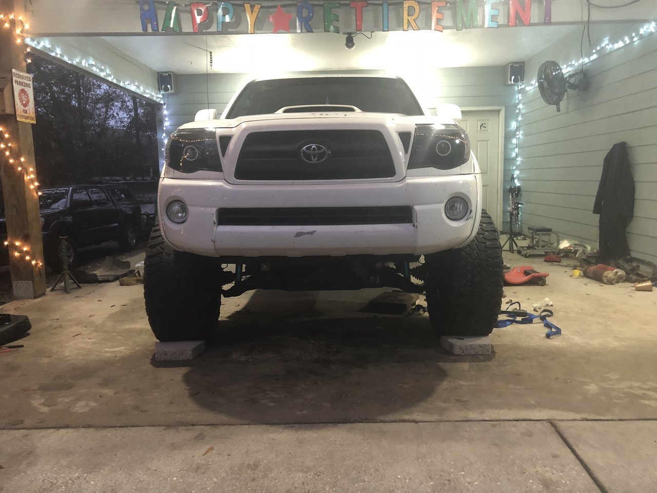

    With a lift on your carrier bearing could be causing vibrations in your driveshaft.
    First pic stock
    Second pic shimed.

    Just for the hell of it take one of the lug nuts off and take a picture of it. Curious to see the taper on it if it has one.

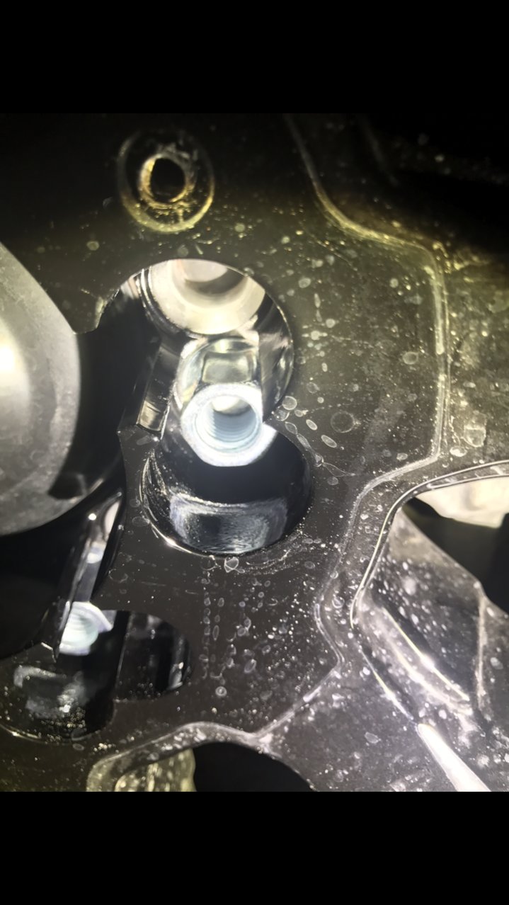

    Oh dear jebus please replace those lug nuts with the correct ones today. There can't be more than a few threads on that lug nut. The others look the same.
    You need at least full threads pulled through the lug nut. If they were to fail your wheel will come flying off. No bueno mi amigo...
    ...and yeah this could be the reason you feel the shake if the wheels are flexing on a few lug nut threads.

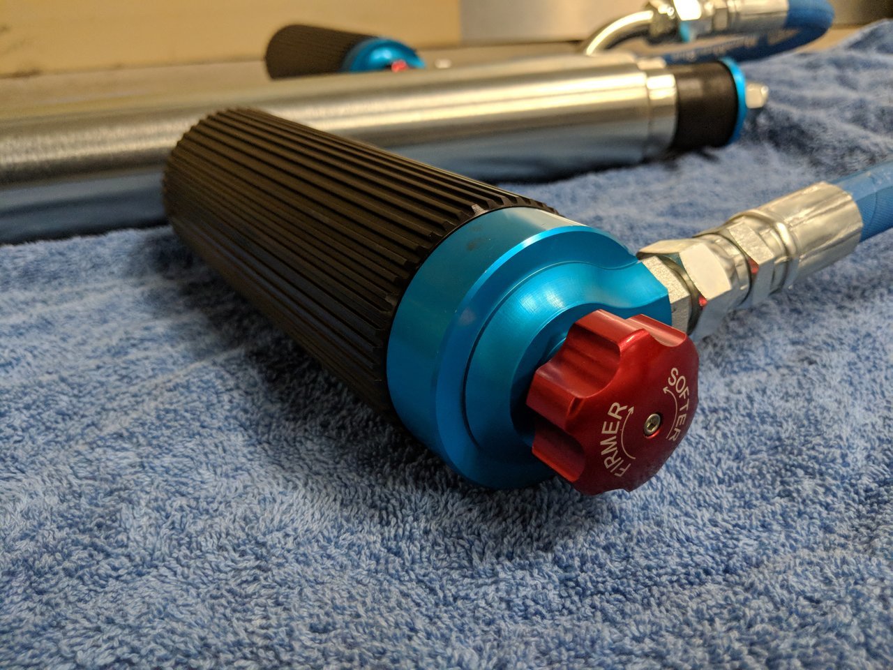

    So I fiiiiiinally got my custom length shocks in. 15+ weeks of waiting. Shit timing with SEMA, Baja 1000 and LA Auto Show right in the middle.
    Truck:
    RCD Bilstein up front, preloaded spring to 6" lift
    OME Dakar leaf pack
    Archive Garage shackle flip in tallest setting (6-6.5" lift)
    Kings
    27.02" extended
    16.86" collapsed
    10.16" travel
    Compression Adjusters
    Finned reservoirs
    Observations
    -Bilstein measures shocks from eye to where bottom bushing washer sits on stem
    -King measures from eye to middle of bushing sandwich, untorqued
    -My 27" Kings are about 26.50" in Bilstein measurement (lost about 0.75" of length versus the .25" I thought)
    -If those measurements are correct, I did not lose any collapsed length (thought i was gonna lose 0.5")
    -Did a night run for testing and didn't notice the missing 0.75" droop.
    -Likely will need more weight to wake up the Kings - truck is empty - usually have bed rack and RTT
