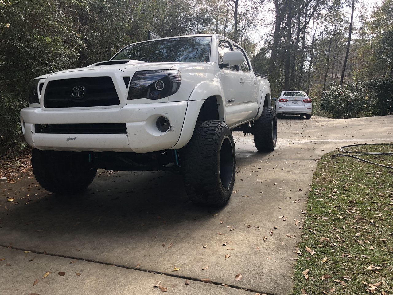

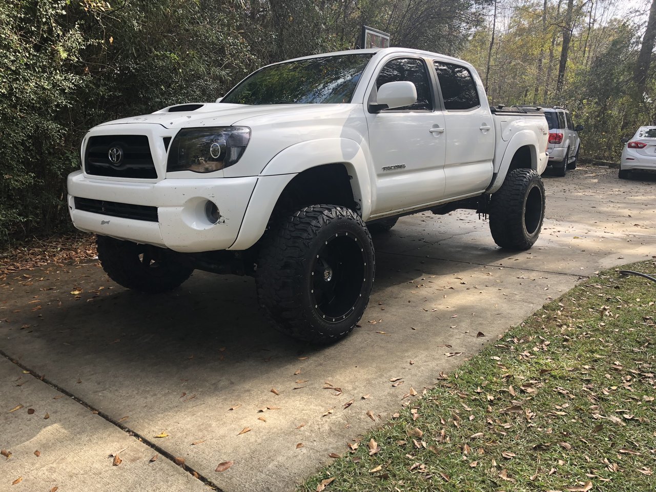

    I am and will likely leave the stock gears. I’m in school and don’t drive much so the fuel savings would not make up for the cost of the gears and I don’t plan on keeping the truck for more than 2 years so the next owner can deal with it.

    Tire size??

    35's in this picture. Bout to jump to 37's

    at 6" my 35's rub but that's a lot to do with the wheels. They are 12" wide with 4.75" BS and 1" spacers. Tire fitment largely depends on wheel width and offset. I could have fit 35's when I had a 3" lift if I would have kept the stock wheels but could barely turn with these. all depends on wheel specs

    37 on stock gears i feel sorry for that tranny.

    I hear you on that. I think my 35's look to small on the 6 inch lift.
