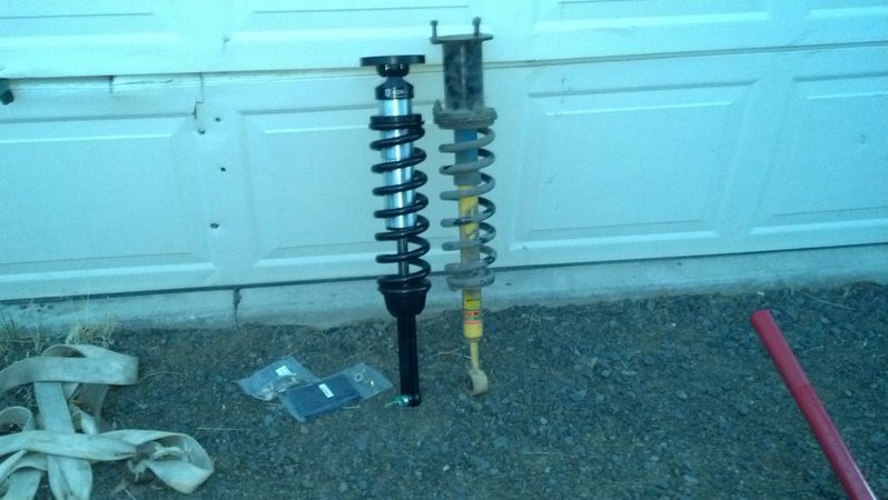

    Stabilizer Bar? What does that look like? I have my factory bilsteins with the fabtec spacers yet. The yellow one in the pic

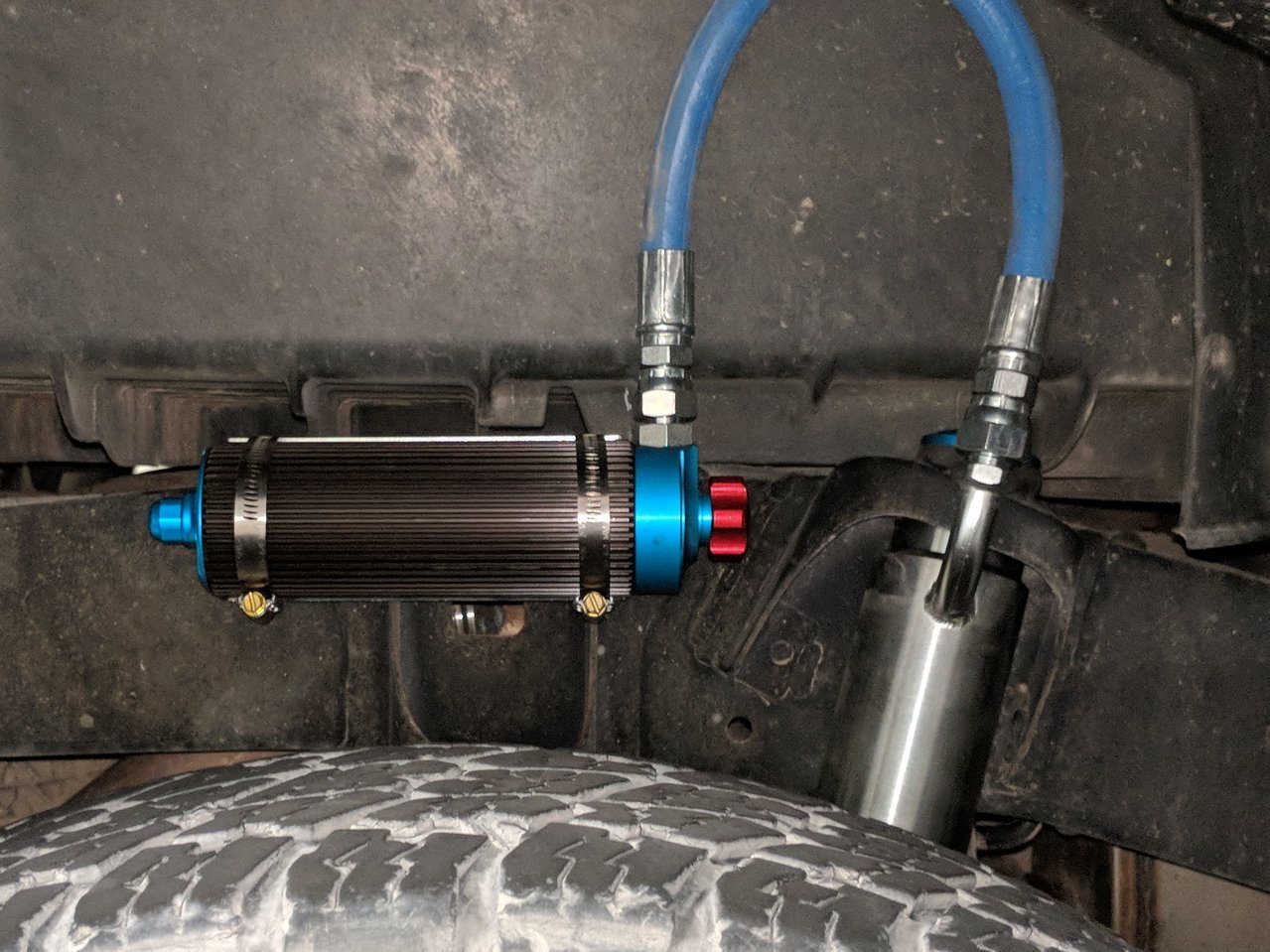

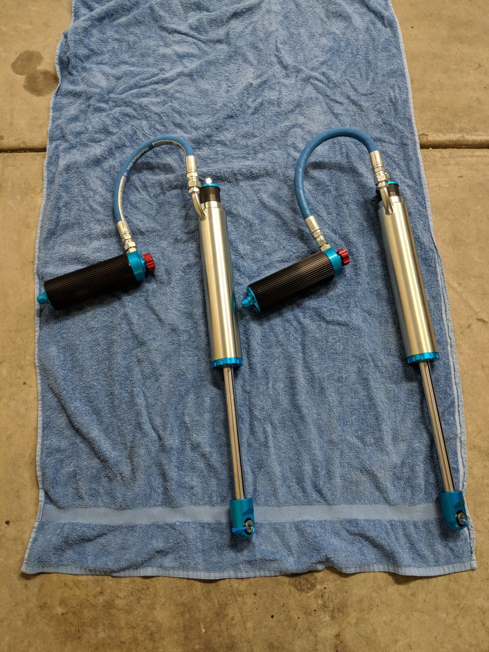

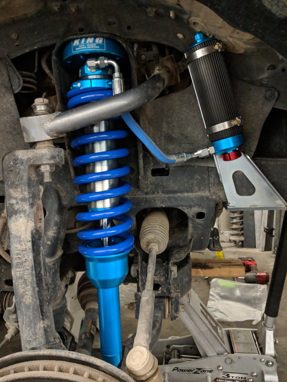

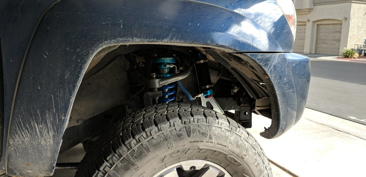

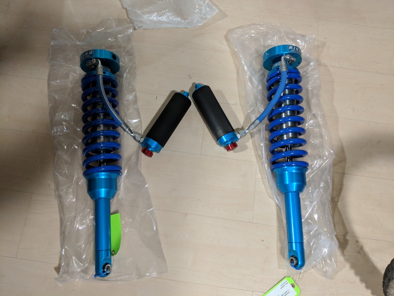

    Got my King coilovers installed this week. 25001-619A with Finned reservoirs and 600# springs. Set height at 25.5" hub to fender. Smoothest ride I've ever experienced. I thought my 5100's were smooth... these Kings make them feel like $20 VatoZone specials.
    I did a shakedown right after I installed them. Threw 12 click of compression in and they sat at 24"/24.5" hub to fender. My GOD, they eat up everything. Did manage to bottom out a couple times on some big whoops, but at 1.5" lower than normal, I'm not surprised. Cruised a "smoother" section at 50mph and felt like a side street. Hit 70mph on a rougher bit and she was just gliding.
    I do experience the abrupt topout that Kings are known for. But the ride quality more than makes up for it. Might look into limit straps to dampen the blow.
    It's too early to tell, but I may need to go to 650# springs. I'll go thrash these around the desert for a few months and find out.
    For anyone interested, I had to preload 11 turns on drivers side and 6 turns on passenger side. I also have custom length/travel bolt-in rears to match.

    Looks good man :thumbsup:
    What did this setup run you with the custom rears?

    Thanks!
    Finned resi's are $75/piece, custom length is $200/pair. Front and rear have both upgrades.

    Icon coilovers like these

    They look different heights.. and is there really any savings?

    The yellow one is the factory bilstein shock with the spacer the left is icons coilover shock fully adjustable to your driving style and height adjustable for camber also.
