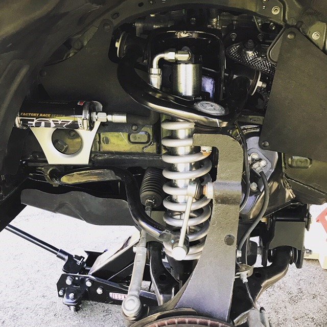

  11. Nov 27, 2018 at 11:10 AM
    Watdt
    Watdt Active Member
    Nov 15, 2018
    #272759
    30
    6” zone lift
    This weekend full fox up front with Total Chaos UCAs to remove spacer and OME Dakars in rear...
    QUESTION?
    The rear is stock springs on 4” block
    With the new leaf pack w/ 2.75” lift would you got to a 3” or 2” block to level the rear also going to adjust preload up front an extra 1.5” for a full 7.5” up front lift so a little rake will be be fine.
    Thoughts?
    Trd sport tacoma likes this.
  12. Nov 27, 2018 at 11:12 AM
    Watdt
    Watdt Active Member
    Nov 15, 2018
    #272759
    30

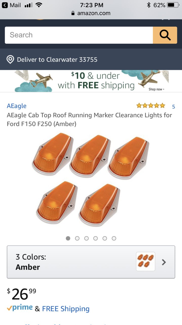

    How do you attach the lights?

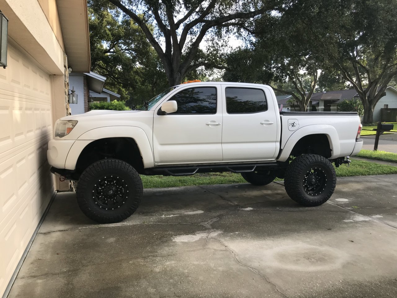

  17. Nov 28, 2018 at 3:37 AM
    Trd sport tacoma
    Trd sport tacoma Well-Known Member
    May 5, 2018
    #252590
    130
    Gotta drill holes for mounting them.
    BORNWILDGUY likes this.
  18. Nov 28, 2018 at 7:18 AM
    Watdt
    Watdt Active Member
    Nov 15, 2018
    #272759
    30
    Where did you get the lights looks great

    Amazon for around $28 dollars shipped.1FF80CF9-753D-4461-8540-B4AA9D6A3C83.jpg

  20. Dec 1, 2018 at 12:13 PM
    Watdt
    Watdt Active Member
    Nov 15, 2018
    #272759
    30
    MC love your truck looks incredible I’m getting ready to do the same thing I just got my fox coil overs for 6 in lift and was wondering did You just replace the front struts and spacer and leave it at the same level that it was that or did you go up in height at all and if you did go up in height did you encounter any problems with any of the Toyota features if you have any of them like traction control and ABS etc. you know if you have any of those did you have any problem at those getting those all ironed out when you had your alignment done
