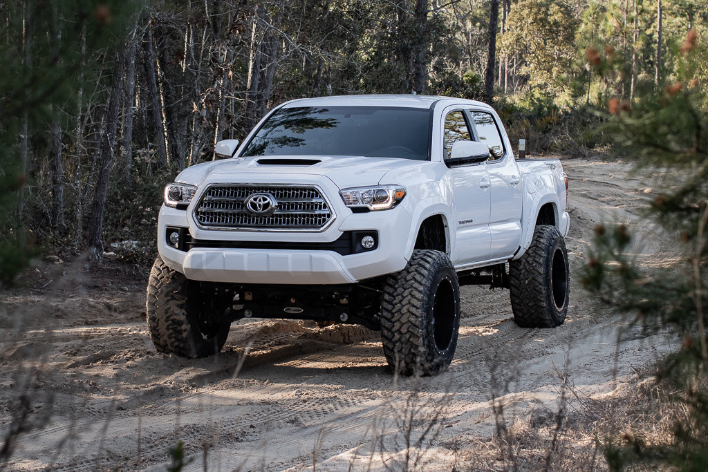

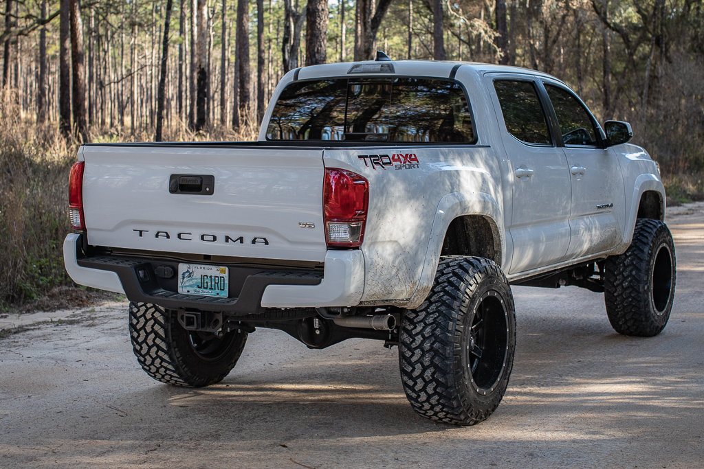

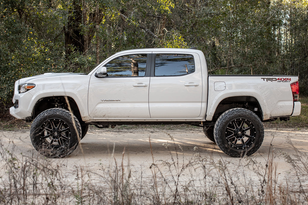

    6" pro comp
    6" pro comp stage II with 35's and 20x10 rims.

    What are the wheel backspace offset and lip size I like the look. Any rubbing and did you do any trimming

    hwy sorry man, just saw this. -44 backspace. A lot of trimming and they still rub haha. going up more soon.

    If it is -44 offset you have 12 wide wheels not 10 wide wheels and you back spacing is 4.75
    20X12 6x135 6x139.7 D61020209847 NBL-Gloss BLK MIL 106.40 -44 4.750 1001-63GBR

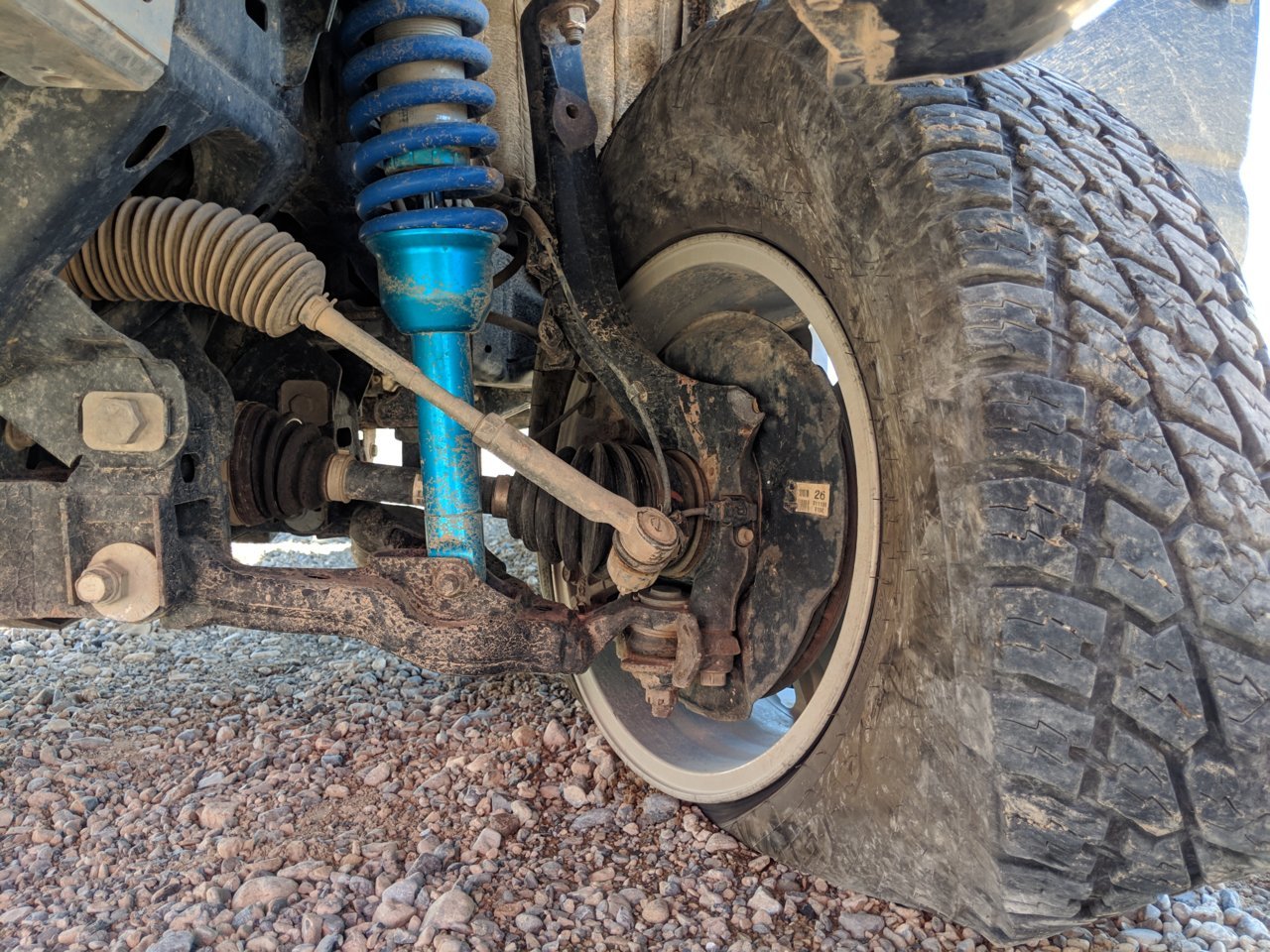

    Well everyone, I managed to break an RCD spindle yesterday. Depending on how much a new set of spindles costs from RCD, my Kings might go up for sale. Currently about 10k miles on the rears and 7k on the fronts.
    Details here: Fabtech, ProComp 6" lift or more. Pictures

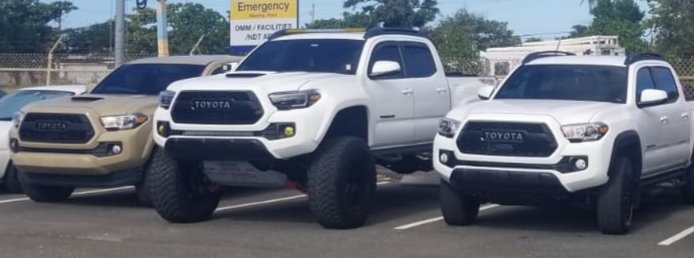

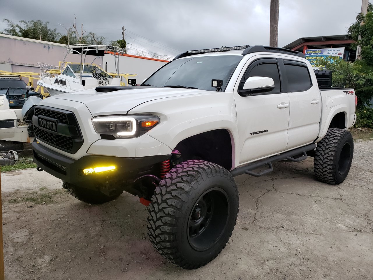

    Anyone have the radflo rear shocks with reservoir for 6 inch lift?? I wonder if they are good as my front radflo coilovers.. thinking on getting them

    Any updates on your RCD rebuild?? That’s some carnage... wish you the best.

    I'm tearing it out in prep to sell the truck.(buying a ZR2 in the next couple weeks) Going back down to a 3" lift. Trucks basically getting a brand new front end. New Mevotech LCAs, 5100's, OME 885 coils, wheel bearings, tie rods, powerstop drilled/slotted rotors and Akebono pads. Even the stock spindles only have about 15k.
    A basic 3" truck is easier to sell than a built truck with a drop bracket. Plus RCD didn't respond to my emails (wasn't trying hard to get replacement spindles). Situation just called for fresh everything.
    Keep the crossmember piece, diff brackets and spindles if you can. Never know if you might wanna revert like I am doing.
