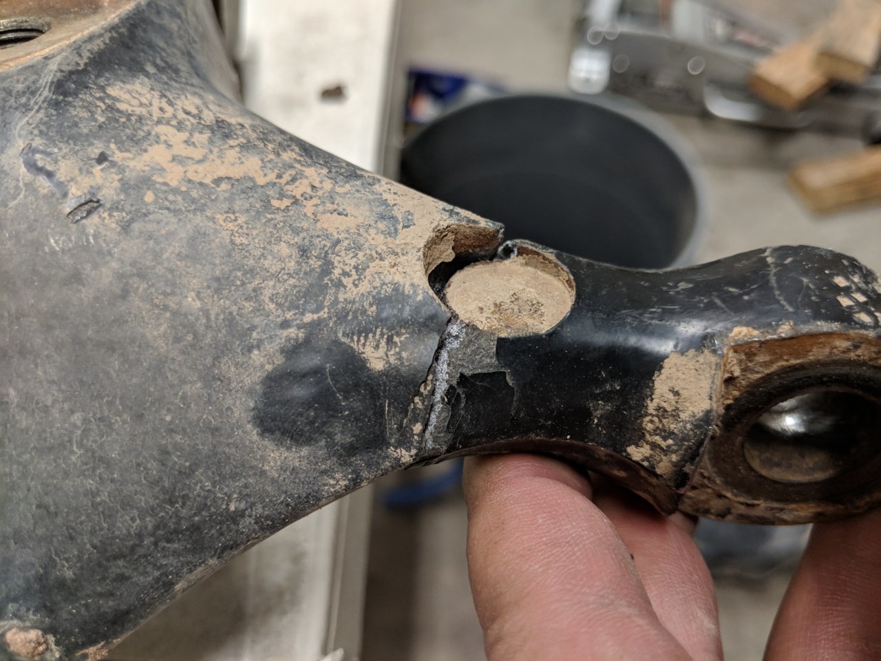

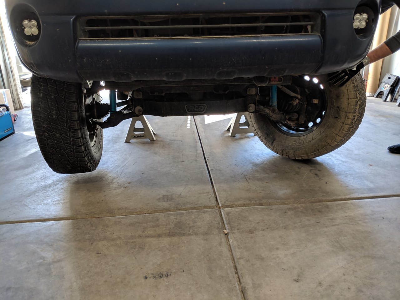

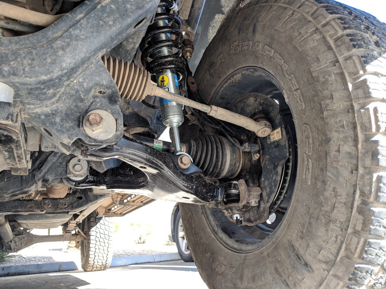

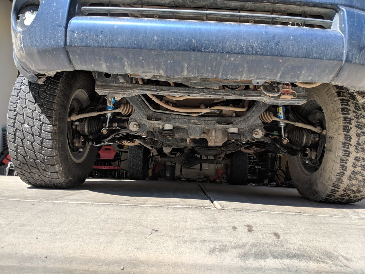

    Well, I got her back together last week but been busy. Wrapped up the odds/ends this morning and threw on an eye-balled alignment. Found the cause of my failure was this utterly stupid divot in the spindle casting, right at the highest stress area of the tie rod connection. It's an RCD 4.5" kit. I'm completely disappointed in a bunch of guys that call themselves "Race Car Dynamics" that allowed that spindle casting to be sufficient for production. Either way, the kit is going in the trash. The passenger spindle has the same casting divot.
    Here's a couple pics of a less than spectacular transformation. Gonna miss my Kings... and the additional 3" lift. FYI, this downgrade was stupidly time consuming. Next stop is adjusting the Archive Garage shackle flip, pulling an overload or two out of the Dakar leafpack and pulling the rear Kings for some B110 5100's.
