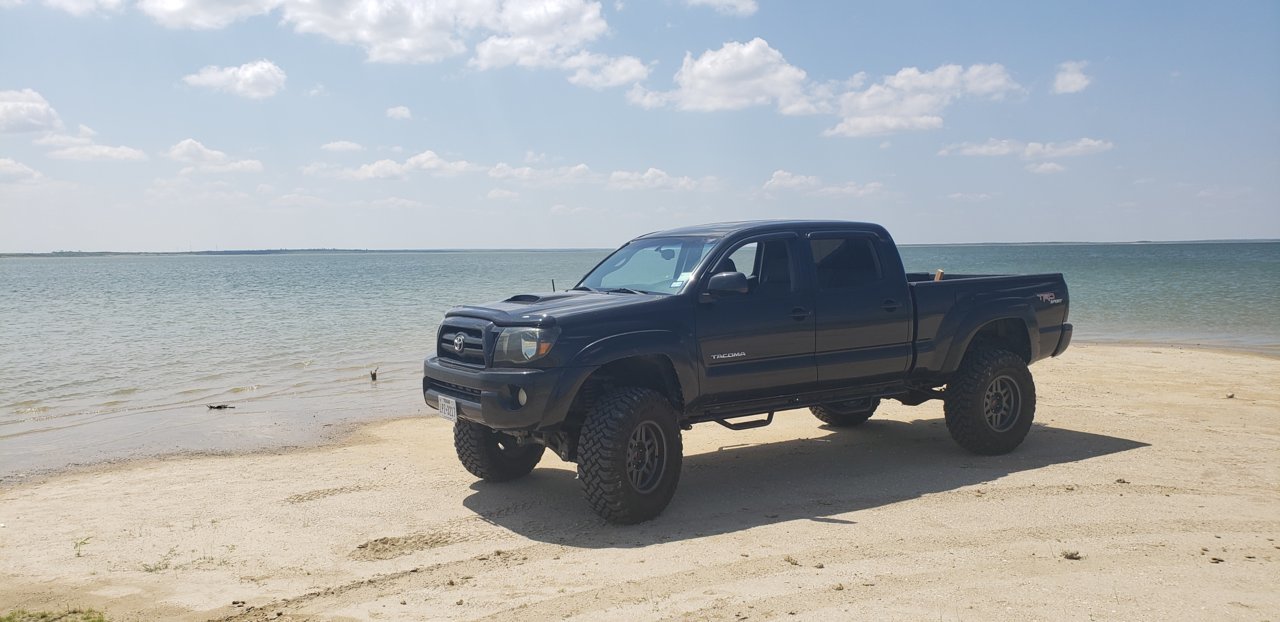

    6" fabtech left 35" tires
    Just curious if anyone has the 6" procomp coilover and if so how do you like it? I'm ready to replace my strut tower spacer lift but not that ready for icons or other brands. Thanks guys

    Here is a pic of mine with fabtech 6" shitty spacer lift and 35" falkens 20190908_144509.jpg
