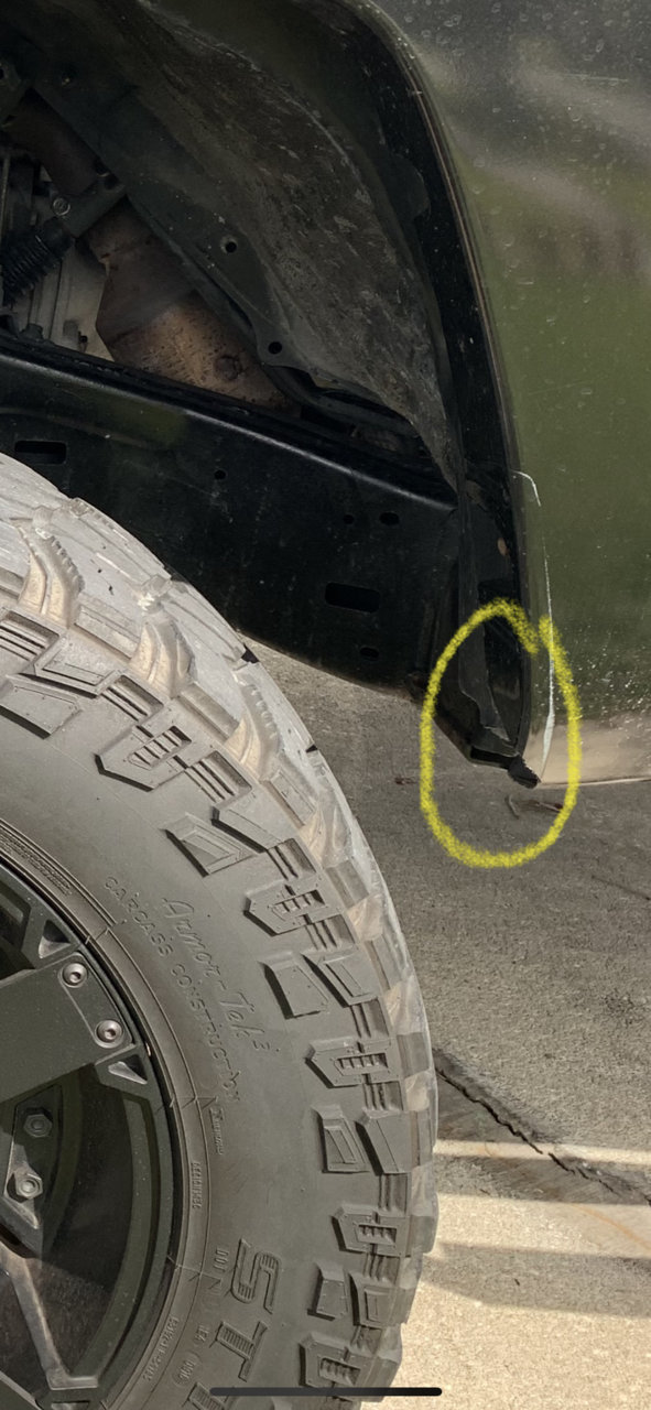

    @sblspawn I don’t have a gauge on my trans, but I have the tow package and a trans cooler if that helps lol. And I honestly trimmed only before I lifted it 6 inches just the plastic of the fender flare that wrapped up into the wheel well itself. I do not rub whatsoever. But I also have bilstein 5100s up front for about another 1.5 inches of lift.

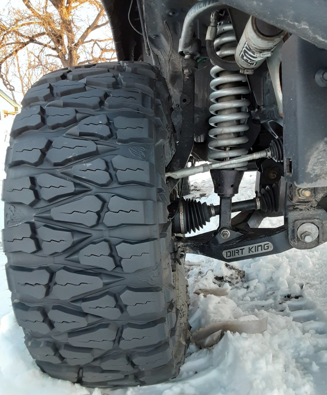

    @Blacktacoma23 i love the set up man. Looks good. I just know I wouldn’t ever modify the frame in anyway. Nothing against doing so, I just don’t have a desire to do that to fit larger tires. If I can’t fit the 37s without cutting metal I will gladly stick to the 35s. But I must say...those lower control arms are beefy. Did those allow the extra lift with the coil overs get in alignment better? Or was it a must to achieve the added lift?
    @sblspawn see the picture I was talking about.

    Strength! Replace the lower ball joints with uniballs. Slightly more ground clearance. Delrin bushings too. (Back in 2015 they were 1,500 and I dont see the same version on their website anymore they went to ball joints)
    https://dirtkingfabrication.com/col...ucts/performance-lower-control-arms-dk-811704
    Upper control arms (especially heim joint versions) allow for the most adjustment correcting alignment.
