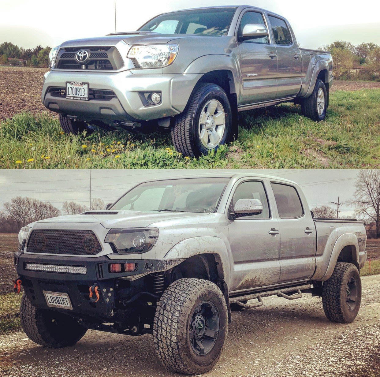

    Fresh look to my 6" 2015 DCLB with a Chassis Unlimited Octane bumper, lighting, and some rear Spidertrax spacers!

    I love the ride personally. No complaints at all. I think for me its a perfect DD Lifted truck. Running Zone 6" with RCD 5100s designed for the RCD Kit with Eibach/Toytec 620 Coils. Also running about a 100' bumper with no issues.
