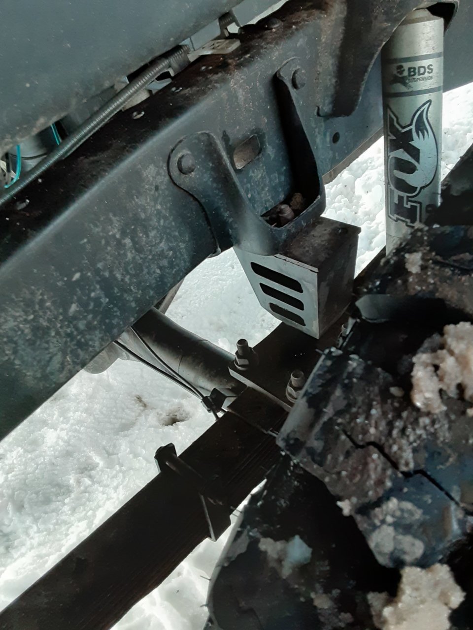

    What rear shocks are you guys running? I have an aal and 4” block in the rear with the rough country shocks. I have the 6-7” icons upfront and want a nice shock in the rear tooB2100119-7887-433A-92A2-989046D7F16A.jpg19F2C61C-A548-4A8C-BD89-1CA6B40FB7F3.jpg

    BDS fox that come with a 4" kit (the 6" kit ones were too long for my rear springs)
