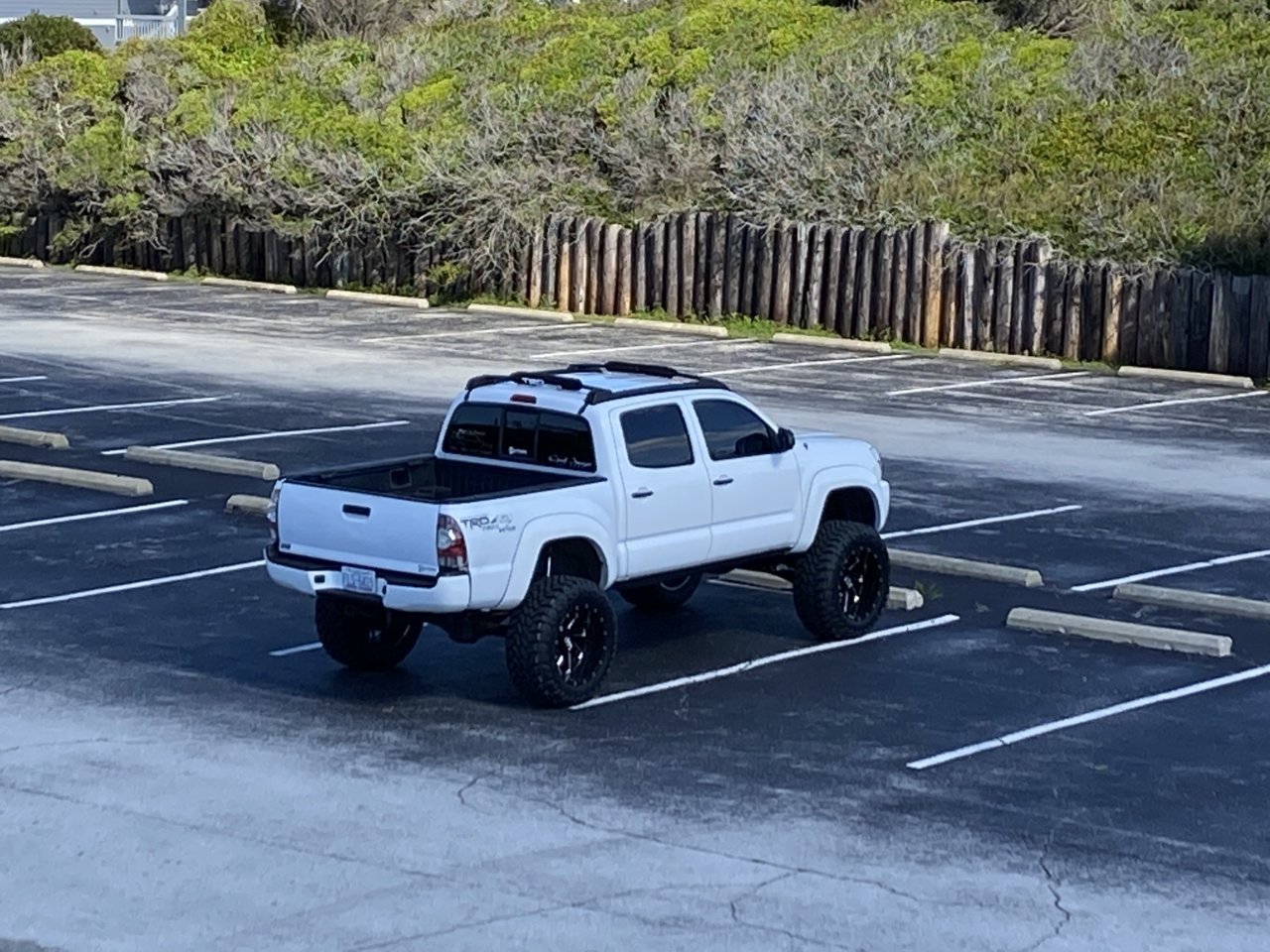

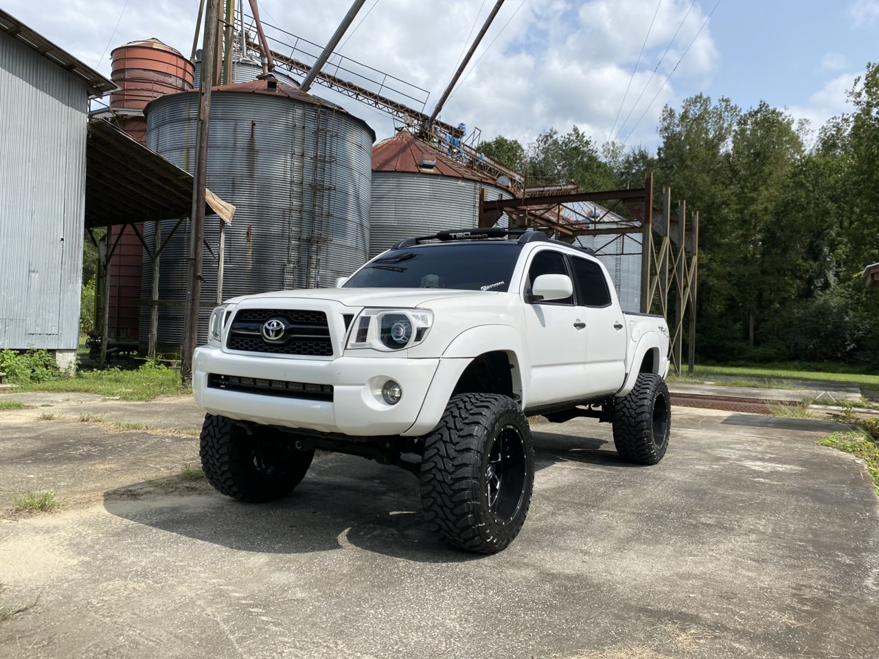

    Sorry if this was answered already.
    What size wheels and tires are you running? Looks fresh!
  2. Oct 27, 2020 at 5:00 PM
    LSC15
    LSC15 Southern Retrofits
    Feb 13, 2013
    #97458
    7,043
    Logan
    2008 TRD D-Cab
    2008 Double Cab - Current 2002 4runner - Sold 2001 Double Cab - Sold 1995 Xtra Cab - Sold
    20x12 with 35x13.50 Toyo MT

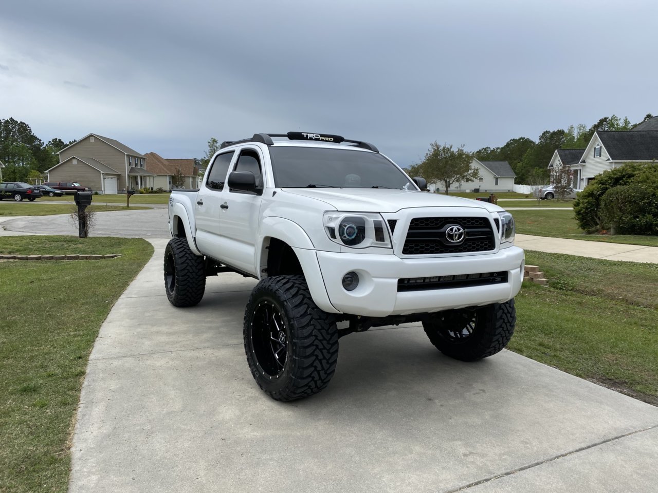

    New SPC UCAs, Icons all around, and Alcan springs. Around 2" higher in the rear, but should be perfect when loaded up with all the camping crap, kayaks, and squaredrop camper.
    124402161_10224243958985735_2394015032252314830_n.jpg 125264507_10224243959665752_5538267621738124537_n.jpg

    How's the ride with the Alcan's in the rear?

    The ride is definitely stiffer, but not too bad. Just finished loading up for a camping trip and it dropped about an inch, but the stock springs would have been flat. The back end is noticeably higher without the trailer, but it levels out nicely with a load. I'm really happy with the whole setup.

    I had them do 600 lbs over stock. I have about 250 lbs with the racks, full size spare, tonneau cover, and trailer spare all the time. The trailer has about 120 lbs tongue weight. Initially I was only thinking 300-400 lbs, but after talking with Bob at Alcan about the potential of being fully loaded with kayaks, generator, portable a/c-heater, gas, water, 12' canopy, and whatever else I can shove in the bed, he suggested 600 lbs. It rides great loaded up. The amount of sag on the stock springs with all this crap was crazy. The trailer was almost level (slight incline towards the truck) when hooked up before. With the new springs I had to buy a drop hitch and lower it 6" to get the trailer level.
