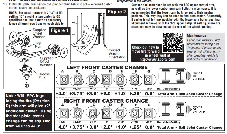

    Looking to get some better alignment specs on my truck and increase caster and decided to order some SPC UCAs from headstrong today to hopefully install next week. Any setup tips for 6" DB guys as to what caster position and such to set the UCAs to??? I plan on contacting my alignment guy to make sure he knows about SPCs, but I wanna get it close as possible when I install and at least point them in the right direction. Most of the info I have read pertains to the 2.5" to 3" guys with different angles than DB trucks. I am at like technically 6.5" front lift with my setup over stock measurement with the RCD 5100s and 620 coils with Toytec top plates. I was not sure if I should set the caster in the neutral position on install? My UCAs and CVs obviously are sitting much flatter than the 3" guys.

    Only thing is I believe the JBA are fixed position to compensate for the caster where the SPCs are adjustable... but I appreciate any info I can get! UCAs arrived today!

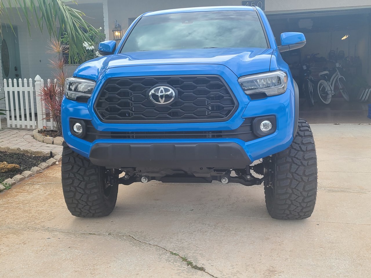

    Not the best pics but here it is, I'll post more pics later...

    fyi - if you want your truck to sit level do not order a 6” leaf pack. The truck has a 2” rake stock, so to achieve a level stance you only need 4” in the back this is why the 6” lift kits only use a 4” block in the rear.
