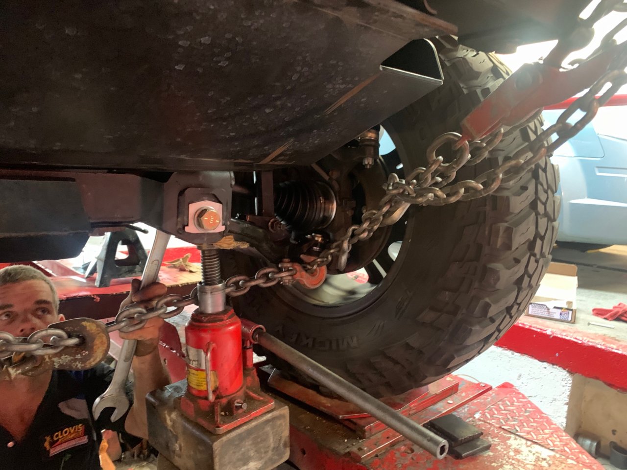

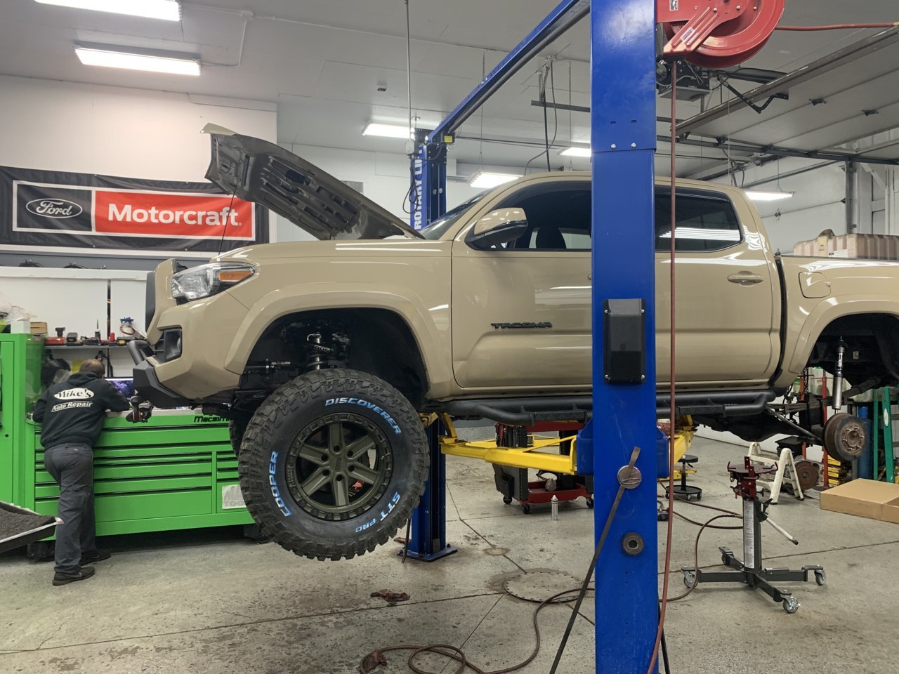

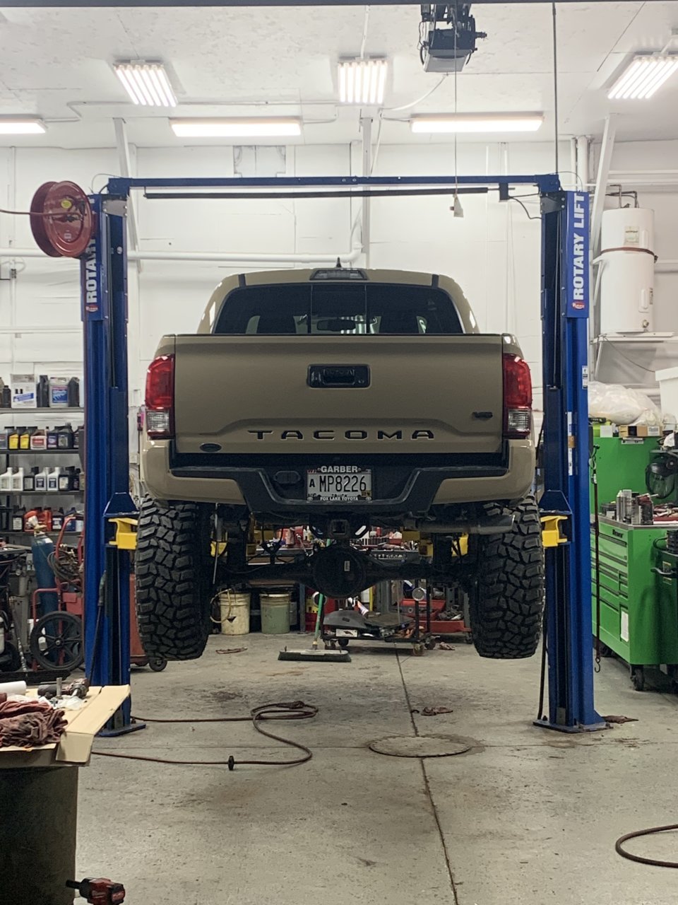

    Started installing my 6” BDS lift finally. 3 out of 4 lower control arm ascentric bolts were siezed. Now to wait until parts come in with no truck to drive…:(:(:(

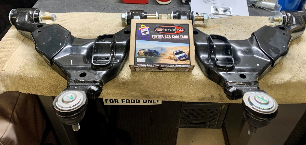

    Highly recommend going to the “taco tabs”, I was constantly having to realign my truck, did the taco tabs when I re did my steering rack did a weekend in Colorado doing the mountain passes (imogene, black bear, engineer ) drove 1300 miles round trip and alignment is still spot on.

    Yeah a 17 in Wisconsin with winter and salt galore. Everything else came apart quite easily. I’m assuming that Toyota could use more grease or antisieze when assembling

    Installed a new steering rack, new LCA with White Poly bushings, and Taco tabs. dialed in the alignment with the ICON billet UCA's.
    End result has been fantastic. BDS lift components are solid and didn't require any "reinforcement" to the tab area. completed multiple Colorado Passes (Imogene, Black Bear, and Engineer) two weeks ago along with 1300 mile drive round trip from New Mexico. Alignment is still spot on, from when we did it. if anything would have knocked it out it would have been the technical section prior to the "steps" on Black Bear Pass.

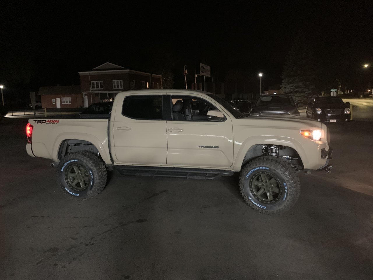

    All done finally! For now anyways lol. Was a long wait for me since ordering the lift in early May. Truck drives great and looks great. Currently contemplating doing the speedo recalibration and ordering a set of Alcan springs for the rear.
