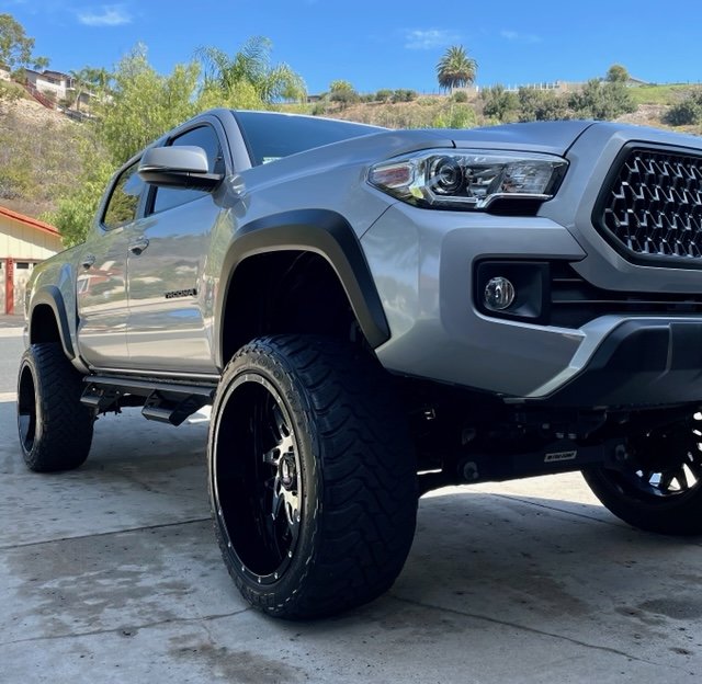

    I finally get to post in this thread, after lurking for a while. I recently picked up a 19 TRD OR 4x4 DCSB. It already had a Pro Comp lift, and 22x12 wheels with 33x12.5 Toyo Open Country MT.
    It looks to have the the factory front Coil and Shock with a large spacer, and pro Comp shocks + spacer in the rear. At some point I will upgrade all this.
    I also do not like the wheels on there, and am trying to decide if I should get new wheels in the same size, or potentially 20x12. I will likely stick with 33x12.5 tires, as I do not want to deal with regearing for 35's.

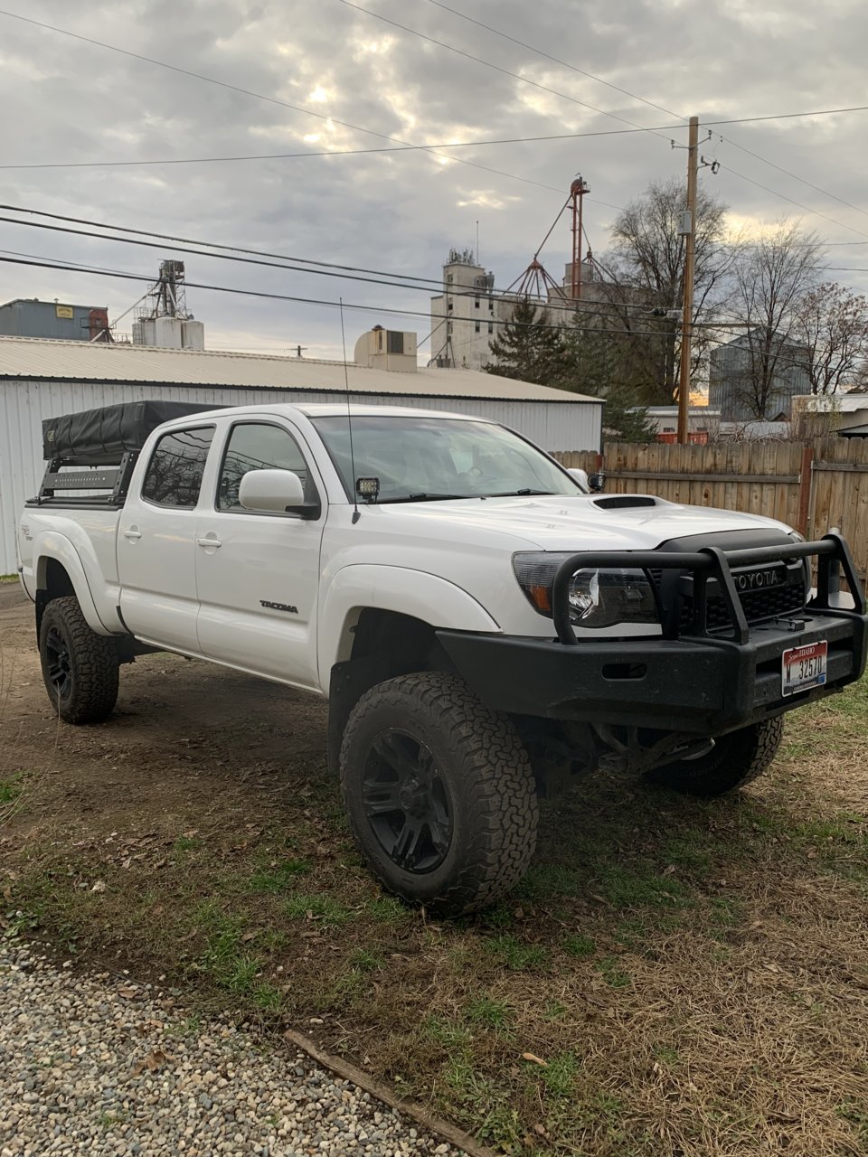

    Been hearing I can only go with a 18inch wheel on the fabtech 6inch lift due to the tie rods. Is this true or can certain 17inch wheels work? TIA!

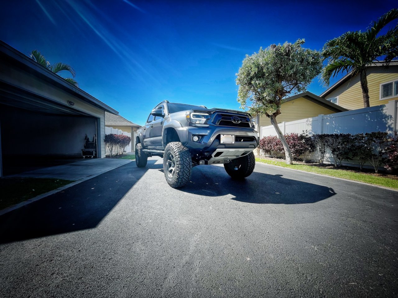

    2013 PreRunner
    Pro Comp 6” lift
    35s on 18” wheels (no struggles going up hills with load THANKS to HPtune )
    - no gearing changes at the moment.

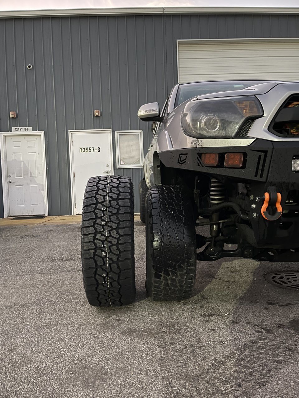

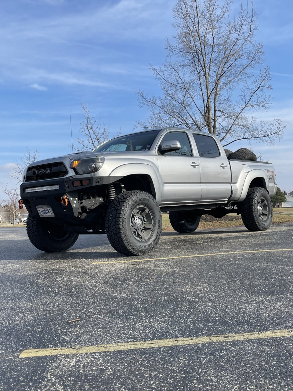

    15 Silver DCLB
    Alright here we go!! Fresh 315 70 r17 Falken Wildpeak AT3W!!! 6” zone RCD Bilstein 5100, 620 coils, 1/2” toytec top plate spacer, SPC UCAs :thumbsup: could not be happier with where my alignment is at finally!! It’s crazy I’ve been on a 6 inch now for over 35,000 miles!
