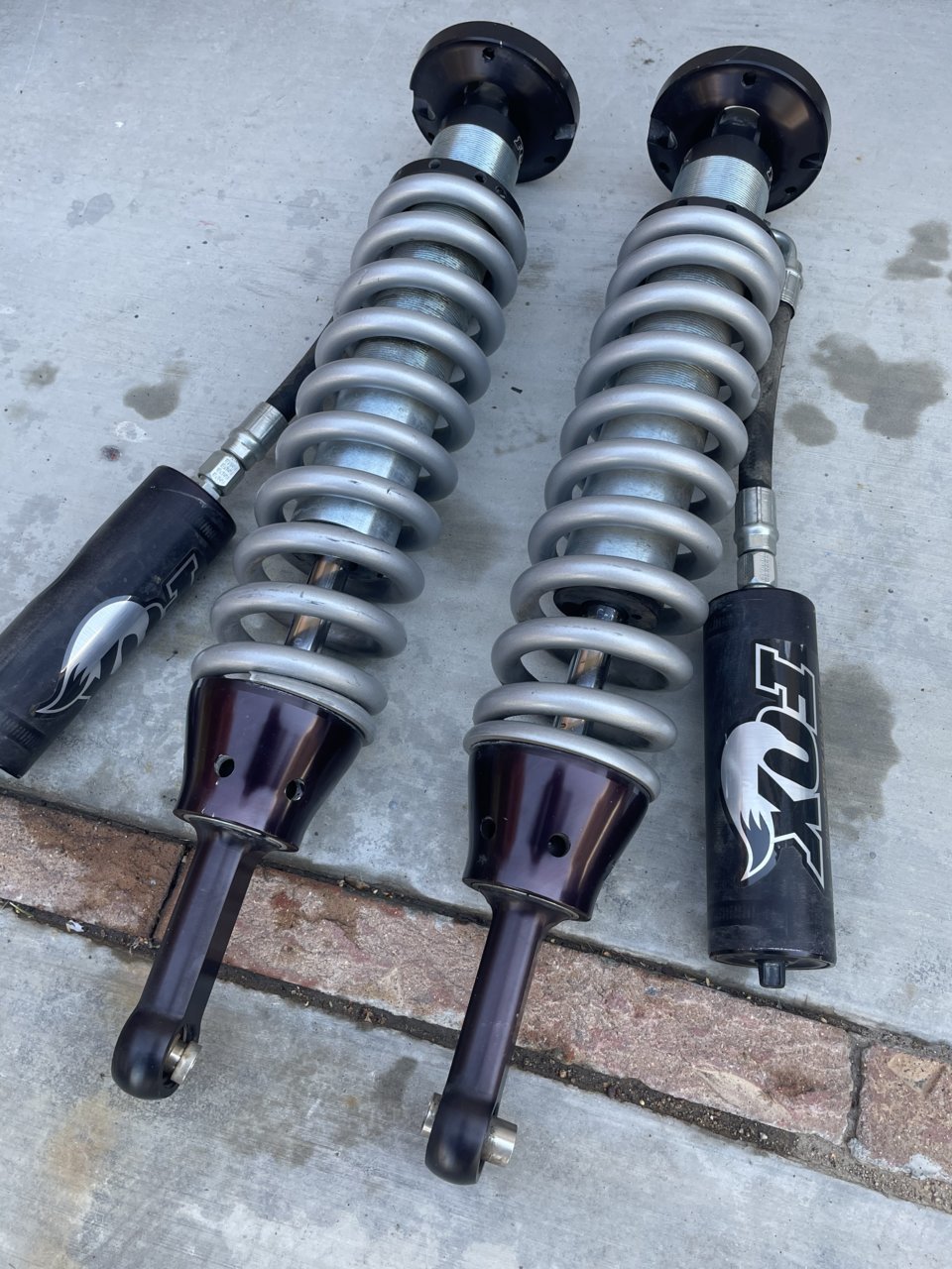

    The best person to speak to in regards to this is John Arriola from Accutune (johna@accutuneoffroad.com) he spec'd out my new shocks for my current weight scenario for my BDS 6" lift currently w/Deaver leaf packs and moving soon to Alcan custom leaf packs built for the new weight.
    FOX-883-06-048
    Kit: 05-ON Toyota Tacoma 4wd & 2wd Prerunner Front Coilover, 2.5 Series, R/R, 5.8", 4-6" Lift, DSC
    2 ERS-1600.300.0700S
    Eibach Spring, 16" Long, 3.0" ID, 700 Lb/In, Silver 0
    2 FOX-883-26-023
    Kit: 94-ON Dodge 2500/3500 4wd Front, 2.5 Series, R/R, 10.2", 2.5-3.5" Lift, DSC 0
    2 Labor - Rod End Swap
    Remove & Reinstall New Rod End
    2 Labor - Reservoir Fitting Insta
    Install or Change Reservoir Hose Fitting(s) (Shock Already Opened)
    2 Labor - Bushing & Sleeve Swap
    Remove Old Bushing & Sleeve, Install New Bushing & Sleeve
    2 FOX-213-27-001-B
    Sleeve: 5/8" OD, 1/2" ID x 1.375" TLG
    2 FOX-014-11-003-A
    BUSHING: EYELET, HOURGLASS DIA. 0.625 ID X 1.300 TLG POLYURETHANE, 85A
    2 FOX-213-01-327
    Eyelet Parts: Eyelet, Shaft [Ø 0.875 Shaft, EB1 Bushing, .950 W x 1.350 LG] Non C/O, Al 6061, Bl...
    2 FOX-020-50-049-A
    Fitting: 90°, -8 MJIC x 3/4-16" MORB
    1 Labor - AccuTune ReValve - New
    AccuTune Revalve For New Shocks Purchased From AccuTune. $100 Value Tune: Adventure, Dual Sport...

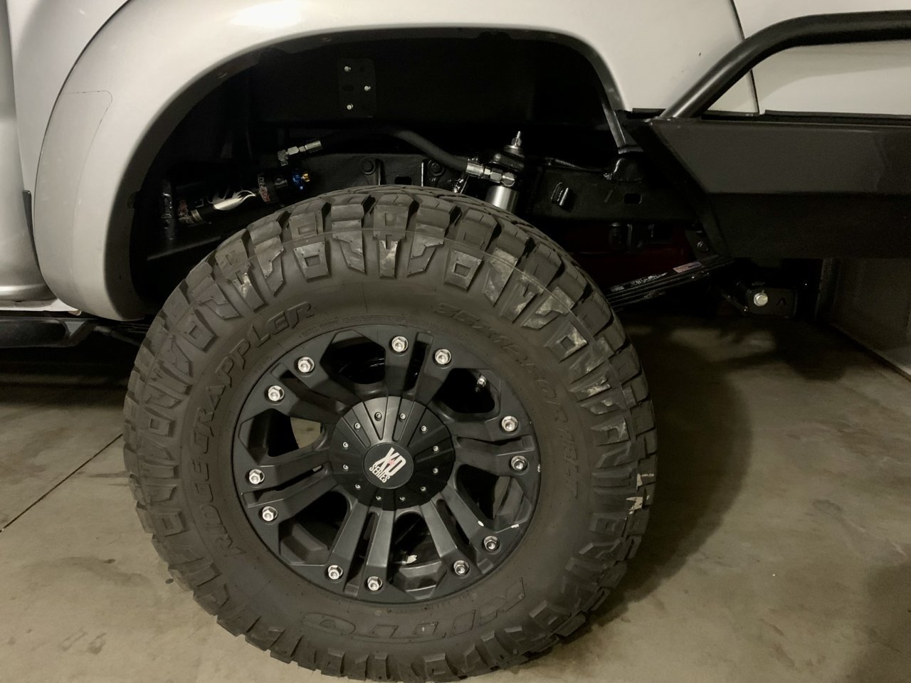

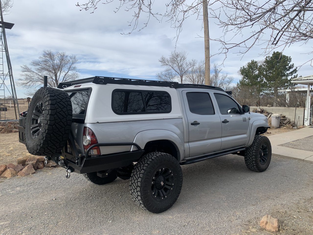

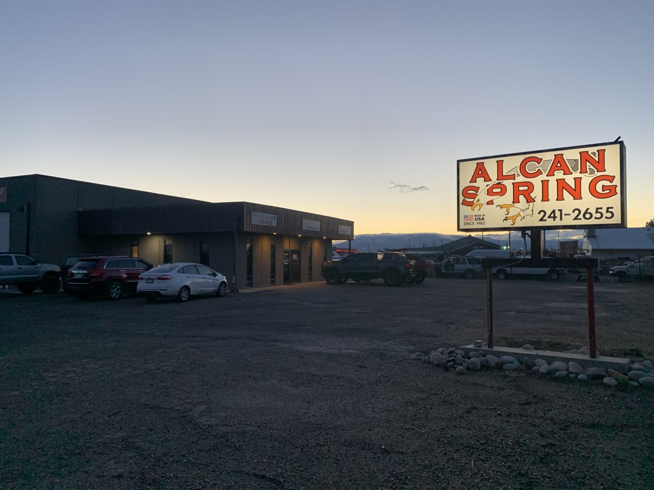

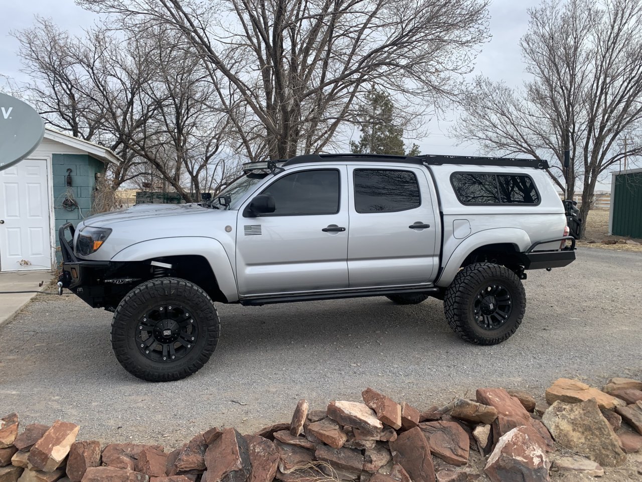

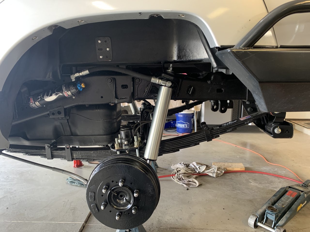

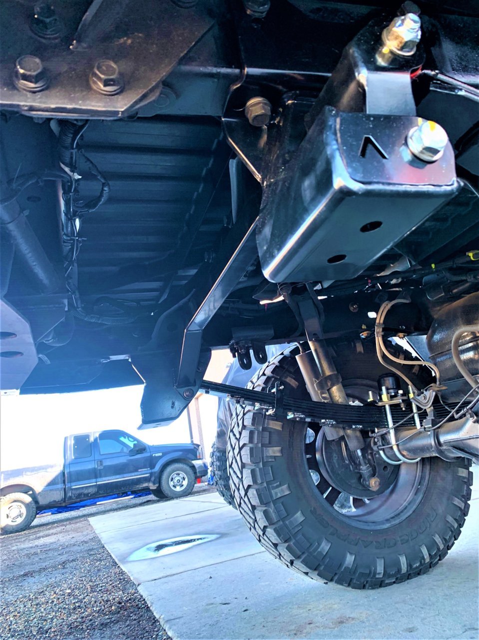

    As promised -
    Just completed a 1200 mile round trip Sunday - Monday (yesterday) from New Mexico to Grand Junction Colorado to have AlCAN Springs complete the install of the custom 5" 1000lb over custom leaf spring packs I had built. They also installed the Archive Garage Hammer Hangers, HC Crossbar, and ubolt stage 4 flip kit I purchased from Eric (Archive Garage).
    Lew Weldon (Owner) and Tyler (Technical/Mechanical Wizard) including the whole team were nothing but ultra professional and spot on as far as quality of build, delivery of service & hospitality. The shop is ultra clean and professional, the onsite team is a precision well oiled machine, outstanding communication from start to finish. Couldn't be happier with the final result, the rear of the truck is now extremely stable, no sway, completely planted (saying a lot for a dcsb that's 920lbs over stock weight in the rear (static). Driving back through the Colorado twisty' s (Monarch pass, Gunnison, Salida, etc.) the trucks behavior was more like my former z06 corvette or 370's i have owned, very "Planted".
    So looking forward to getting my FOX 2.5 w/DSC Accutune valved and tuned rear shocks and front FOX 2.5 w/DSC 700lb Eibach coil overs installed next month. The rear now sits 43" from ground to wheel well center opening, the front is 42" (will adjust the preload on the new coil overs to bring the front level (43") at install)
    Cannot recommend enough Archive Garage and ALCAN Springs.

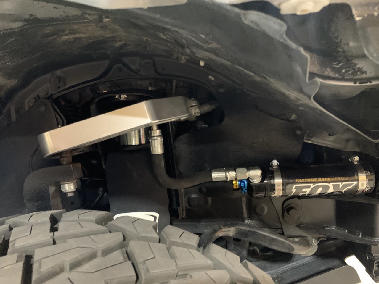

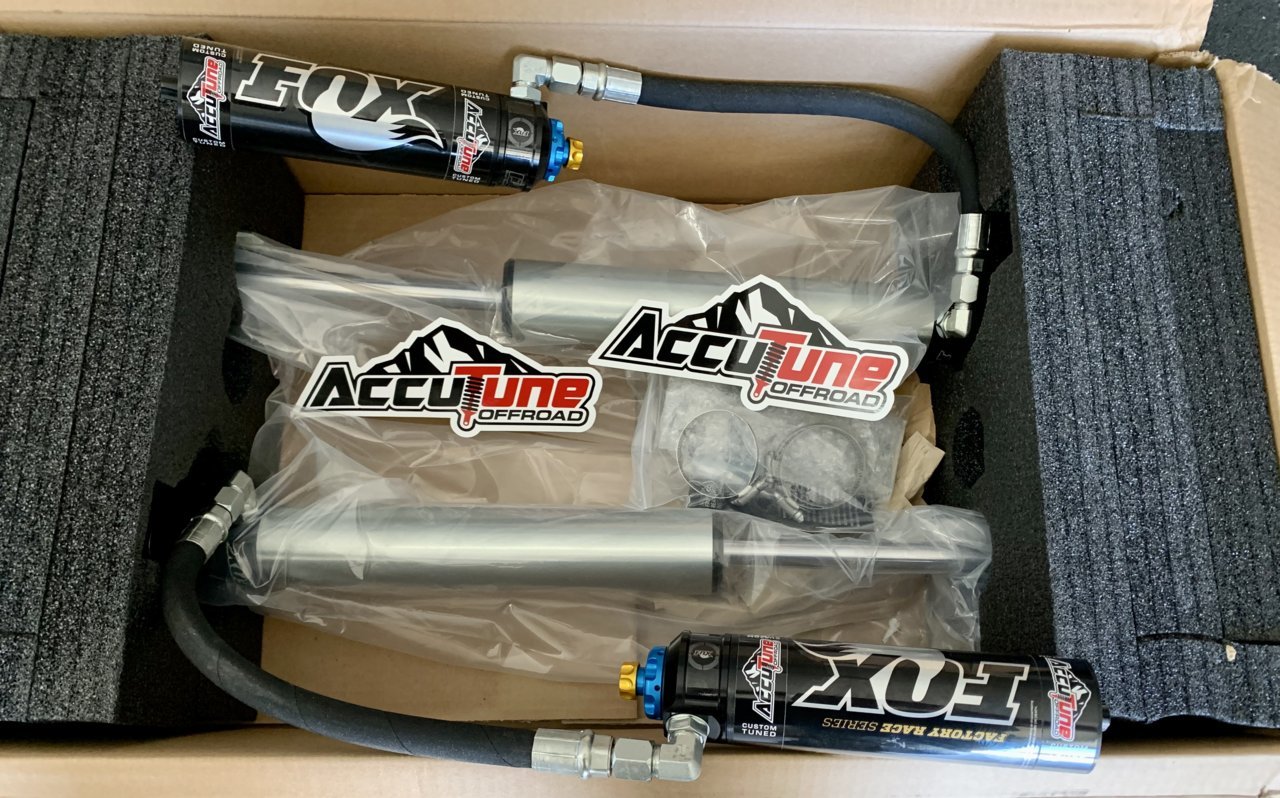

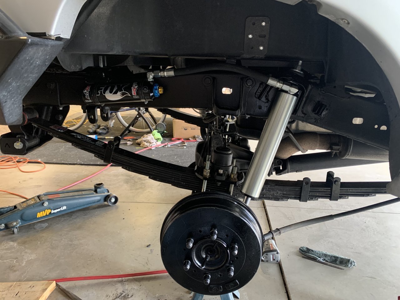

    As she sits right now - Just notified that Accutune received my rear shocks from FOX and are building, valving, and tuning. looking forward to installing the new FOX 2.5 Race Series coil overs w/DSC and rear FOX 2.5 Race Series Smoothies w/DSC.

    current ride is great, new accutune revalved and tuned fox 2.5 coilovers w/DSC going on soon and rear accutune revalved and tuned fox 2.5 w/DSC arriving FedEx today and will be installed tomorrow.
    will follow up with my thoughts on the ride difference between the off the shelf stock fox and revalved and tuned w/DSC

    FedEx just dropped off my rear accutune custom shocks!!!! :bananadance:
    Tomorrow is install day for the rear.

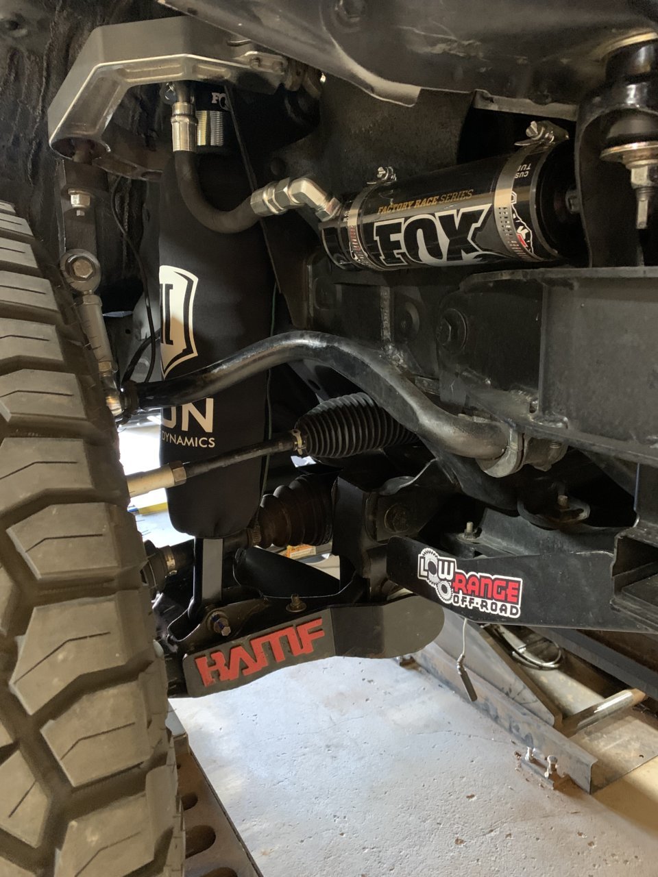

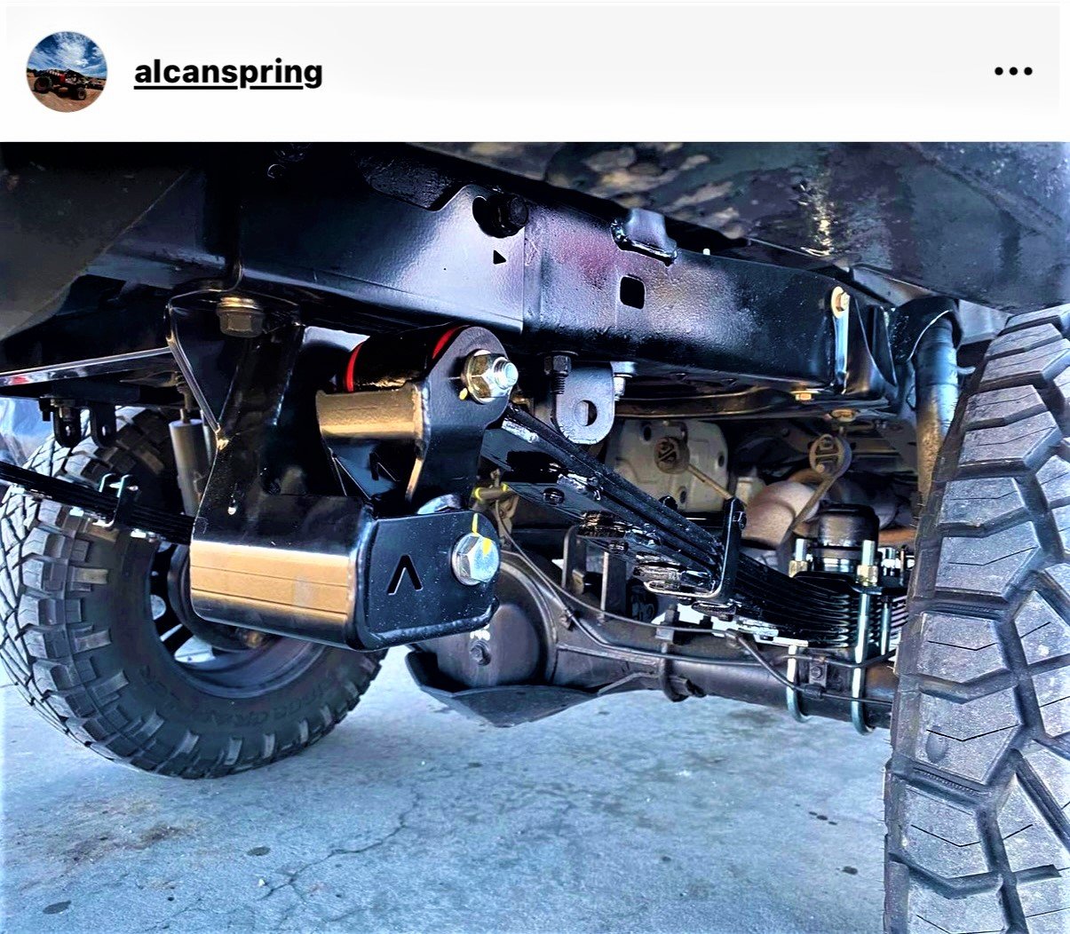

    Install complete - now to drive, enjoy, and dial in the DSC

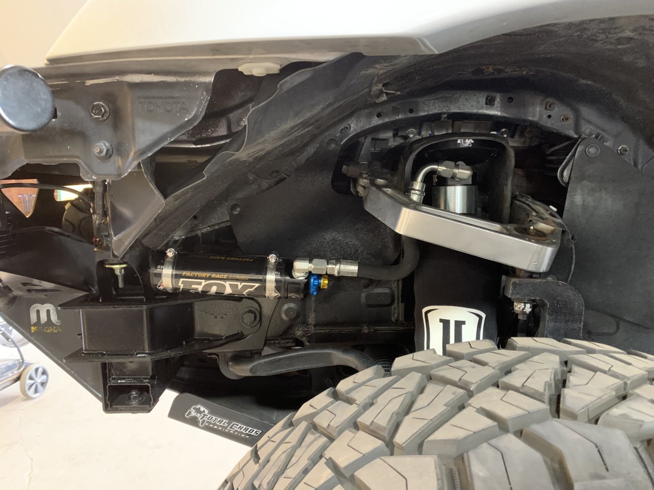

    Spent the day at 806 desert customs Off-road in Lubbock Texas. Outstanding team, installed and dialed in my Accutune built, valved, and custom tuned Fox 2.5 Coilovers w/DSC and eibach 700lb coils.
    this completes my suspension overhaul - the truck has never handled better.
    I cannot recommend enough Accutune, Alcan Springs, Archive Garage, ES suspension products to name a few.

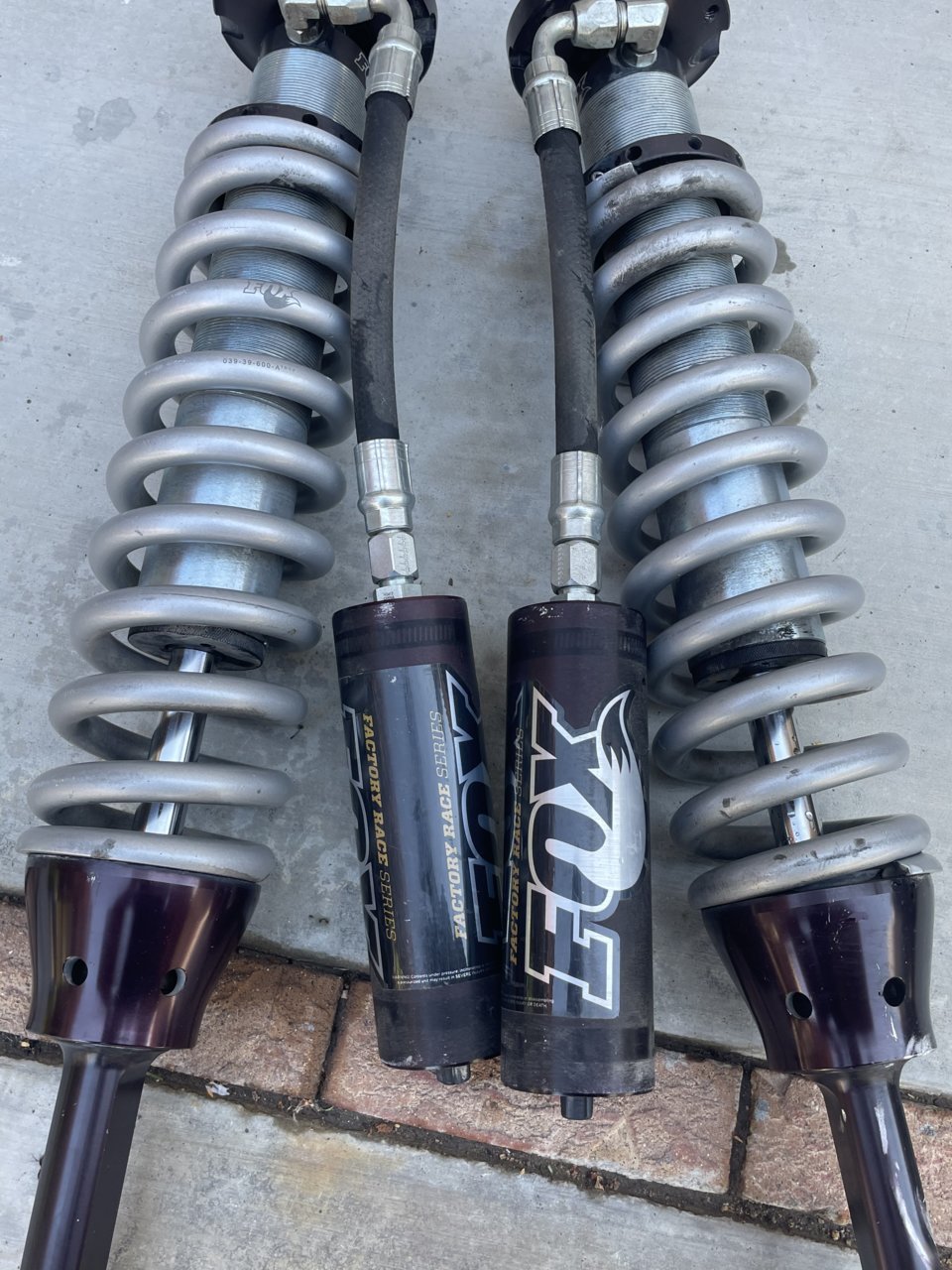

    selling these used fox 2.5 for 4”-6” lift. I posted it in the marketplace but I know with our lifts it’s a little more niche. Hope this is okay to post here
