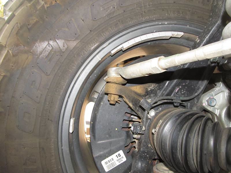

    Can you post a pic of your tie rod to wheel clearance (like this)? Curious just how close it is with BDS & 17s.

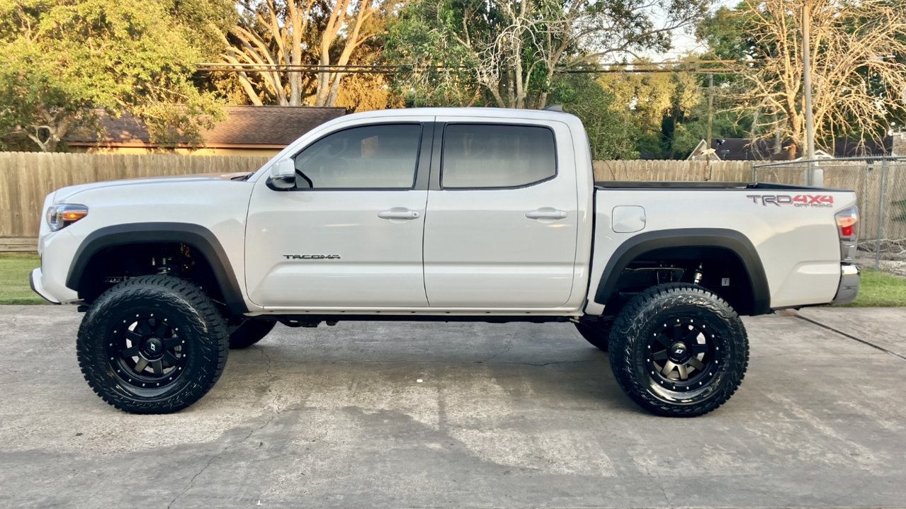

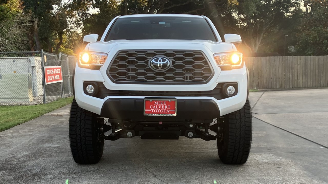

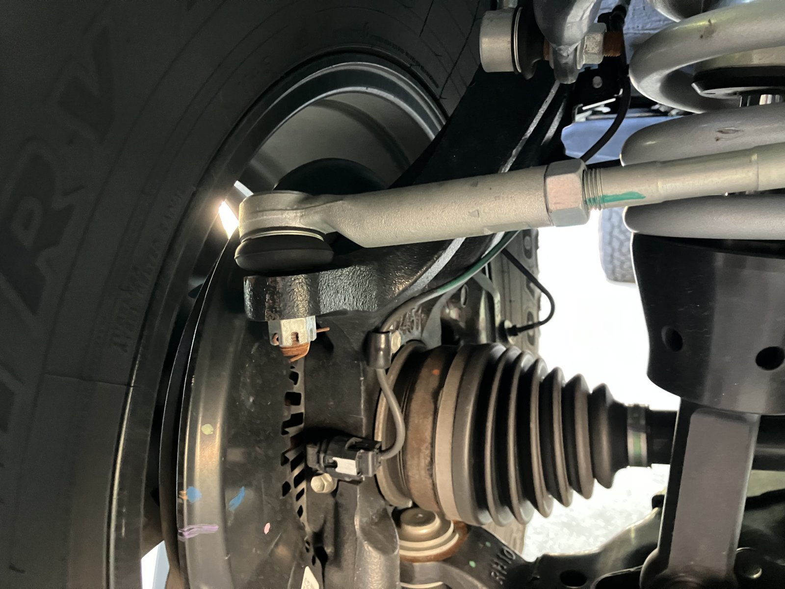

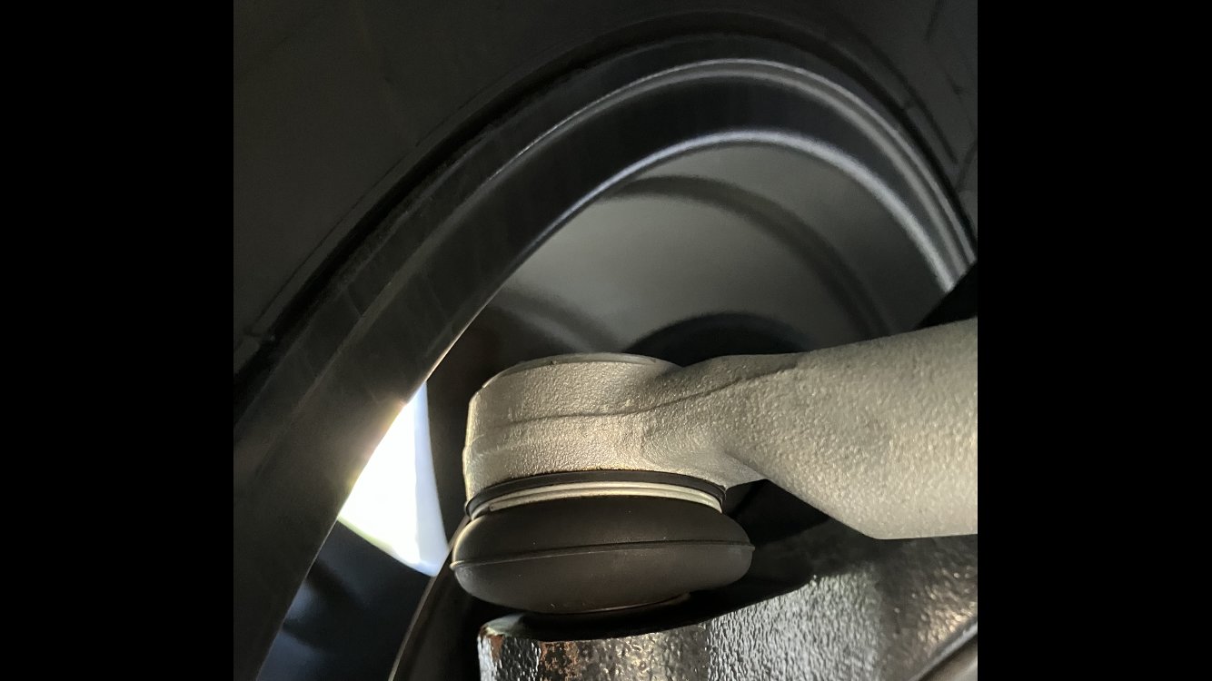

    17 inch wheels (17x8.5 -10mm) fits the BDS lift with a 3/4” wheel spacer up front, have about 1/2” of clearance between the tie rod and rim lip.

    Thanks! Looks right about what I was hoping for. Truck looks good. :cool:

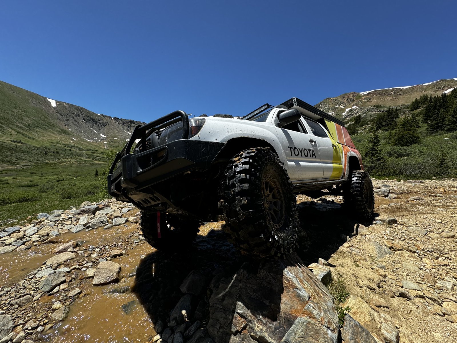

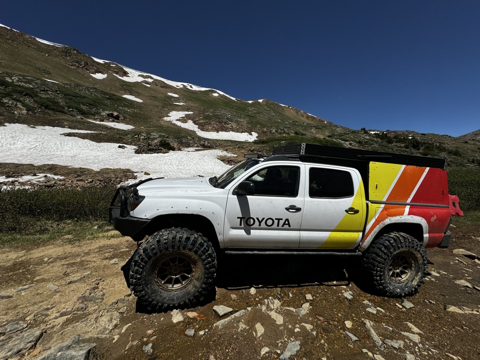

    I'm slowly making my way there (minus the baja fenders).
    This was last year. New tires should be here this week.

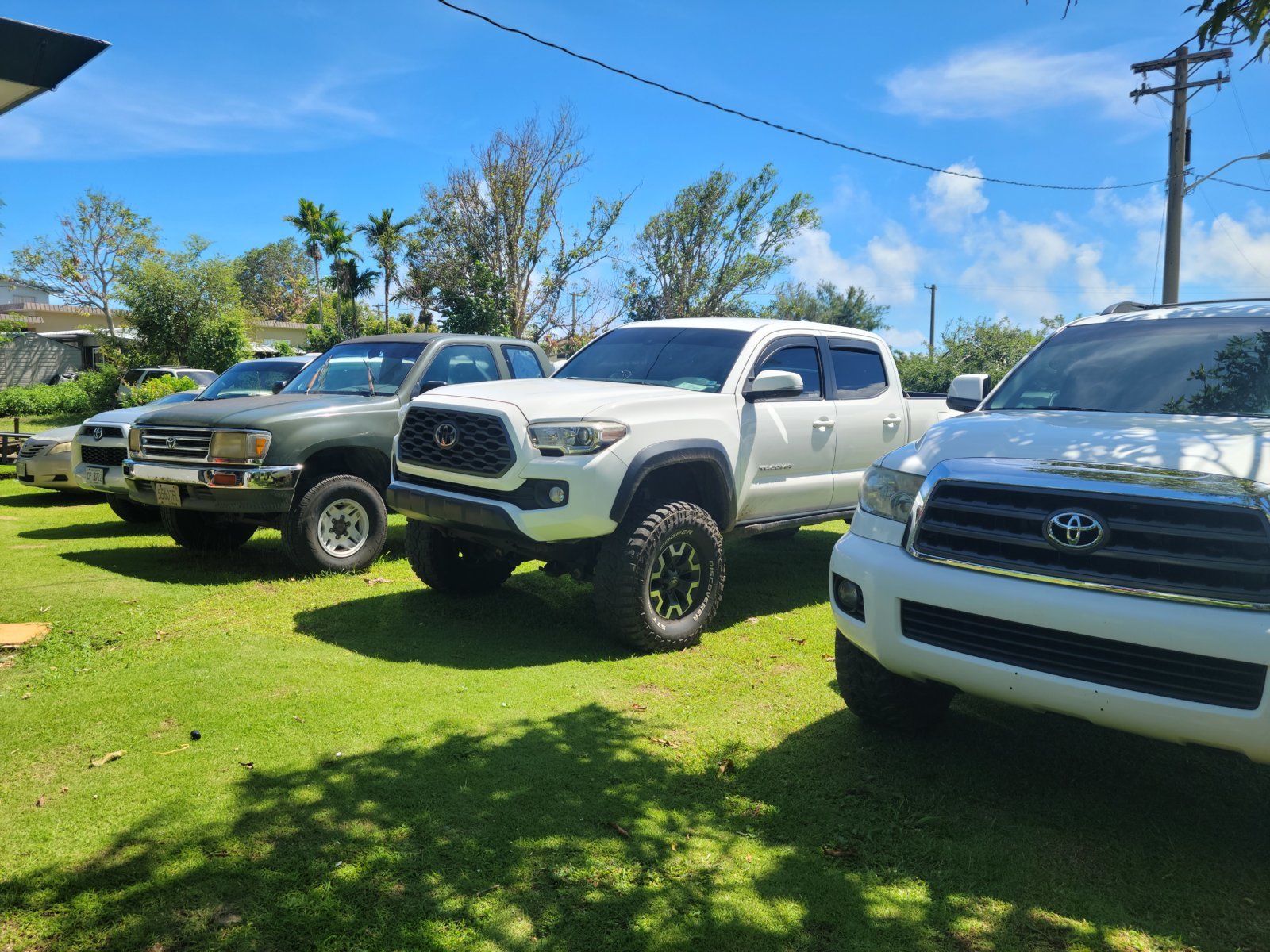

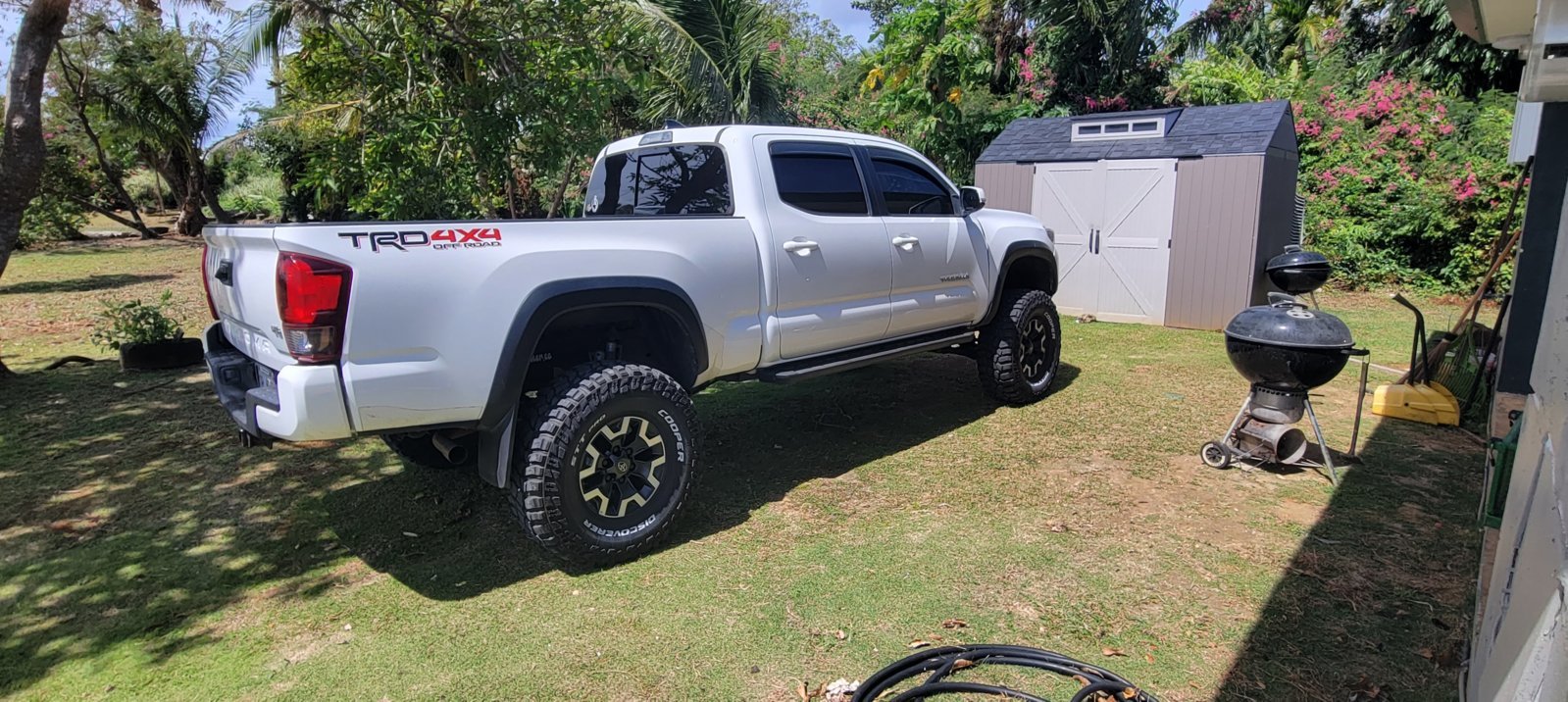

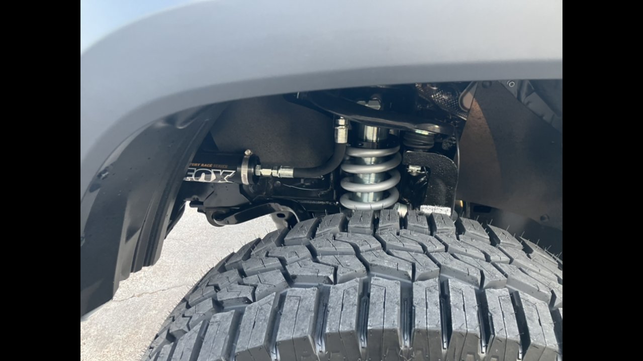

    Been reading through this thread for the past week and saw some good info so joined up. I have a 2018 OR been running Zone 6 inch kit without the spring isolator, with the top spacer on OME 887s and 5100s up front with SPC uppers and 26" extended length 5160s in the rear since 2019. I'm looking to upgrade to the RCD 5100s and OME 888s for a little more lift however for the guys that had that setup and went with coilovers such as Fox 2.5s how was the ride quality with the switch? I have been running 5100s for years on all my toyotas and love the ride but would like something a little smoother for my 3rd gen.
    Pic of how it currently sits.

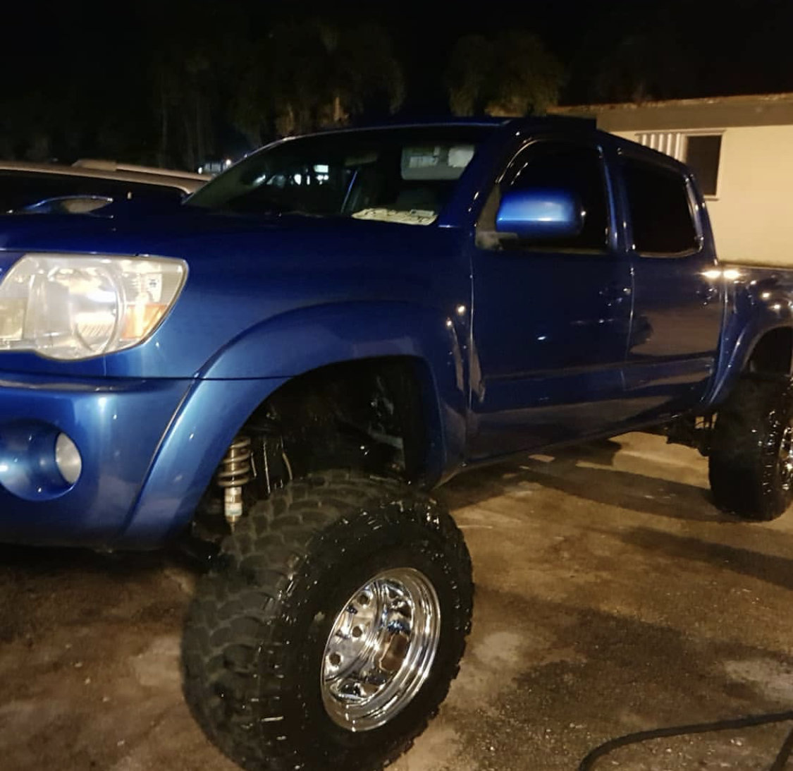

    Threw in a pic of my old 2nd gen

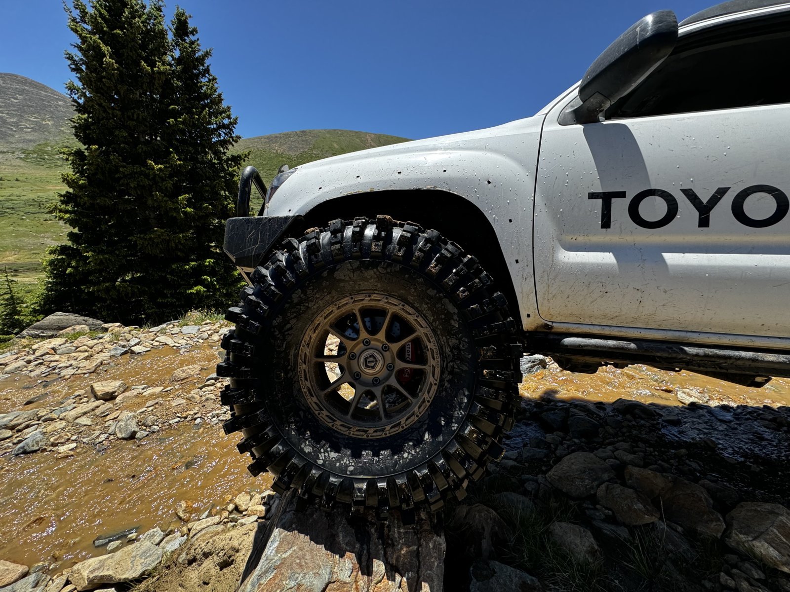

    Still need to trim the front fender a bit more.
