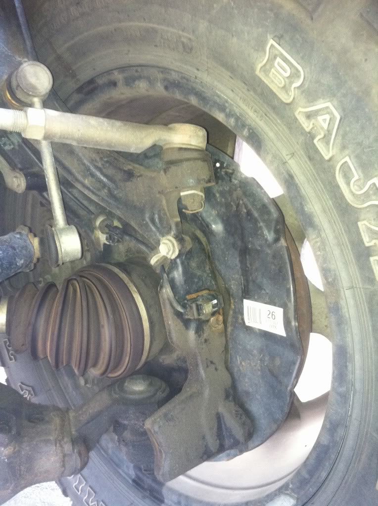

    You are correct, unless you use wheel spacers to push the wheel out far enough. The reason is the larger spindle and tie-rod and sway bar connections.
    Since this question has come up a lot, I will try to take a pic of my 17" wheels to show the spacing that is left. Its not much.

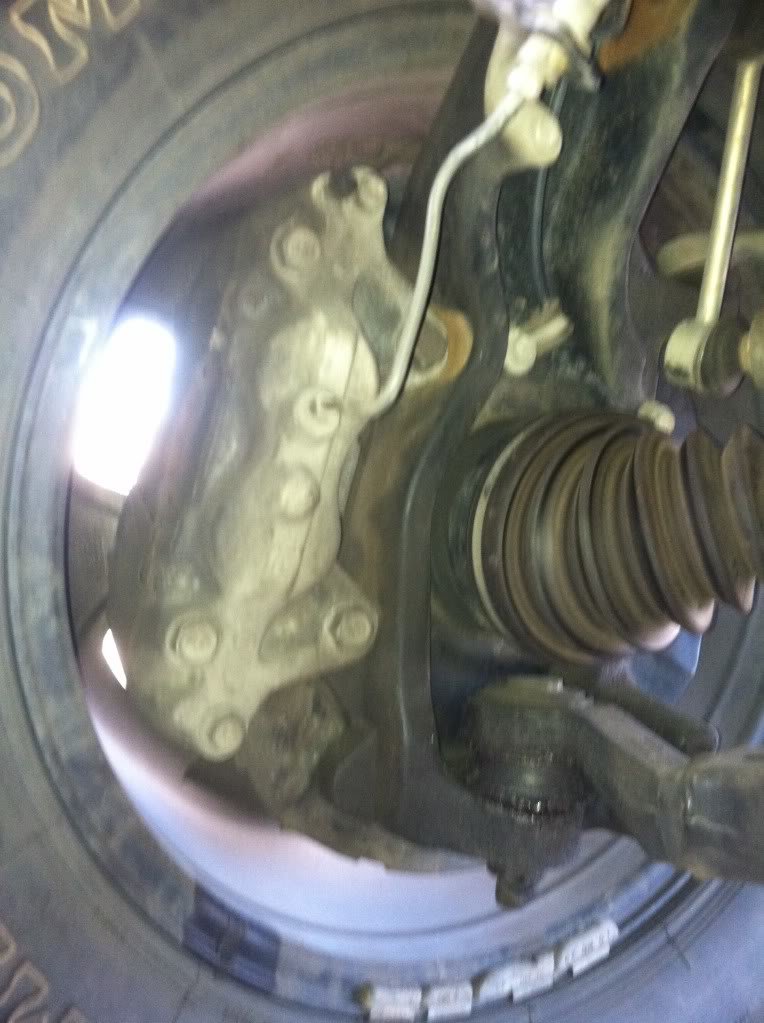

    Ok here are pictures showing the backside of my 17" wheel. There is about 1/2" clearance from the tie-rod.
    Looks like I need to clean under there.
