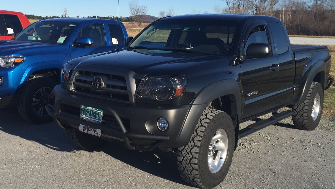

    If you need another option i highly recommend these...
    OEM smoked headlights... (came on the 09-2011 Sport but will fit the 2005-2011 Sport and Offroad. Got them online from Boch Toyota South... OEM part# 81150-04173 / 81110-14173.

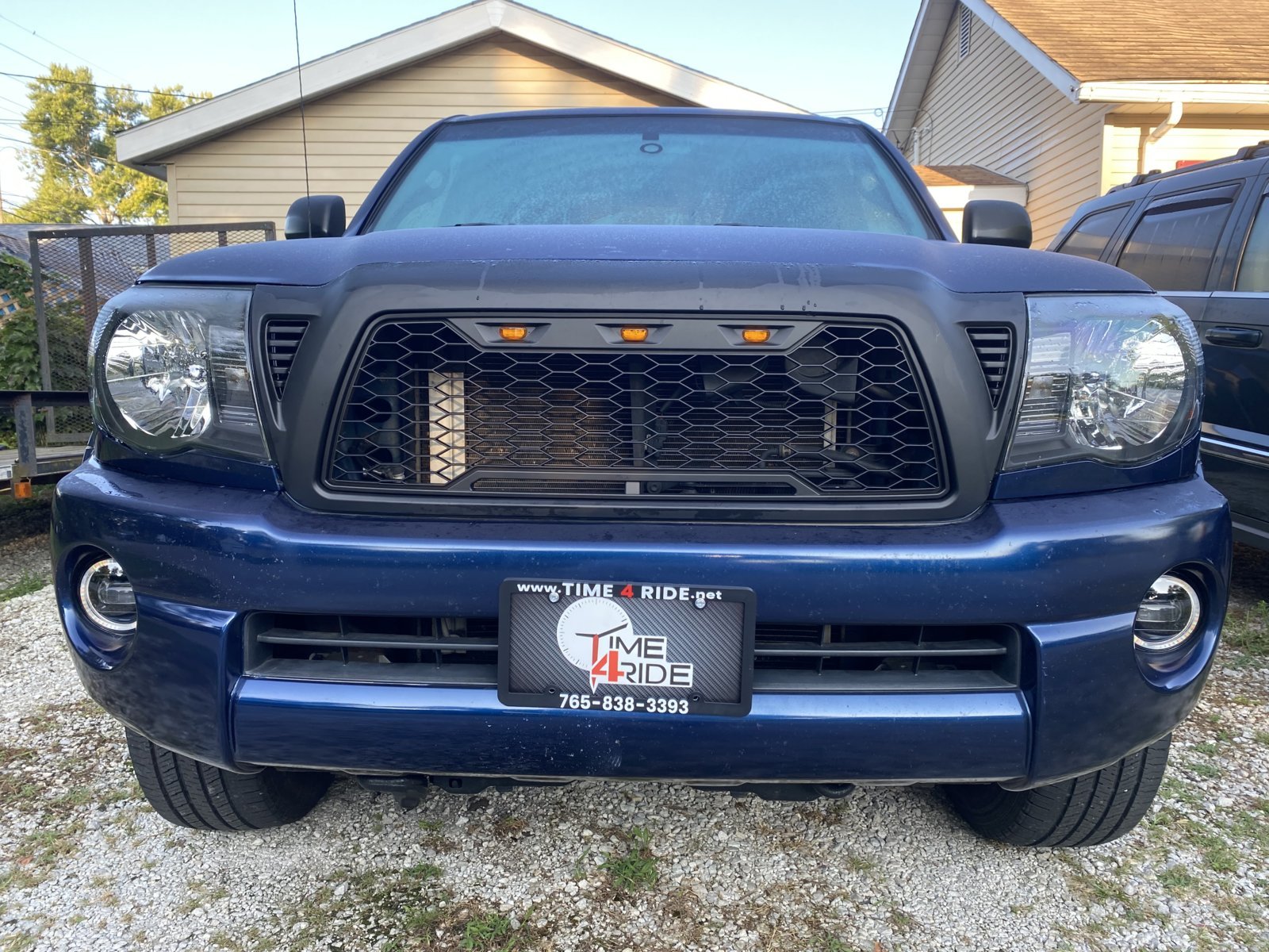

    Price of oem compared to aftermarket your choice!
    Oem is definitely good quality stuff but expensive.
    If I did anything aftermarket I’d for sure use some flowable silicone to seal them up.
    I’d also pass on the raptor lights and put some lights behind the grill or something.

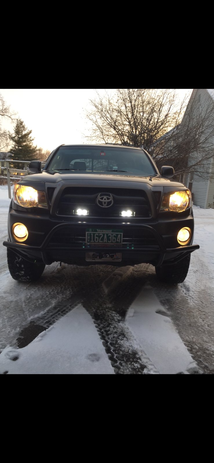

    I did the light thing and extra lights etc!
    Wish I’d just did the smoked oem sport lights I believe.
    Tried like 3 different sets of aftermarket and had moisture issues.
    Wish I’d used flowable silicone then but live and learn!
    Pretty cool your 08 is still going!

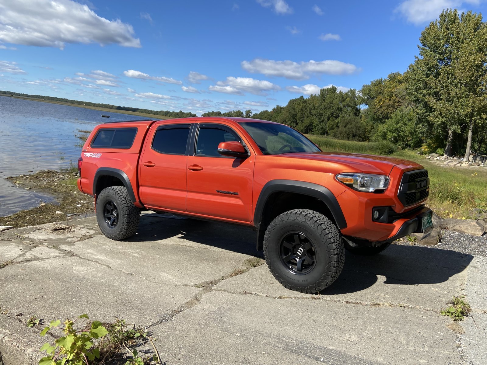

    My 08 was totaled bought a 12 TXpro.
    More rust than I could take!
    This 2018 is my ride now.

    @Jeffch That's a beautiful machine, Jeff. You must be proud of it. :thumbsup:

    Yea I like it but liked how the others looked also. My 08 was clean new frame suspension etc. IMG_5173.png200k miles I shed some tears when the kid ran a light and boned me.

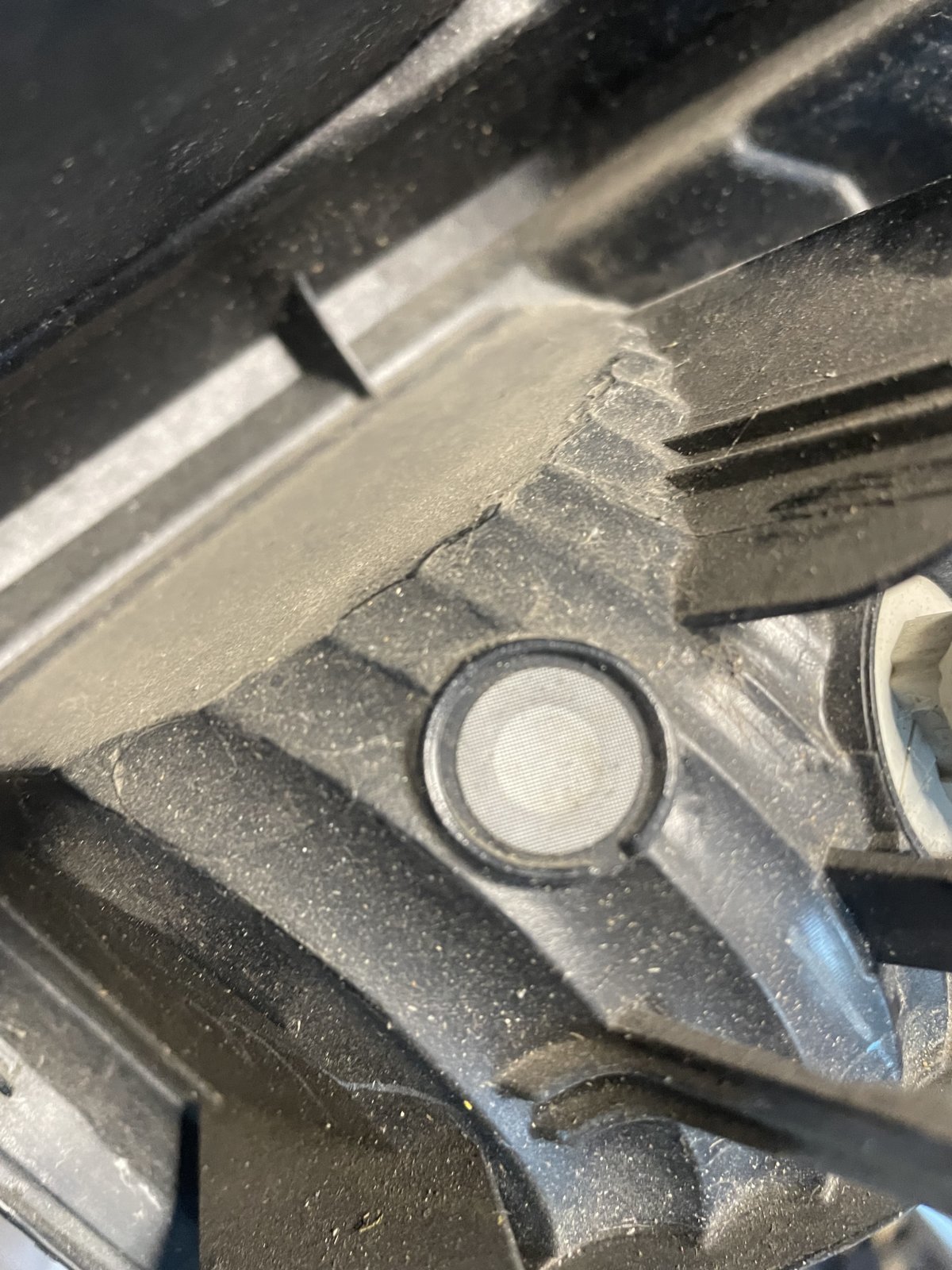

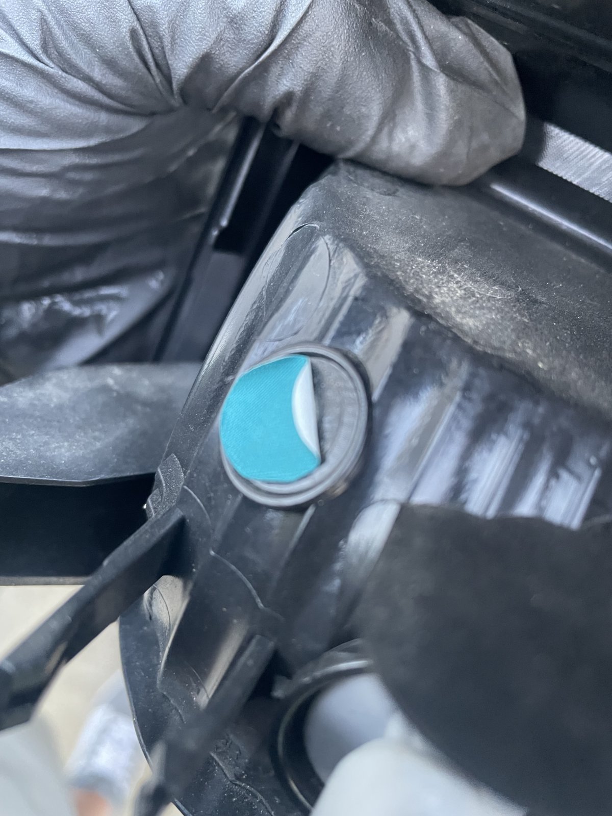

    Good news. I ordered a different brand and installed: Nilight Headlight Assembly for... https://www.amazon.com/dp/B0BTNGMC1T?ref=ppx_pop_mob_ap_share
    And we passed test 1, a very humid night:
    I forgot to seal them with silicone until I had them in the holes. I decided to run them as built. These look identical to the first set, except for tooling marks all over the back half, the bucket. Also noted blue paint pen marks beside every bulb hole and seam, maybe QA’d. Fingers and toes crossed. Next set will be OEM if these leak.
